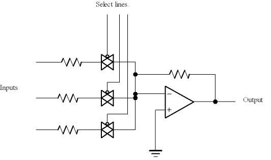

Per-Anders, I'm not exactly sure what you mean by putting the mux into the neg feedback and make the connections right. Do you you know any schematic online that shows how?
Fredrik
This sort of thing I guess.
:up: That's it.
It's easier if you use one IC for each channel, in other words, don't mix the channels i nthe same IC.
You can also search after analog switches as input selectors. There are many other types and you can get insiration from datasheets and application notes. CMOS4xxx swicthes är "basic", not particulary hifi or made for it, but for general digital and analog applications so you won't have any special soft switch on, break before make etc. Some of those features you'll have to fix yourself. The price is unbeatable though.
