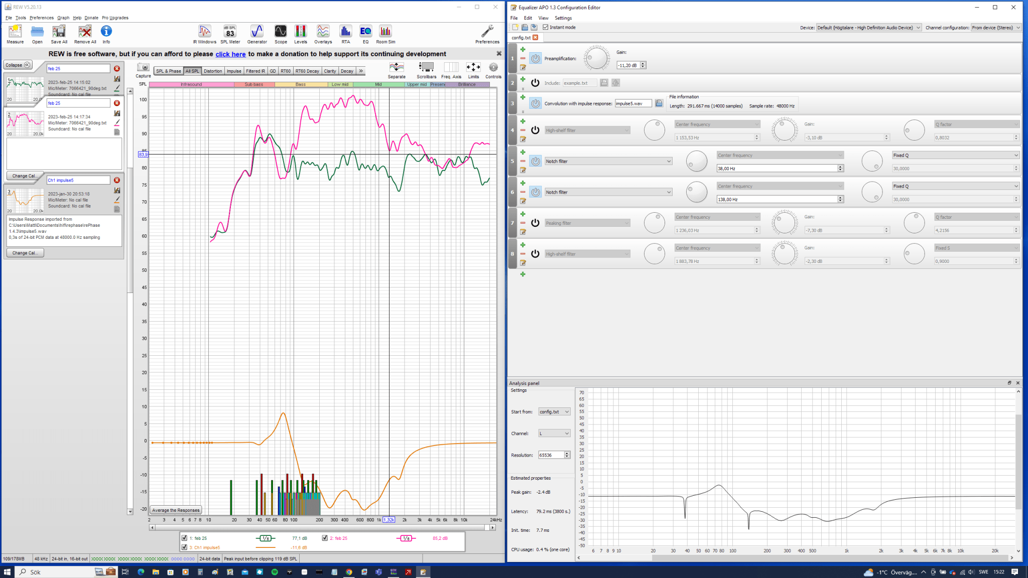

I use a pair of speakers from Audio pro Stereo one Limited. The audio pro amp broke and I got a NAD D3020 v2.
Found that it sounded thin in the bass register. I use amplifier and speakers together with computer at my desk and now use equalizer APO 1.3 (free) to compensate the thin sound. I have used REW room acoustics software(free) + UMIK1($79) and rephase(free) to make a wav file (linear phase) which I run in APO 1.3 to compensate for this. I have not tried to change the construction of the speaker, however this way seems to be enough for me. There are many youtube clips that describe the work process.
My simple measurement in my room shows that the speakers reproduce approximately 20db higher from 110hz to 1300hz compared to the other frequencies. There are also apps for phones to create a wav file that can be saved and for example used with APO 1.3, the phone's microphone does not have a calibration file (like UMIK1) but I have heard that the result is usually good anyway. This may not help you who chose to modify your speaker. I thought I'd share this because I think these speakers sound really good with the measures I described. In addition, the job of learning to use the software is fun and you can tailor the sound to your own taste.

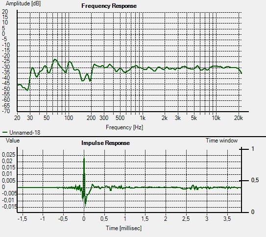

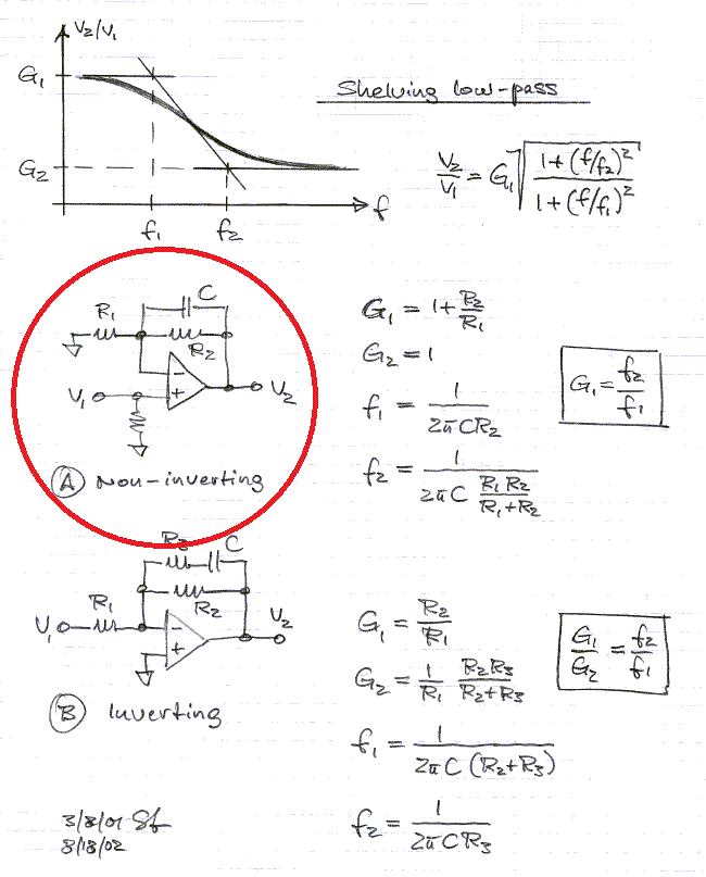

Well, this thing became a kind of obsession for me, so -after measuring both drivers without xo- finally I redesigned and rebuilt the crossover. Also to compensate for the low end loss in the response I've built a simple shelving low-pass filter - as on the picture- inserted in front of the power amp. The result is not bad both measurement and listening-wise.... (measured with HolmImpulse from 1m on tweeter axis with 1/6 octave resolution). The suckout at 140-200 Hz is due to floor reflection-cancellation.
