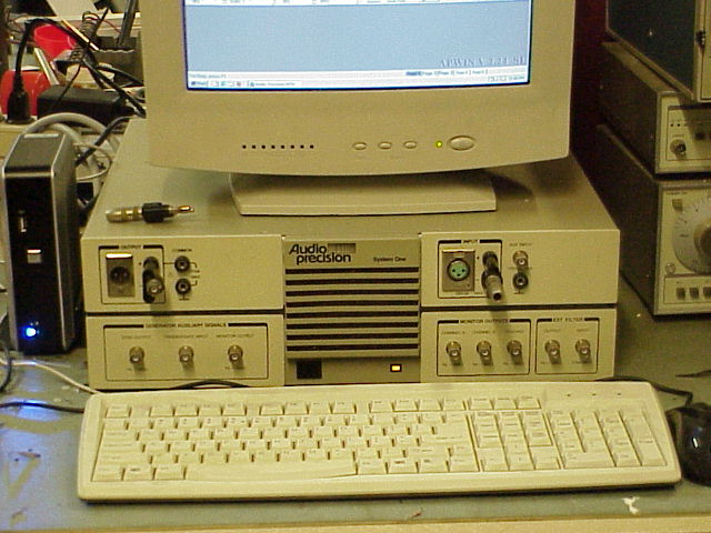

I got an old Audio Precision System One off ebay. Probably the lowest model, it only has one analog channel, a serial port, and the AP bus. I found out only the oldest version of software (that runs under DOS) supported the serial port. The last release of software that can be used runs under Windows 98. There are some former AP employees selling little lunchbox computers on ebay with a driver that will allows the printer port to be hooked to the AP bus with a special cable. So now I can talk to the box and it seems to work. Figuring out the software without any documentation is a pain but, I'm slowly getting up to speed.

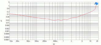

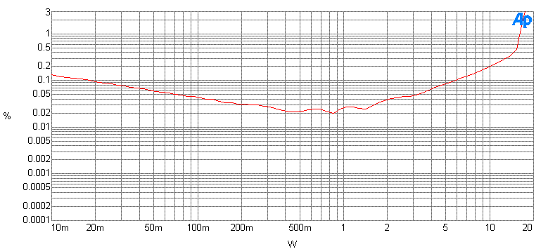

One thing I would like to do is create those nice graphs like Nelson Pass does of distortion vs output power for a power amp. The only options I can find for the horizontal axis is oscillator output, either voltage or power (mW). I suppose I could use an attenuator on the oscillator so that 1mW of oscillator power equals 1W of output power or something to that effect. I really don't want to have to dig into their scripting language.
Do newer AP systems create these graphs without all the hassle?
Success !!!
Well, I finally did it! That thing is complicated. Shoulda joined that company when I had the chance.

I'm registered on the AP site. Sifting through many megabites of info takes a lot of time and I'm not going to print out a 300+ page manual. Went through many of the ap notes, didn't find anything about plotting power as the horizontal axis. The original System One operators guide uses the DOS version of the control program (S1.exe), it's a little different. There's a book by Metzler that explains all the different units used in measuring audio. Very usefull.
Two things were holding me back. One, you have to double click on the sweep menu to get the "large version" to display. That's where the X-Y button is located. Second, because my box only has one channel, I thought "Data 2" referred to the second channel. I haven't seen anywhere in any manual where it talks about a single channel analyzer. I just had to sit down and play with the box to see how it works and try to learn from the help files.
Now I need to get proper test leads together and clean up the amp I'm building so there are not so many clip leads. Get rid of those wavy lines around the 1 watt level.
I had forgotten what I paid, so I looked it up. The price seemed high, (it was a few years ago). Then I looked on ebay to see what's on there now. It was less than any of the AP boxes (not including switchers) on ebay (USA) right now. I had no idea you could spend $20K to get the latest and greatest. I have a Tektronix distortion analyzer and low distortion oscillator. They are from the 80's, designed by the same guys that started AP. The AP box just makes it easy to plot those graphs and store them. I'm not into the ultra low distortion, but it's nice to look at the analyzer output to see the harmonics. I guess the next step would be some way to do FFTs.
