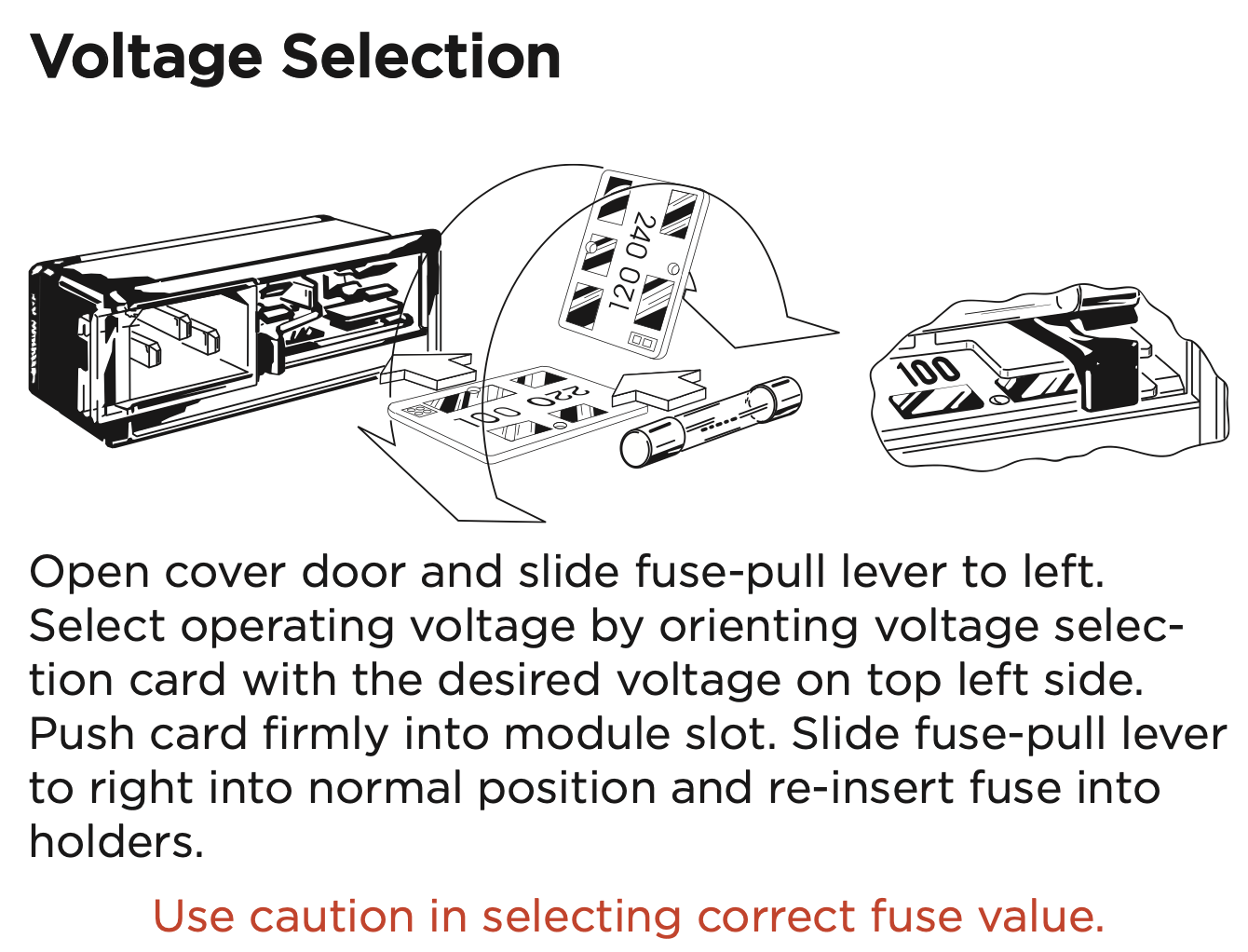

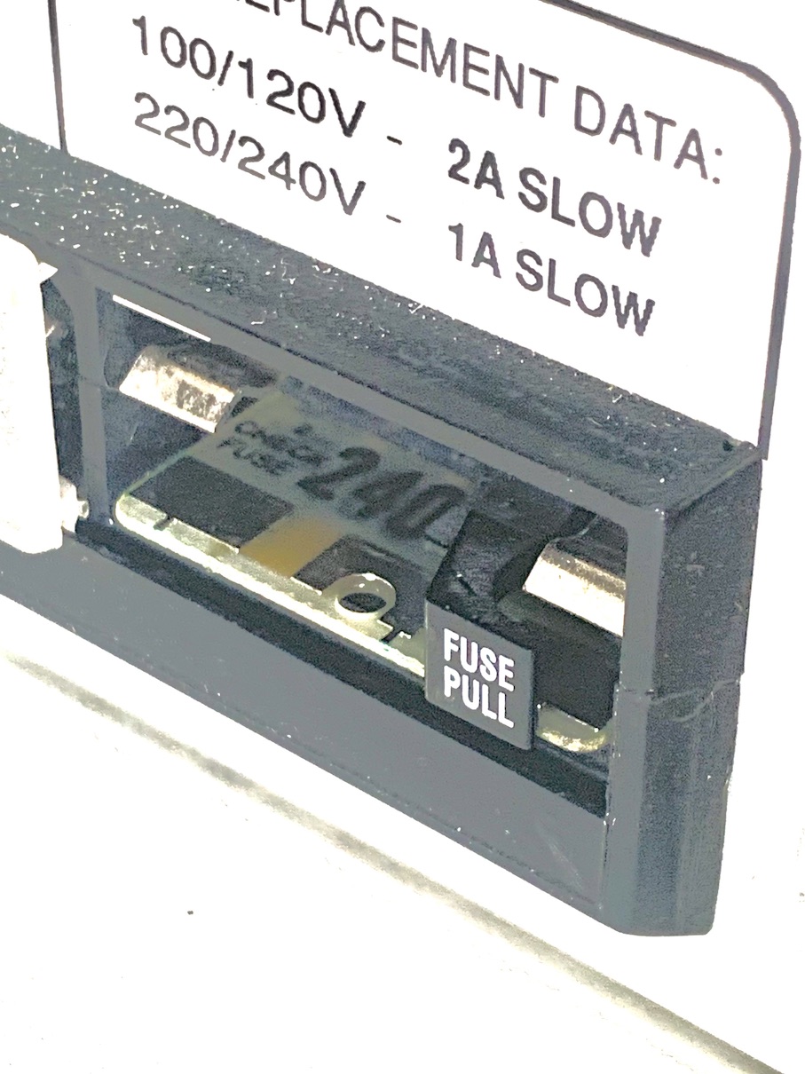

I need help! I've recently acquired Audio Precision System One and trying set the primary line voltage to 240V.
Silly me pulling out the voltage card too hard, it flew out so fast and I didn't manage to see the original orientation. So for 240V does anyone know whether to insert in A or B direction into Audio Precision (refer photo below) . Thanks in advance! :
I tried reading the AP manual but the diagram looks nothing like my voltage selector card :
Download the Corcom DATA SHEET for the IEC AC Power module that in installed. You could also attach a picture of the IEC MODULE.
Duke
Duke
Ok thanks Duke for the help, managed to set to 240V based on this Corcom data sheet, with desired 240V voltage on the top left side.
