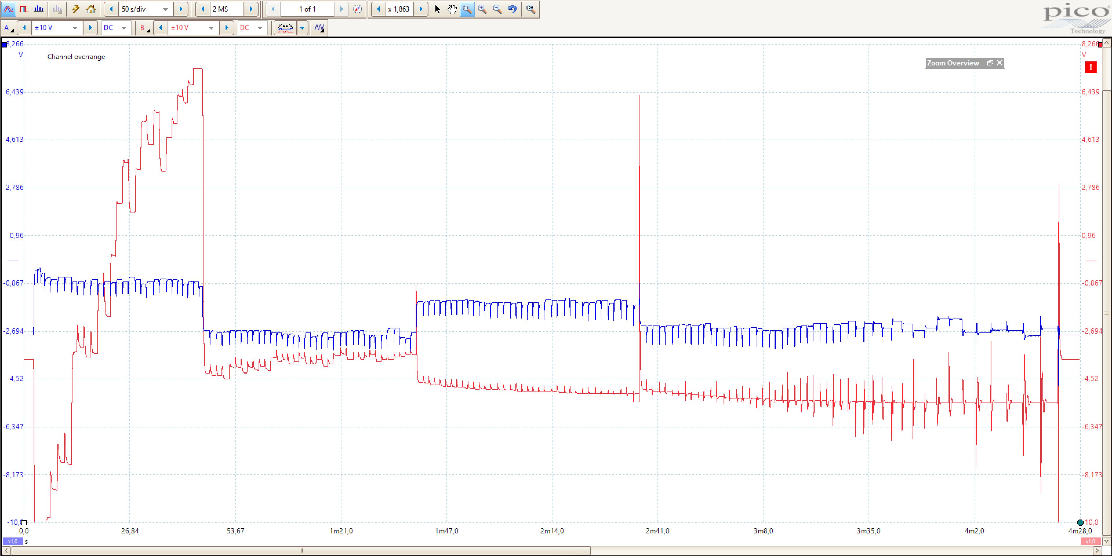

Here is the "tune" and "null" signals out of the servo loop while the instrument is doing a sweep from 120kHz to 9.5Hz (its whole range)
The "tune" signal looks reasonably well behaved. But the "null" is clearly struggling very hard in the top range. The big jumps in tune signal is when the relays toggle the tuning caps.

They have used NE5534AP with external compensation caps for the integrator opamps in the state variable filter. I'll check them out and keep you posted
I took out the two 330pF mica tuning caps and they are within tolerances.
The compensation caps are NP0 type and I took them out as well. They are also within tolerances and don't seem to care about temperature changes much.
But when I cool the NE5534AP opamps or the compensation caps in circuit the THD+n improves a lot.
I noticed that the images I upload to google drive don't get displayed on this forum properly. Opening them in new tab in Chrome works
Let me upload the loop and tune graph again directly to the forum.
I applaud your cooling experiments. I've learned that with careful pressure on the dispense valve, I can dispense nearly drop-by-drop down the small dispensing tube. I can achieve component-specific cooling experiments in many cases.
Is distortion performance good when Null voltage near nominal?
Your sweep waveform is great technique! I'd be tempted to blame the opamp but it performs well on the lower bands.
The two state variable integrator opamps like to be cooled
Same with the mica caps and compensation caps. But those all measure fine out of circuit. So with cooling I can't really pinpoint the bad component.
Do you think the NE5534AP can misbehave in this way?
The THD+n loopback measurement is within specs when the null loop control voltage is within the opamp limits
Out of circuit component tests are not very demanding in stark contrast with distortion tests.
It's disconcerting that the problem is restricted to the top band only--- but of course that's where the mica tuning caps reside. They would be my first candidate for experimental replacement. NPO caps have a great reputation for low distortion and are available in close tolerances.
PS. I've no personal experience with NPO cap distortion. Perhaps other members can offer recommendations re manufacturer and series.
Jaka, if we're lucky, maybe I've stumbled across the secret sauce!
On your manual page 285, just below TABLE DIS2.3, there's discussion of trimmer cap C3501 indicating it's "adjusted at high frequencies to maintain the null control loop within its range." I was finally able to find C3501 in the schematic at location C6 on 9DIS.2000, sheet 3 of 5, page 294.
Assuming there's an equivalent cap in your instrument, maybe you'll be able to find a trimmer setting that brings all within range?
Good luck!
Good luck!
...I noticed that the images I upload to google drive don't get displayed on this forum properly. Opening them in new tab in Chrome works....
The tag you used is for an image, a JPG or GIF file; but you have linked a page, a Google Drive frame around an image.
Just post your G-Drive link naked. (There's other ways but this is simple.)
fullsweep.jpg - Google Drive
That is one of the first things I tried 😀
Unfortunately adjusting the trimmer does not improve anything, so I returned it to the original position.
But there is one thing I noticed.
Measuring the signal out of the lowpass and bandpass opamps from the filter I could see that they are 90 degrees apart as expected and this does not drift, however there is a noticeable amplitude difference between them. This of course depends on Q of the filter and I don't fully understand AP's design, but I would expect that they would want both outputs to have same amplitude when then the frequency in question is the center frequency of the filter.
The two MDAC PCBs should probably be reasonably matched (the control lines are simply wired in parallel so the CPU thinks it is setting the same value on both MDACs). The MDACs also have a trimpot.
I'm disappointed but not surprised. After posting, I thought more about the abruptly different Null waveforms at the boundary between high band and its neighbor. Seemed unlikely to cured by a component trim. Sigh.
I'm intrigued by your observation re amplitudes of lowpass and bandpass sections. How do they compare on lower bands where performance is good?
