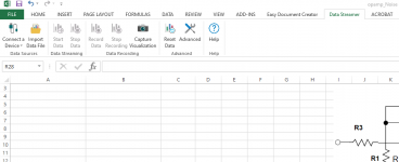

Jack what is this 'data streamer'- is it an APB function? I can look into it.
Jan
It's an Excel "Add-in" -- in beta -- was set up for microchips, arduino etc.
