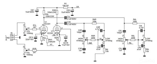

An option if you're not set on a Baxandall type tone control, is John Broskie's diy single-knob passive 'Tilt' type tone control, ala' Quad. It uses a single three-position switch, rather than two potentiometers. Pros and cons to each type of control.
https://www.tubecad.com/2015/06/blog0326.htm
