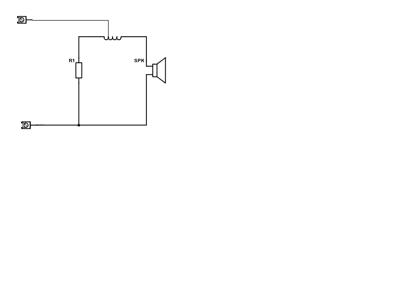

I would be interested in building a passive device to plug in at the output of an audio amp, which will consume all the power coming in into a dummy load, and send some power into a set of speakers, adjustable via a volume knob.
For example at 10W output coming in from the audio amp, I'd send 5W into the dummy load and 5W to the speaker, at full volume (the device volume control, not the audio amp). If I turned the device's volume down to 2W (audio amp still at 10W), then I'd send 8W to the dummy load. So the device always consumes the full power coming in, but diverts from 0W to 5W to a set of speakers, via a volume control. Maximum volume should always be 5W, never more.
Is there a way to do this passively?
Thanks for the links, I read about the high voltage speakers, all with their own transformers.
We already have the Mesa cabclone which my son finds the sound of very different to the real thing. It also does not have a volume control to the speaker, it's either on or off. I think it tries to be too clever, and by missing out on a pass-through volume control it becomes very inflexible, for all the £300 it costs.
In terms of electronic diagram, I have now come up with a simple design, totally resistive and passive. I am attempting to keep the load to the amp constant while diverting up to 5W to the "through" jack. I am hardcoding the loadbox at 8 Ohms. I have included a switch which allows the box to work with various guitar amps, from 25W to 100W.
Of course the load is purely resistive (most of it) and therefore we may not get to hear the amp's output stage's reaction to real speakers, however it is a good approximation and it simulates OK.
What do you think?

I think the simplest way to accomplish what you want to do would be to use a 100 watt "L-Pad" attenuator.
However, reducing the power (voltage) to the speaker will still not sound the same as the "real thing", because the speaker's excursion will no longer be driven past it's linear range of operation, above "Xmax". By current definition, Xmax is the one way excursion above which the "linearity" of the motor deviates by 10%, also resulting in 10% distortion at Fs (the driver's free air resonant frequency) in free air.
Above Xmax, loudspeakers generate even and odd order harmonics, that distortion, as much (or more) than amplifier distortion defines the sound and "overdrive" character of an amp/speaker combination, which can easily exceed 100%- harmonics at higher levels than the fundamental tones.
Guitar speakers generally have small Xmax, using short voice coils easily driven out of their short magnetic gaps, so produce far more distortion at lower drive levels than speakers designed for "hi-fi", clean sound reproduction.
To sound half as loud at 1kHz requires a reduction of 10 dB, 10 watts dropped to 1 watt. Reducing power by 6 dB halves excursion- a speaker designed to be driven well into distortion at 10 watts may hardly distort at all with 2.5 watts, a 6 dB drop in power. Although a guitar speaker may have only 1/4 the Xmax of a speaker designed for clean sound reproduction, the lightweight cone and coil generally result in much higher sensitivities.
Smaller drivers are less sensitive, which can be used to advantage when distortion is a desired feature, as in electric guitar amplification. A 6" guitar speaker is around 6 dB less sensitive than a 12", so would also start to distort with about 6 dB less sound pressure level than the 12", the equivalent of dropping the 12" from 10 watts to 2.5 watts, but still maintaining the amp/speaker distortion with no attenuation.
Of course, even with a small speaker with the same distortion signature as a larger one at higher SPL (sound pressure level), having less SPL lessens sustain (acoustic-electric feedback). If SPL is dropped 6 dB one must move the guitar twice as close to the speaker for the same "feel".

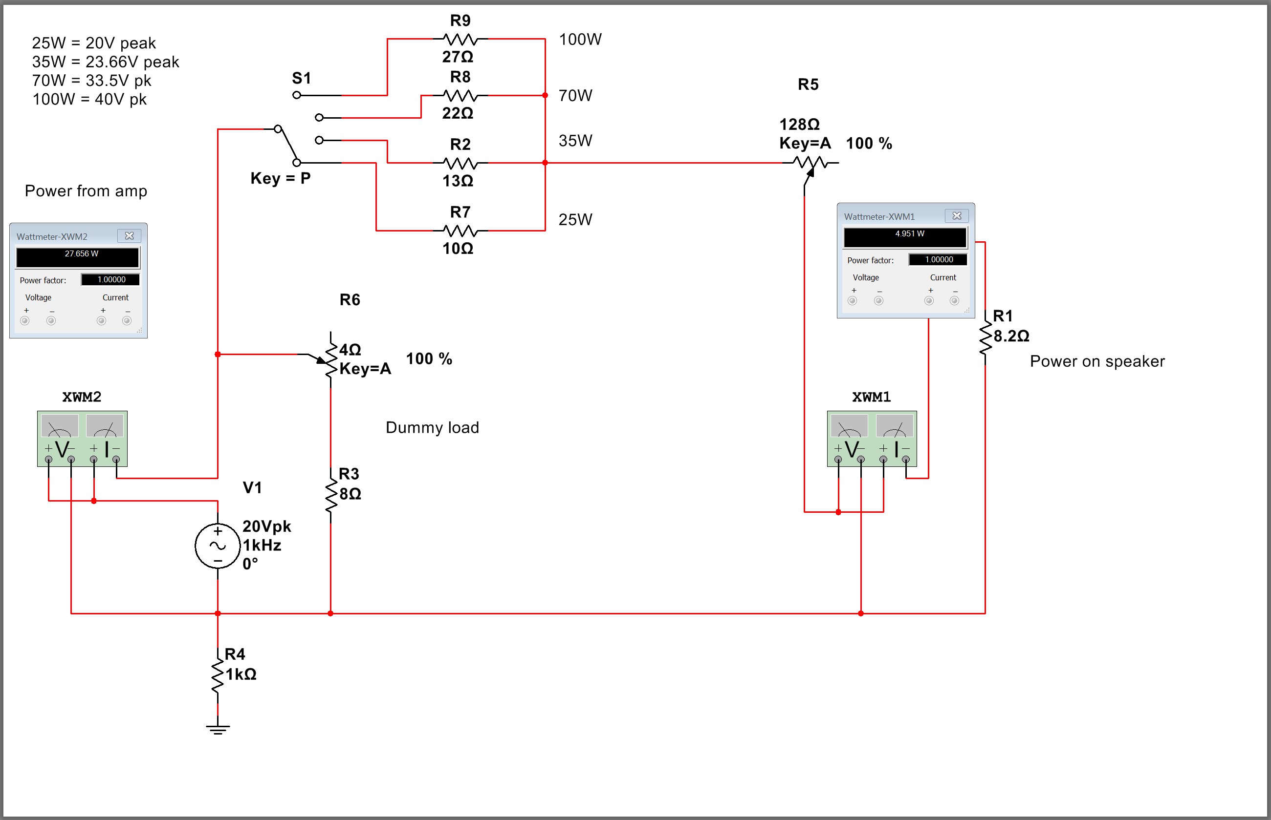

Actually, regarding the above schematic, I just checked, and I would need lots of watts for the pots, the first one at 25W for a 100W amp, or 9W for a 35W amp. There are very expensive rheostats of such power but maybe there is another design to do this with inexpensive parts.

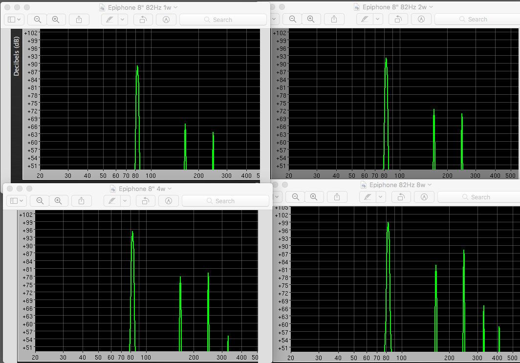

Akis,
As you note, the “valve” overdrive can be clearly seen, as can the overdrive of a guitar speaker.
1-2 watts may still be too loud for a small space, while not driving the speaker into distortion that is arguably contributes as much of the sound of electric guitar as the amplifier.
A typical 2x12” guitar cabinet plays at 103 to 108 dB at one meter with just one watt, 111 dB at two watts is hardly “quiet”, but still won’t come close to the distortion we associate with that type of cabinet driven with the usual 50-100 watt tube (valve) amp.
To illustrate the effect of overdriving a speaker, a sine wave tone at 82 Hz, the low E note on a guitar, was sent at various levels from 1 to 8 watts (a 9 dB range) to an Epiphone 8” speaker, standard issue in the Valve Jr. combo “5 watt” amp.
Measured at one meter, 1 watt, the second harmonic is about 22 dB down from the 89 dB fundamental, around 8% distortion. At 2 watts, up to around 11% distortion, still relatively “clean” for electric guitar. At 4 watts, the third harmonic now has risen above the second, more “edge”, though THD is still under 14%. At 8 watts, the distortion almost triples to over 28%, with upper third, fourth and fifth harmonics rising. About twice as “loud” sounding (+9dB) but tripling the distortion increases the perceived loudness considerably over what the the SPL (Sound pressure level) alone would indicate.
The 8” speaker used in the Fender VibroChamp XD, also a tube combo “5 watt” amp, has nearly 100% THD driven at 8 watts, the third harmonic only 2 dB down from the 82 Hz fundamental. Of interest, the resulting distortion from that drive level creates a full “E major” chord from the single E (82 Hz sine wave) tone- E, B and G# notes appear in the harmonic sequence.
8 watts into a B&C 8” designed for high power PA midrange use shows little distortion, the third harmonic around 29 dB below the fundamental, about 3.55% distortion.
Guitar speakers designed for higher power amps won’t have enough distortion when played at a only a few watts, I’d suggest trying small guitar speakers for volume reduction in addition to amplifier attenuation if you’d like to satisfy the search for electric guitar “tone” at “quiet” levels.

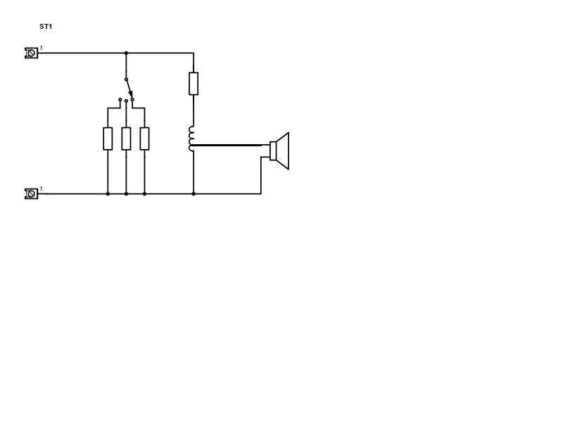

Just came across this. Max, did you mean a common variac or a line-level, dual-gang autotransformer?.
Hi Allen, I am thinking an AC power variac wired as standard auto transformer like below but I don't know what the frequency response/sound would be like....maybe trendsetting lol.
The switchable shunt resistors are to keep control of overall impedance, an extra permanent shunt resistor directly across the variac would be wise and I am not sure about the series value.

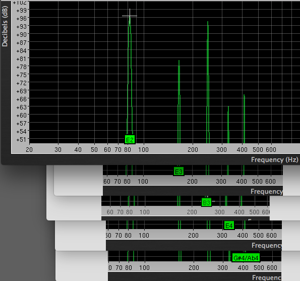

"was sent at various levels from 1 to 8 watts (a 9 dB range) to an Epiphone 8” speaker, standard issue in the Valve Jr. combo “5 watt” amp."
What was the wattage of that speaker? Our speakers are 75W (stonehenge), 150W (tonkers) etc
My variac is 500VA so can handle loads above 100 ohms, I don't think the lows are going to be a problem. I'd be interested to measure the self-resonance though.
I guess we aren't talking Voltage sources here.
What about derating the transformer for low voltage input?
What's it there for?
Or maybe something like this might work ?.....
Interesting. There may be some signal flux cancellation.
I'm talking tube amp transformer output so it needs some minimum value of resistance as load.
500VA is way past what's needed.
Attenuation and reduction of inductive component of load.
I didn't think it through or simulate, just a suggestion ?.
