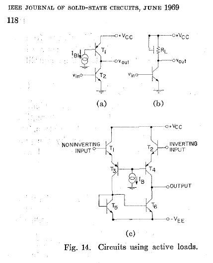

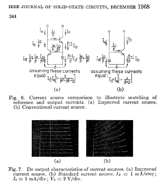

According to Russel & Solomon, Thompson first used current-mirrors in 1966.
I am not at all certain that it can be inferred from Russel & Solomon that Thompson first used current mirrors.
I am of the view that they meant the entire circuit, in which the use of a current mirror was incidental, was first used by Thompson.
The first appearance of a 2-transitor current mirror in the Journal Of Solid-State Circuits, as best as I can tell, is in a paper by George Wilson (Dec 1968). In passing, he refers to it as a "conventional" mirror (Fig 6b) while extolling the virtues of his new 3-transistor current mirror (Fig 6a). History has subsequently named this 3-transistor circuit after its inventor: the Wilson current mirror.
The first appearance of a differential amplifier with current mirror load in JSSC, again as best as I can tell, is in a paper by Camenzind (Mr. NE555) in June 1969. CC+CB differential input stage is loaded by a current mirror for differential-to-singleended conversion, sometimes called "phase summing": Fig 14c. In 1969 the sorry state of lateral PNPs precluded their use in common emitter topologies, so folks used them in CB and little else.
