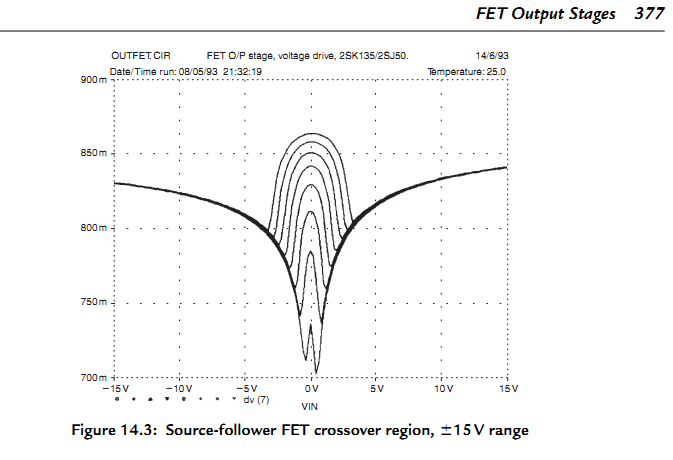

MOSFET Output stages
Hi Ian,
No, it doesn't answer my question. Maybe you could check whether the 6th edition still contains the (erroneous!) picture and text as shown below.
Cheers, E.
Chapter 21 - The FET output stage, is among the shortest with the last reference from 1995. Perhaps that answers your question, Edmond.
Hi Ian,
Cheers, E.

Funny you should say that as I was drawing an idea for something I must do pronto . I have a Quad 405 I can use . I would have to modify it a bit so would rather build this in an old PA amp chassis I have . This is the old Hitachi double VAS degenerated into a Self design . I need an experimental amp for a 15 inch bass unit . This is at the musing stage . The input bootstrapping is a waste of time if I filter the output as the bootstrapping dies with the HF . Thus the ideal input load is lost . However if used as a general purpose amp it might have virtue . Takes a second to remove it so where is the harm to try it ? If I had some Hitachi PCB's ( Like Maplin LP56 ) I wouldn't have thought of this . Now out of the need to press on I am going to build this as a Gain clone . I have the parts and have done it before .
Output stage compensation is a possibility ( two pole ? ) . Again I have done it in the past and had no real problems . HF distrotion is lower at 50 kHz .
This design works well with VAS bootstrap ( 2 x 3K6 = 7 mA @ 50 V ) . Even though FET gain is far less than 1 the gain is enough to drive a bootstrap . In fact a gain of 0.5 is enough to do something .
This circuit is the good and the bad of Self . The Hitachi is better , this one is good enough . The CRD are ones I have . Vishay are too expensive now . 3 resistors and a bootstrap cap will do about the same . I have degenerated the LTP to bring it back to Hitachi re of 50 R .
BTW . Many people refer to their understanding of electronics to know an amp like this is not worth building . Funny thing is my spectrum analyzer wasn't told that and liked the design ( distortion about - 80 dB I seem to remember , alas I lost the notes ) . Ignore the quirky filtering . Doubtless that will be big trouble . I will move slowly on that . You are right if asking . 60 Hz - 3dB ! . Far cheaper than 30 mH air cored .
