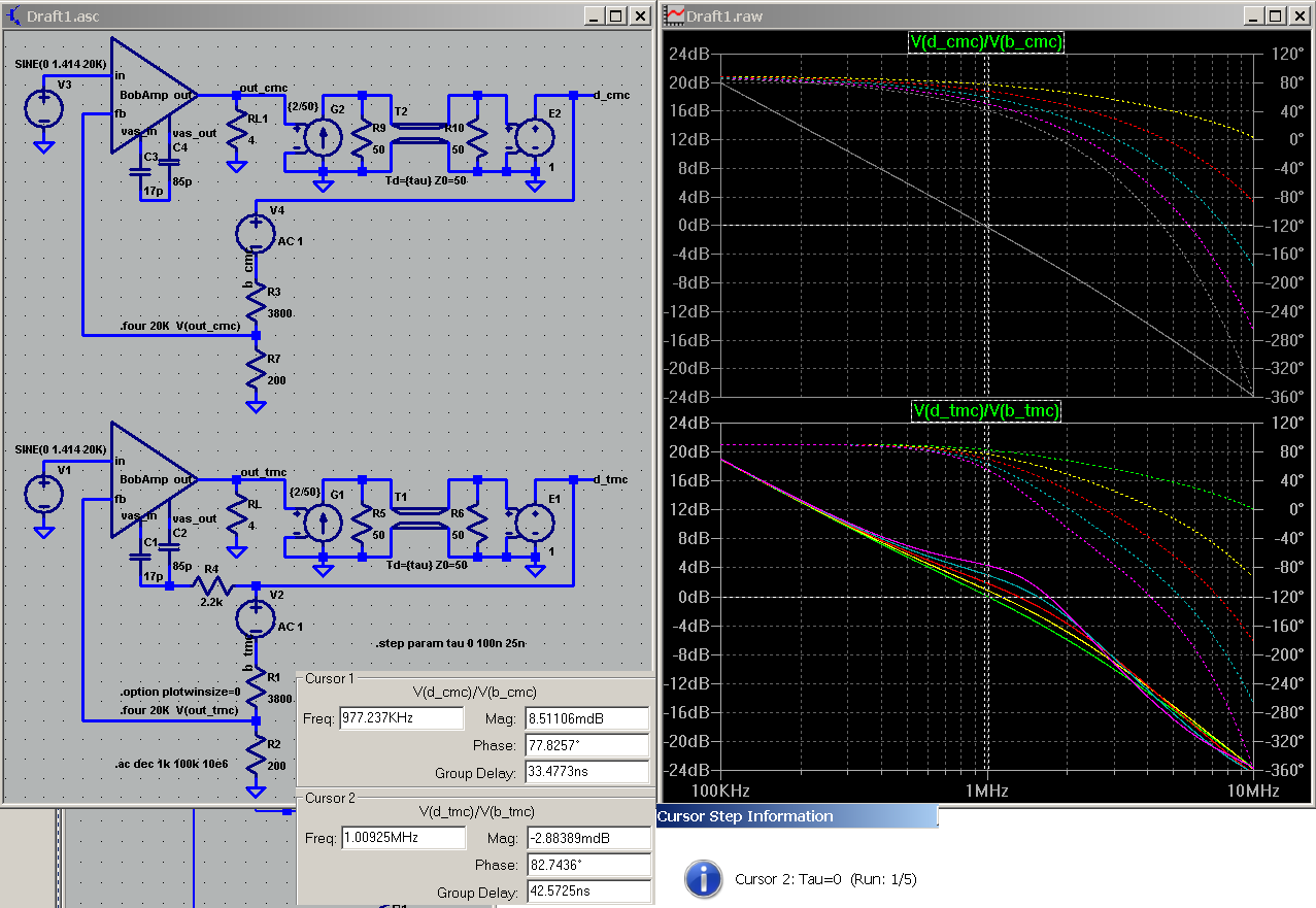

I long ago despaired of Bob's and Edmond's obstinate refusal to recognise that "TMC" is simply TPC applied about the transimpedance stage and the output stage with the input stage subjected to a single pole global feedback rolloff.
This is very simply demonstrated by merely examinng the minor loop gain to which the last two stages of a "TMC" compensated amplifier are subjected.
One should then find (provided the compensator component values are identical for valid comparison) that the total loop gain to which the last the second stage and the output stage of a "TMC" compensated amplifier is virtually identical in magnitude of the major loop gain of a TPC compensated amplifier. This suggests that a more descriptive name for "TMC" is localised TPC.
I demonstrated this a long time ago on this forum by showing loop gain simulation analyses.
Alas, Bob and Edmond prefered to depend on virtually useless SPICE distortion simulation for their erroneous conclusions.
I hope Douglas Self gives a more accurate description and comparison of "TMC" and TPC.
P.S: Douglas Self, please note that what you described as input inclusive compensation in your article on "TMC" in Jan Didden's bookzine is, in fact, nothing of the sort: it is simply phase lead compensation which excludes the output stage. This is easily established by running major loop gain AC analysis on an ordinary lead compensated amplier, an "input inclusive" compensated amplifier and a miller minor loop compensated amplifier. Middlebrook's loop gain probe (erroneously called Tian's loop gain probe) can be used in LTspice for this purpose.
Hi Doug,
I was wondering how long it would take Mike to chime in on this, as he very strongly held a different view in that TMC thread. He is wrong and you should maintain your position, which I believe largely reflects mine and Edmonds insofar as TMC being different than TPC. Mike is just stubbornly taking a contrarian position on this.
He is also wrong in saying that Miller Input Compensation (MIC) is simply lead feedback compensation. It is hugely different depending on whether it is taken from the output or from the VAS, since a great deal of the excess phase that eats into phase margin comes from the output stage. Input compensation is a very old technique used for many years in its simplest form where a series RC was placed across the differential input. That is simple lag compensation. MIC is just an analogous extension of input compensation where the Miller effect is used. This is largely the same comparison as between lag compensation at the VAS versus Miller compensation enclosing the VAS.
I first used Miller Input Compensation in my 1983 MOSFET Power Amplifier with Error Correction. I'm sure others had used the arrangement before me although I can't cite a reference and probably just came up with it independently. It provided a tremendous improvement in slew rate, yielding 300V/us in a 50-watt amplifier with 2 MHz closed loop bandwidth. Simple feedback lead compensation, when conventionally used, is not used to provide the main compensation of the amplifier, but rather to provide some leading phase shift to improve phase margin. To call the MIC arrangement lead compensation is tremendously misleading.
Bob
I suppose
If you're referring to connecting one end of the compensation capacitor to the collector of the second stage and the other end to the junction of the feedback resistors as "MIC", then you're completely wrong.
For a start pole splliting does not occur with this technique and moreover it has ABSOLUTELY nothing to do with Mr Miller and should not therefore be called "Miller Input Compensation."
It is obviously phase lead compensation; just run the loop gain simulations i've described before you respond.
