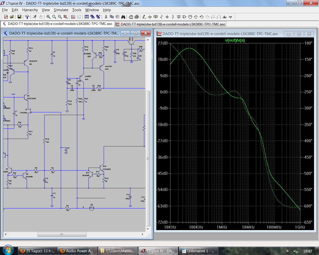

Here is how I try to simulate TPC-TMC combination.
First picture TPC only with no capacitive brigde over TPC (C22)
Second picture TPC only with cap bridge(no overshooting). This small cap could be just parasitic.
Third picture TPC TMC simulation, Middlbrook probe between output and TMC resistot(R30).
Hi Damir,
I think your simulation of the loop around the OPS, that is created due to TMC, is incorrect. When connecting node "A" to the TMC resistor R30, you should break the global loop e.g. by connecting a 1F capacity from the LPT's inverting input to ground (C27 in the picture below). If you do not do that, then you see a mixed response from global loop and TMC loop.
The result shows a unity gain crossover of around 1.5MHz together with good stability margins.
My concerns about the VAS loop on its own (post #537, low phase margin) remain. I think it is a topic all too often neglected. People only consider it, when the VAS really starts to oscillate.
BR, Matze
