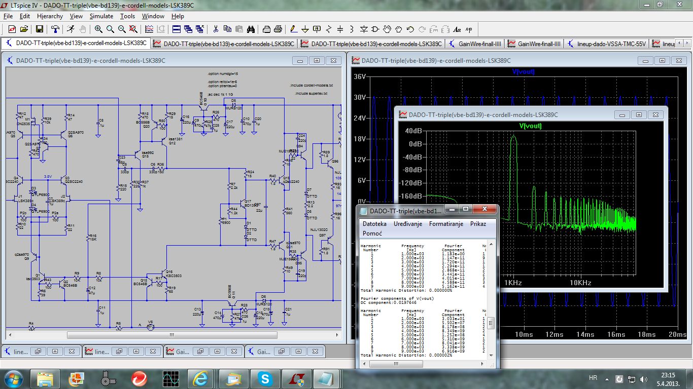

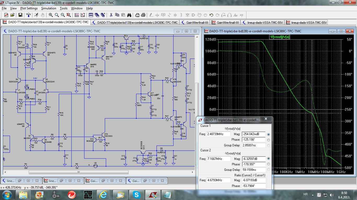

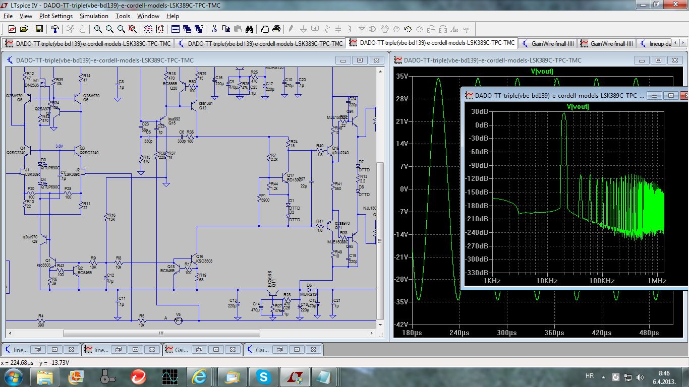

I was hoping to present to yus gurus a SPICE simulation of my Jurassic experiments which started with sorta 'Blameless' and led to 'pure Cherry' and finally Two Pole Cherry
[*] which I gather is your TPC + TMC. It works very well.
The value of the 'opinions' on this thread isn't the theoretical musings .. but the practical tests which have been done to validate these. eg I'm quite happy to accept that various people including Doug & Great Guru Baxandall have had problems getting pure Cherry to work. It's finding out why they had problems when I had a relatively straightforward experience that may add to the store of human knowledge.
Alas, as a beach bum, I can only demonstrate in LTspice what I found in real life. As a SPICE newbie, I'm always suspicious of my results .. especially when they jar with real life experience.

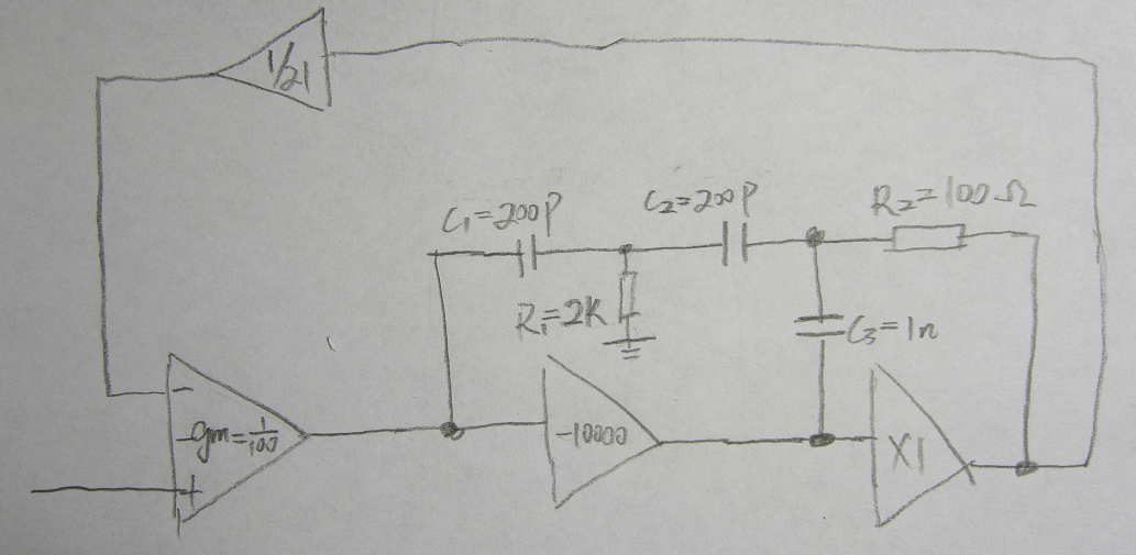

Can you show a schematic demonstrating this? I doubt if this is stable.
Transitional Two Pole Compensation.
I haven't simulated this. The value may not be right. 🙂
This can't work as you'll have a triple pole roll off of the loop gain. Very unstable.

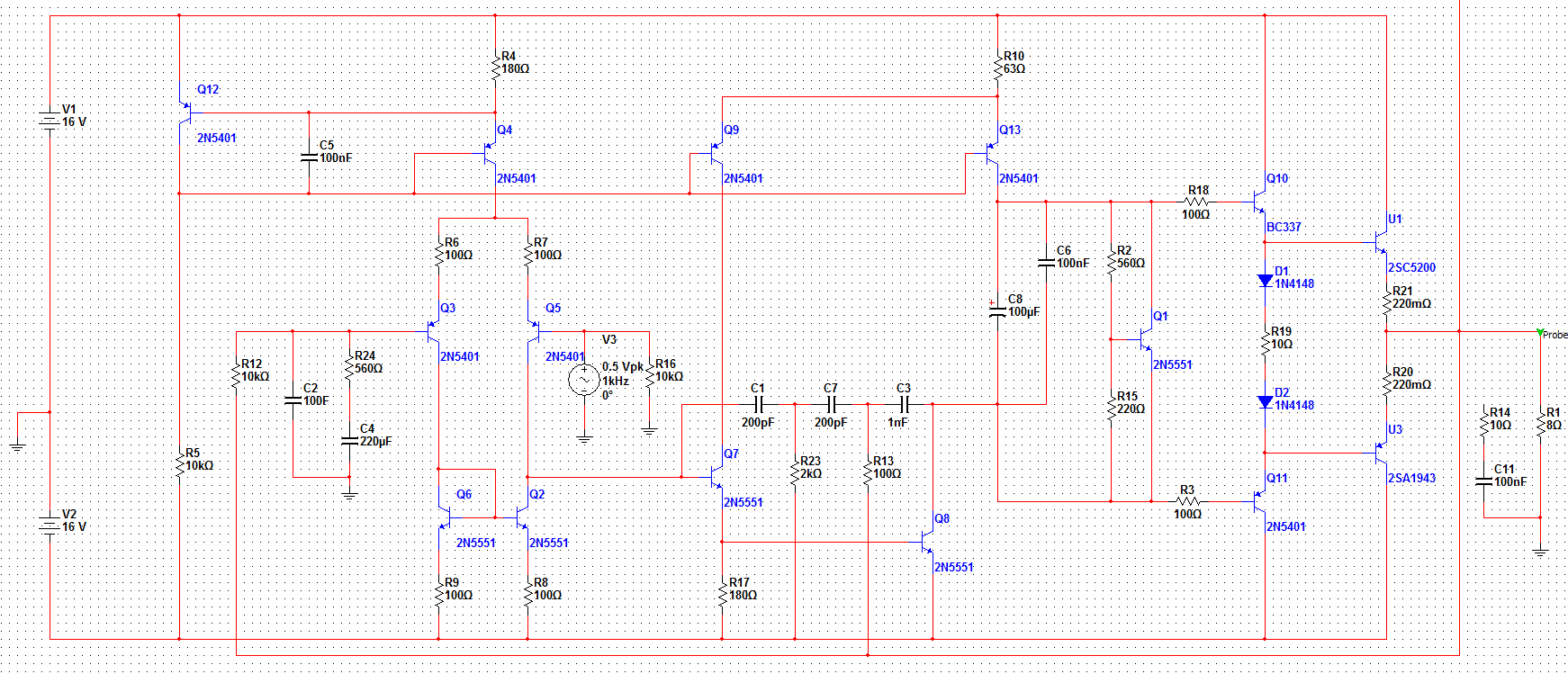

Here is the simulation.
There is plenty phase margin and gain margin. It could be quite stable.

How have you simulated the response?
Your circuit shows a probe at the output rather than a loop probe.

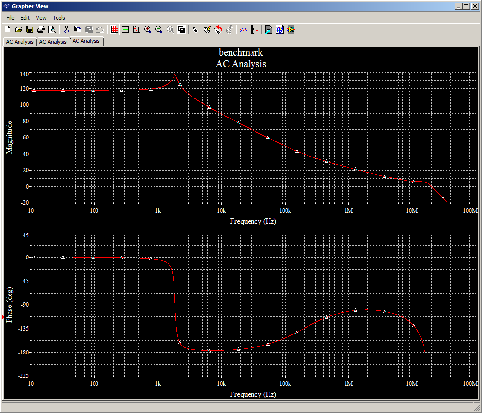

I use Multsim. The graph can be get from "AC Analysis".
In schematic, I use C2 to short the negative input to the ground so that I can get open loop response directly from output. I am not sure how others get open loop response. 😱

I have just realized that the AC Vsource does not actually measure the loop gain.
It measures the Return Difference, as defined by Bode.

Loop Gain does not mean Open Loop Gain, it is difference between open loop gain and closed loop gain, or the return difference, yes.
BR Damir
Yes, I understand that loop gain does not mean open loop gain.
The point was that Return Difference is not loop gain.
What you have defined is Return Difference.
Loop Gain is Return Ratio = RD - 1.
Not much different for typical audio but it starts to matter when the values are low, usually only near unity crossover frequency.
But this is a critical area for a maximum feedback amplifier and Bode had already realised this and created the two different terms to make it easy to separate the ideas even if the values are similar. Brilliant.
