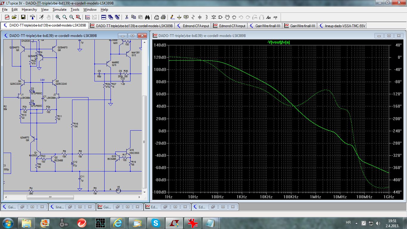

If Middlebrook probe was set as in this simulation then TMC loop gain shows similar behaviorr as TPC.
Damir

I disagree about using exactly the same component values to compare TMC and TPC.
Adjust the values so that you get the same ULGF and them see what the gain and phase margins are. That's a better test of equivancy.
Th fact that TPC achieves lower distortion by making more global feedback available at HF vs TMC which applies it where the biggest issue is (the output stage) should tell us they are fundamentally different.
If you are going to use TPC, it's probably a better fit with class A (no cross over distortion) while TMC is a better fit in my view for class AB.
I have TMC'd two power amps and had no stability issues. That said, I like at least >60 degrees of PM and 12 dB gain margin and this may be a contributing factor.
The notion that you get more loop gain about the output stage with "TMC" than with TPC is an outright myth.
This can be proved, as I have pointed out, by using exactly the same component values calculated for TPC for "TMC". You should then find that the total loop gain about the TIS and the output stage with both TPC and "TMC" is the same at all frequencies, and that the unity loop gain frequencies and stability margins are also the same.

This may be true, but when comparing TPC and "TMC", it makes sense to use exactly the same component values.
Mike,
This is one area where we strongly disagree. One should not constrain the comparison to using the same compensation component values for the two techniques. Let the best technique win in any given amplifier design, using whatever combinations of component values that give the best performance for that technique. The constraint should be that the two implementations yield the same degree of stability.
Bob
Then don't use the same values and let the best technique for a given amplifier win. You are way over-constraining the problem.
It is outright foolish to assume that two techniques that are fundamentally different (I think we all agree to that now) should want the same component values for best performance.
Bob
