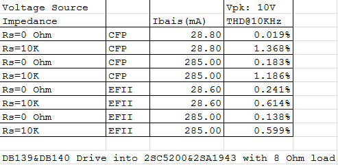

As my experience.
If you use TMC compensation. EFII is more linear.
If you use normal miller compensation. CFP is more linear.
Why?
Because CFP has strong local voltage negative feedback to ensure high linearity when it is driven by voltage source.
On contrast, EFII has high linearity when it is driven by current source.
When you use TMC compensation, most of time(Low Freq.) the output stage is included in miller compensation. Then you can look VAS as a current source. EFII is more suitable for this job.
When you use normal miller compensation, the strong local nagetive feedback on VAS make it more like a voltage source. CFP does well in this case.

This is a very interesting observation as to whether the output stage is effectively voltage driven or current driven depending on whether the compensation is conventional Miller or TMC. The effective driving mode may also depend on the effective input impedance of the output stage, depending on whether it is a Double or a Triple.
In any case, I usually think of the output stage as being voltage driven as my starting baseline is conventional Miller compensation and the use of a Triple output stage.
If a double-EF output stage and a CFP output stage are both being voltage-driven, I still believe that the CFP is more prone to distortion due to its typically much-higher transconductance at a given bias current, making optimum idle bias often lower and somewhat tricky (you may notice that some of the CFP output stages Doug shows must be somewhat starved of idle bias to achieve the optimum crossover relationship). A lower idle bias results in a smaller quasi Class A region where both halves of the output stage are contributing significant transconductance. This can result in higher distortion at small signal levels.
(BTW, MOSFETs, with their lower transconductance, like a higher idle bias, resulting in a larger "class A" region and often better sound).
One thing about the CFP output stage that many people overlook is the difference in linearity of a single CFP (good due to local feedback) versus that of a pair of CFPs hooked together in a class AB output stage (poor due to crossover distortion resulting from difficulty of splicing together two output sources, each of which has a low impedance). When voltage-driven, the CFP can be prone to serious gm doubling at reasonable idle bias operating conditions with reasonable values of RE equal to or greater than 0.15 ohm.
Finally, to the extent that we allow an output stage to operate in a current-driven regime, we now expose ourselves to much greater distortions resulting from beta mismatch and beta droop.
Bob

Hi, Bob,
It's nice to hear response from you.
You mentioned the driving mode might depend on the input impedance of output stage. That just let me remember something from your book and Douglas' book.
I have read both books, those are great books. I could have never built my first discrete amplifier without them.
The first difference I see between your design style and Douglas' style, is that you would use smaller value capacitor to do Miller Compensation comparing to Douglas' design. In most case, you would use 33pF, while Douglas prefers 100pF on VAS. The good thing is that smaller Cdom means larger slew rate, but on the other hand, it triples output impedance of VAS.
In some sense, the output of your VAS is more "current source like" than Douglas' VAS.
From that point of view, Douglas' VAS might be more CFP friendly. The same CFP might perform better on his platform than yours, since CFP deals with voltage source better than current source.
Another thing resulted by higher output impedance of VAS, is that it prefers higher input impedance of output stage to minimize the VAS load. In that case triple EF is a good choice.
I personally prefer EF instead of CFP. I just don't want to deal with parasitic oscillation in CFP without professional equipment.

I just simulated some cases. You are right. CFP only works well when bias current is very small and the impedance of signal source must be low as well.
