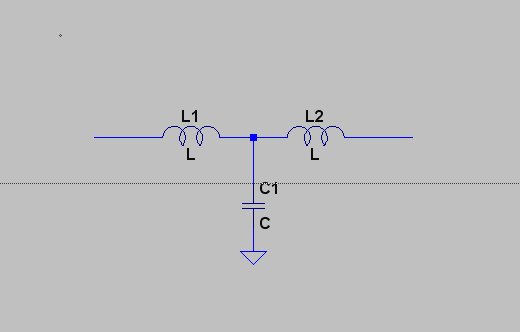

You also might simulate the effect of (ridiculous) 6 inch long wires to the output devices. A wire, 1mm thick and 6 inches long, has a self-inductance (no pun intended) of 173nH.

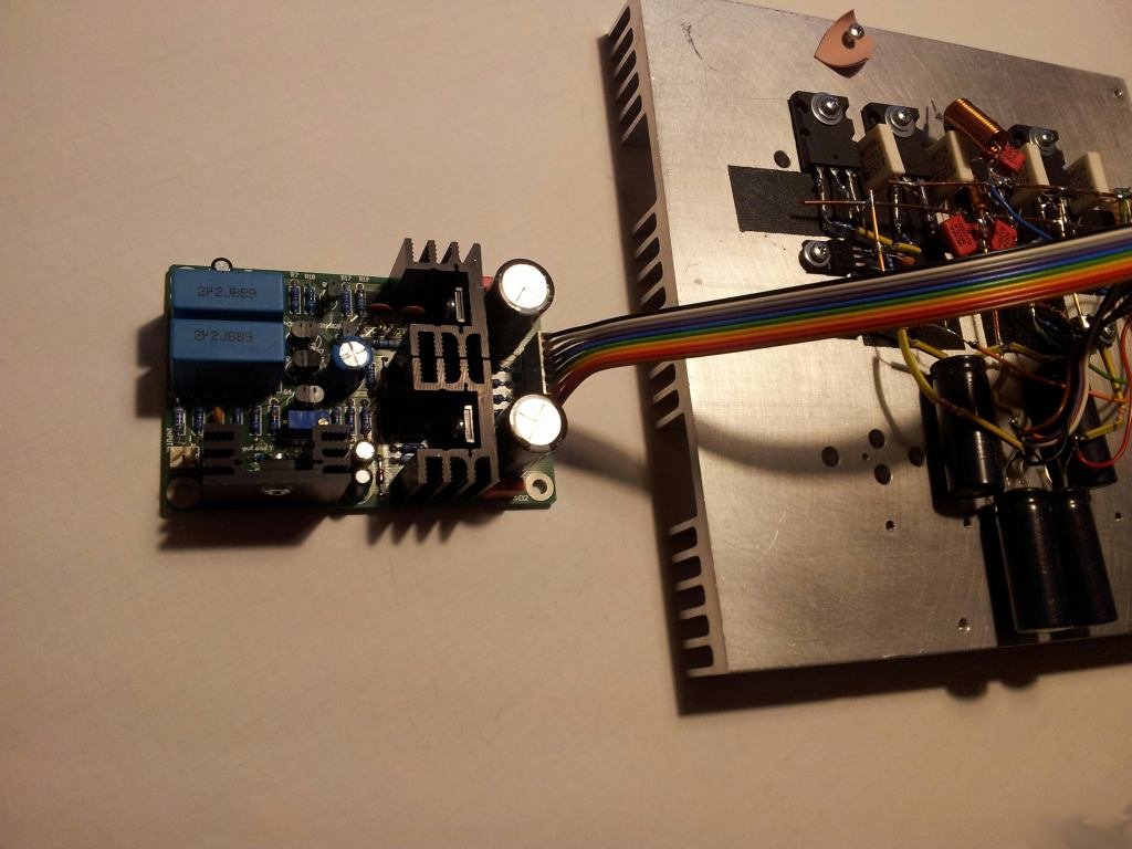

6 inch - you never have seen a papa pass amplifier?
6 inch and more from input/vas stage to output devices is no problem for a good designed blameless.
If you have ever had something to do with low to medium radio frequencies, you should know the wave length and delay of e.g. 1MHz freqency. All you need to know is how to avoid and/or suppress hf oscillation...
E.g: Papa Pass also uses in his X amplifier series very long ribbon cable from input/vas stage to his power output stages.

Never simulated a cable, but perhaps this way:
L1 and L2 half of self inductance and C1 with some pF

Dear Edmond,
sorry - my mistake - next time I will read carefully ...
I meant 6 inches between input/vas to output stage as seen in attached pictures.
Thx for clarification,
Toni
