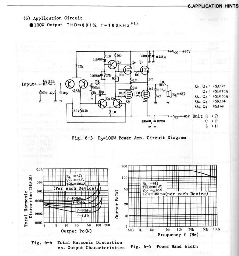

This is very useful, I only ever saw the last page before. It makes the mystery deepen as the trans-conductance is seemingly very poor. It does beg the questions, how is it with all this against it the MOS FET seems to perform at least as well as any bipolar stage allowing for Ron.
Reducing the VAS current to 5.6 mA the square-wave performance starts to go off at 30 kHz. The sound to my ears is optimum when Exicon at that level. I suspect the small HF loss is an advantage.
The 12 K and 8,8 nF is placed to help the double VAS balance at > 30 kHz. It can be tuned. You should find the double VAS balances nicely withing 2% on the input pair. Not bad for a crude circuit. I plan to try a current mirror to replace the 5K1 ( 3K9 on mine ). That could be BCV61 ( 62 is the other polarity ). It is only a 20 V device. The 2 V clamping of VAS will protect it. I doubt you will better BCV 61 if using discreet parts. I have a feeling it will do little of advantage.
A tail CCS is an OK idea (to replace 62 K ) . Works almost as well without it. 220 R seems an ideal gate stopper. As far as I know it is the inductance that a cheap resistor has that is working. If you are as stupid as me you will find the gate oscillates all the time if measured ( not recommended ). It seems not to emerge from the source but can circle back through the VAS. With 220 R it is gone. Still there at the gate if looking. The wave is about 5 MHz on the one I tested and a very pure sine wave so it seemed. Hard to say because the scope is tailing off at 5 MHz. I didn't have my fancy scope then.
If you look very carefully the 100 kHz distortion it is 0.005 % at 30 watts. Hard to beat that if any amp and if you did to what advantage? Less components than any op amp with far higher performance.
Thanks Tommy.
The role of R12 is to keep the thermal dissipation in Q4 the same as in Q5.
Some designs replace it with a common base transistor with its base connected to ground.
This common base transitor is sometimes shunt at high frequencies by a capacitor between emitter and collector.
Quite strange is the "Miller" cap of 15 pF.
I think a Samuel Groner's advice for this kind of topology (usually named "Hitachi") is to connect this cap from base of Q4 to ground and to add another one, of same value, between base and collector of Q5.

Hi Tommy,
First, some of the negativity you may hear about the MOSFET is born of ignorance and prejudice. Each type of device, be it BJT, Lateral MOSFET or Vertical MOSFET, has its own advantages and challenges. These are outlined in my book in a comparison that I believe is fair and honest.
Transconductance for MOSFETs, and especially Lateral MOSFETs is lower than that of BJTs, leading to what I call transconductance droop. This leads to greater low-order crossover distortion, and to the condition that MOSFETs like to be biased somewhat higher to get higher transconductance. MOSFETs do not really have an optimum bias like BJTs do - the more the better within reason and dissipation limits. This means that you are free to get a bigger class A region. It also means that MOSFET amplifiers are less prone to thermally-generated bias errors. You will never have your MOSFET amplifier become bias-starved under dynamic conditions.
I prefer Vertical MOSFETs because they achieve higher transconductance and result in less transconductance droop. They are excellent devices for audio as long as properly designed and driven. Verticals are what I used in my MOSFET power amplifier with error correction, which achieved THD+N below 0.001% at all power levels back in 1983.
Of course, MOSFETs are generally faster than BJT output transistors.
Bottom line is that a MOSFET output stage will have greater static crossover distortion all else remaining equal, than a properly designed BJT output stage when the BJT is truly operating at its optimum bias (which may often be only on the bench when playing a sinusoid in steady state). If you are looking for the very best on-the-bench or simulated THD, without resort to error correction, go with BJTs. If you go with BJTs, go with the ThermalTraks for better bias tracking. I have had good results with the ThermalTraks.
A 10C dynamic change in BJT die temperature will change Vbe by about 22mV, which is significant in comparison to the 26mV optimum bias across RE in a BJT. This is a great oversimplification, and things are not quite as bad as this suggests, but you get the picture. It is very easy to get a 10C die temperature swing that will not be compensated by the usual bias temperature compensation quickly enough. This is why ThermalTraks are preferred.
My Vertical MOSFET amps achieve around 0.01 to 0.02% THD or lower at 20kHz at any power level up to rated full power. This is with reasonably conservative compensation with gain crossover frequency at about 1MHz.
That Hitachi amplifier is not a very good design, and you can do much better.
Bob

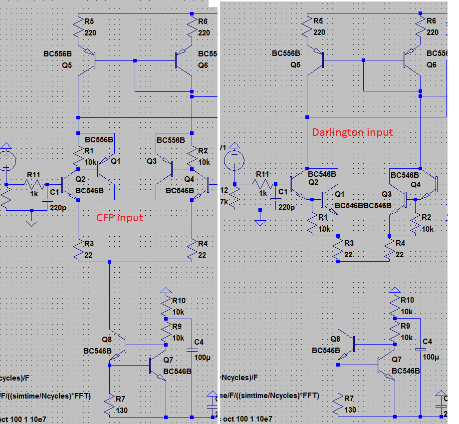

Hello
Sorry for small off-topic, but I am looking for some advice/explenation.
I am going to try CFP or darlington arangement of LTP input stage with current mirror.
It looks that CFP has a higher gain but I do not know which configuration is better from the technical and practical point of view (I have never tryed it before). Both have very high overal gain and in/out impedance but soundwise I have no clue.
I would be very happy If someone can write a few simple words to compare this two input stages.
BIG thanks.
Peter

Hello
BIG thanks.
Peter
In a roundabout way this answers your question. He manages to make a strong argument for a complimentary pair single input ( not long tail pair ). Many facts and figures so good reading.

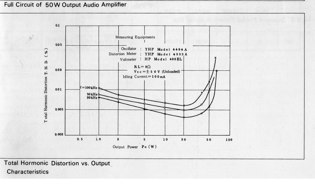

Hi Nigel,
I assume you are referring to the amplifier in post #2322. I honestly do not see any way that the Hitachi design can achieve 0.01% THD at 100kHz at 100W into a 8-ohm load. The input pair is undegenerated and the output MOSFETs are driven with no buffers from the VAS. I have not simulated it, but I am bewildered by their claims.
BTW, I know of no THD analyzer that can give even remotely accurate THD readings at 100 kHz, since one would want at least a 500kHz residual bandwidth to capture even the first few harmonics. I think many THD analyzers often use an 80kHz residual bandwidth. My original THD analyzer used a 200kHz bandwidth for THD-20 measurements, but even that would be insufficient for a THD-100 measurement.
It is, of course possible in principle that Hitachi used an RF spectrum analyzer to look at the harmonics, but at the time I'm not sure any such analyzers had enough dynamic range to see the distortion lines with any accuracy (one would want 100dB of dynamic range).
Bob
