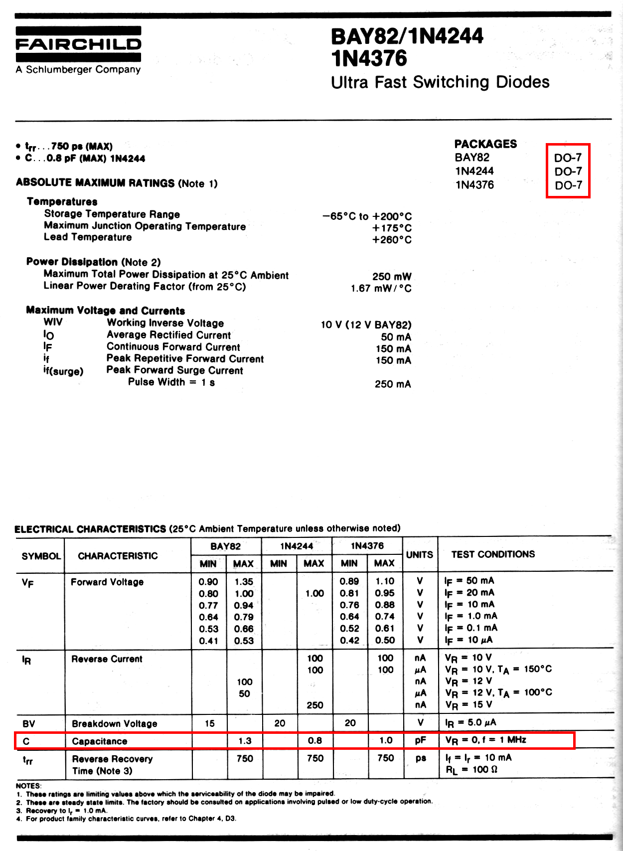

The Rectron is about 5x the Nexperia capacitance - chip layout and process differences.
But if your design is ok with the 2.5pF, it should be ok.
Once you are above a few volts Vr, the change in capacitance if quite flat anyway in the big scheme of things.
Is there anything better out there ??
What I have is a diode that needs to conduct forward at 1/3 of the cycle , but quickly
goes reverse to as much as -80V reverse for the other 2/3rd.
https://www.fagorelectronica.com/im...des-for-High-Speed-Switching-Applications.pdf
Have you tried any "ultra soft recovery" high speed diodes ? The reverse recovery seems to be the performance variable for both the high power
schottkey and ultrafast diodes when used in a class H application.
This "recovery" can easily be seen even in simulation.

BAV21 is not the same as BAS21J - I stopped using BAV21 many years ago because of the reverse capacitance.
RS has the BAS21J - that's who I get mine from usually.
That is SMD and in DIY not everybody is ready to use it. Is there any THT diode with similar low capacitance?
Sorry dadod - I don't think so. The packaging also has an impact on the overall capacitance. Most ultrafast small signal diodes are SMD because of lead inductance problems with through hole versions.
Maybe this one? https://hr.mouser.com/datasheet/2/427/bav17-67693.pdf
