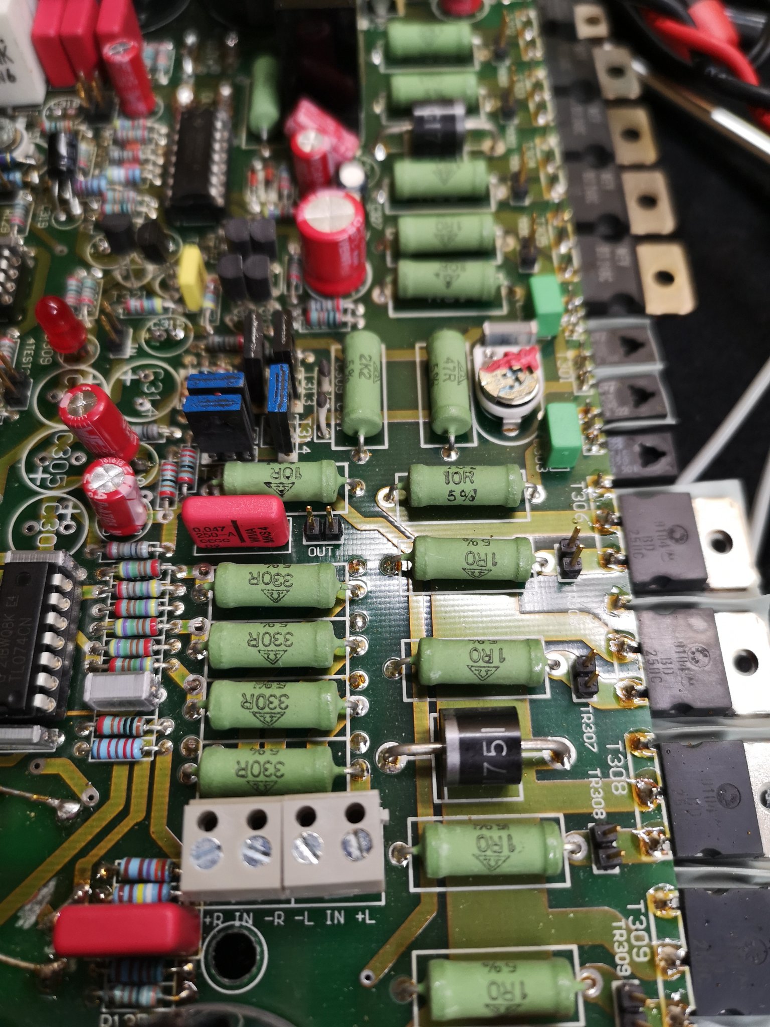

Anyone got a scematic for this excellent Sub amplifier?
I have No sound, relay do not turn on, No voltage to relay. No DC on output either. All opamps looks ok when tested separately.

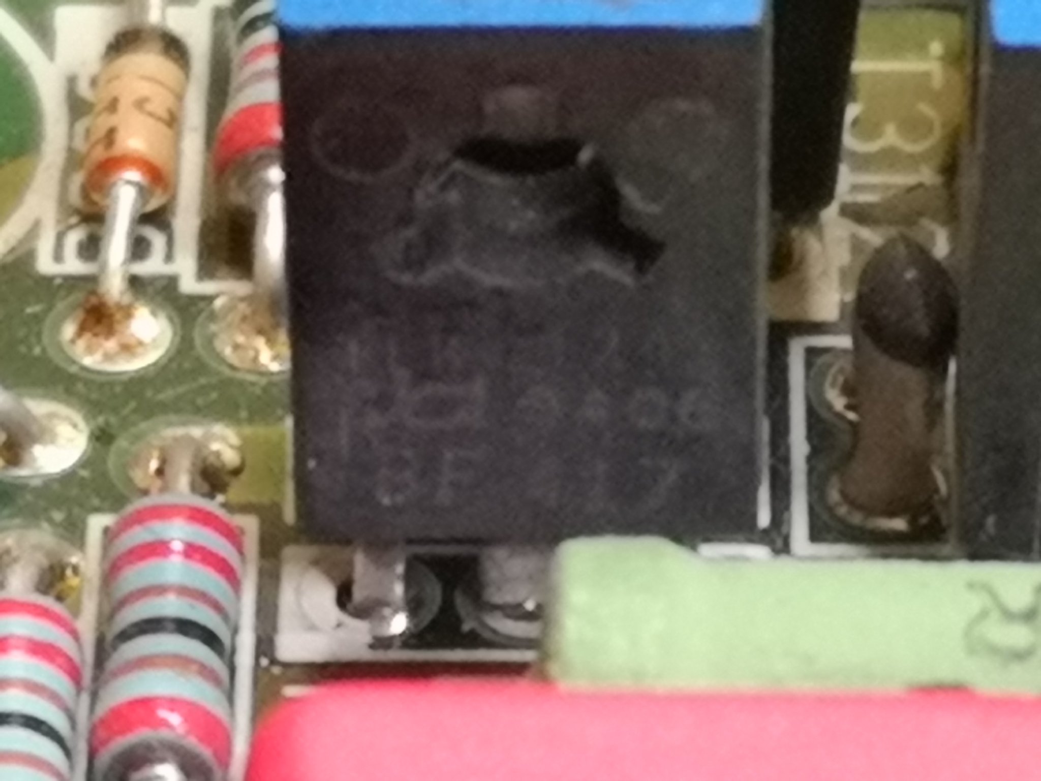

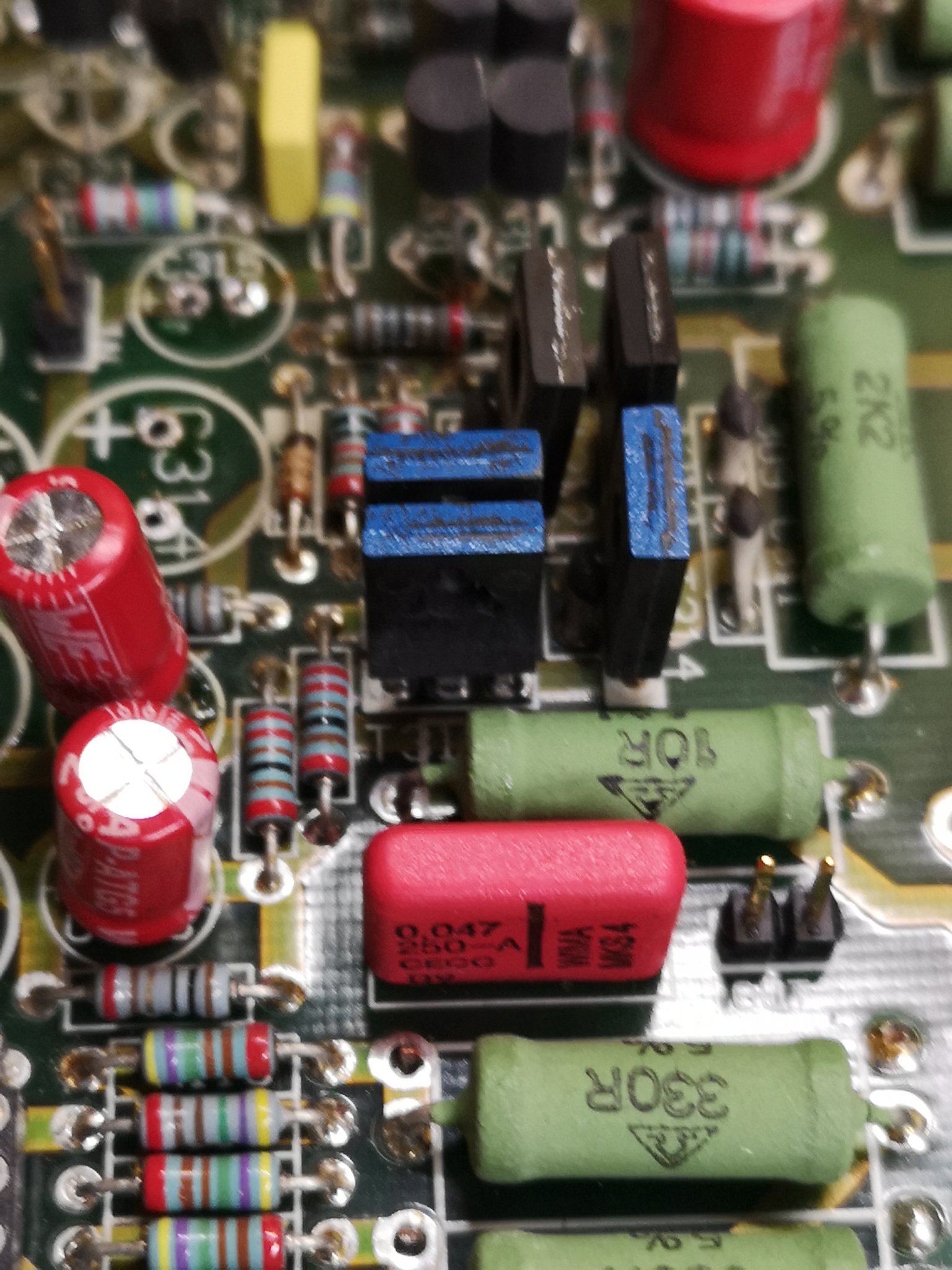

Found short between collector-emitter on this BF417. I have 2 amps of this type and both are same, with same short. Could this be a normal case? Shorted?
Both amp have fault and do not work, found No other signs. Changed all caps to be sure they are ok. Any advice would be Great. Do not know if any other recognice this behavior?
