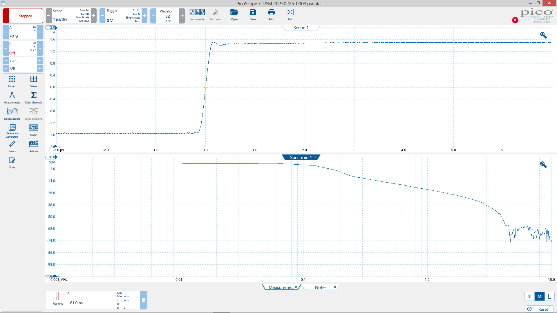

I designed discrete op-amp and shared to local audio community. Someone made the implementation and measure it. THD is not very low around 0.0x and slew rate about 12V/uS. The output is class A single-ended. Many of them like the sound.
I think, if we cannot achieve very low distortion, then use class A because it is small signal. It is hard to make unity gain stable with high slew rate.

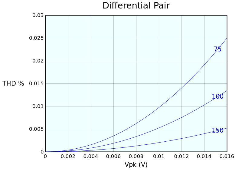

I will share a simulation result which anyone can replicate. This is the distortion of a differential pair running at 1.5mA total (i.e. not a phono pre-amp) with emitter degeneration, versus the peak input voltage. The distortion comes from the exponential relationship between current and voltage (Ebers-Moll).
60dB of open-loop gain means that 10mV input will produce 10V output. The distortion is only 100PPM with 75 ohms, or 50PPM with 100 ohms. Now close the loop by dividing the THD by the loop gain. The closed-loop distortion can easily be made single-digits.
Maybe some day I will show that the rest of the op-amp contributes less distortion than the differential pair. I believe this is the case since the degeneration elsewhere is greater, and everything runs in class A.

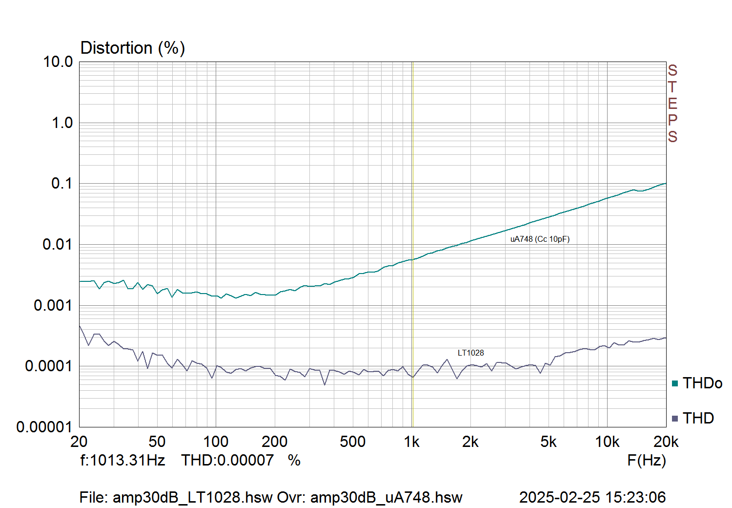

I am amazed that that the AD829 does so well. It was never intended or even envisaged for this purpose.
The previous measurement was with a sine sweep, so the resolution, especially at HF, was not the best one. Below the same setup, gain 30dB amplifier, and AD829 vs. LT1028. I have many similar measurements and also noise measurements, so maybe I could open a new thread.
Below 100Hz - signs of LF capacitor distortion of the input coupling electrolytic capacitor in the ADC. This is verified to be the case.
