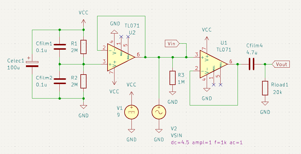

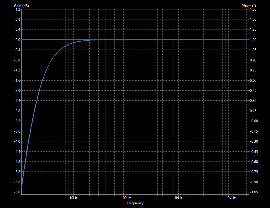

@Mark Tillotson hello again. Is this somewhat close to the circuit you describe? I'd love to hear your feedback/corrections.
The left hand side is what I expect to generate the virtual ground, but you've shorted it to the Vin... Call the negative side of the battery V-, and the positive side V+, then GND will be the output of U2.
Hello all, happy new year!

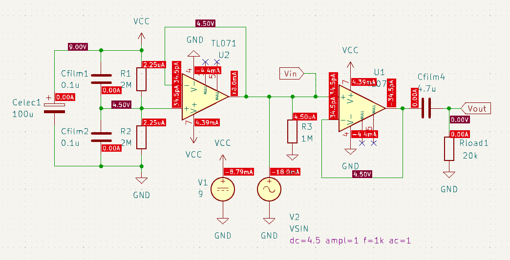

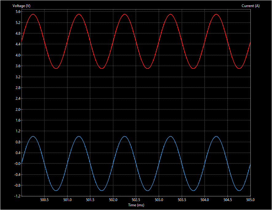

@Mark Tillotson I did check the circuit and it seems to work as intended. By connecting the first op amp's output to the non-inverting input of the audio op amp I am just biasing the input signal to the bias voltage. I did have trouble running simulations to verify it works. I discovered that the reason was my sine signal generator needed to be referenced to 4.5V instead of 0V otherwise the simulation would fail. When I set dc to 4.5V, DC operating point simulation ran, and I also did a transient analysis and AC sweep. Here's the final circuit, and related pictures. This is with just buffering, without any gain.
So I think it functions well. The only thing I didn't manage to do is somehow show Vin swing around 0V instead of the bias voltage (without affecting the simulations), but that's no biggie.

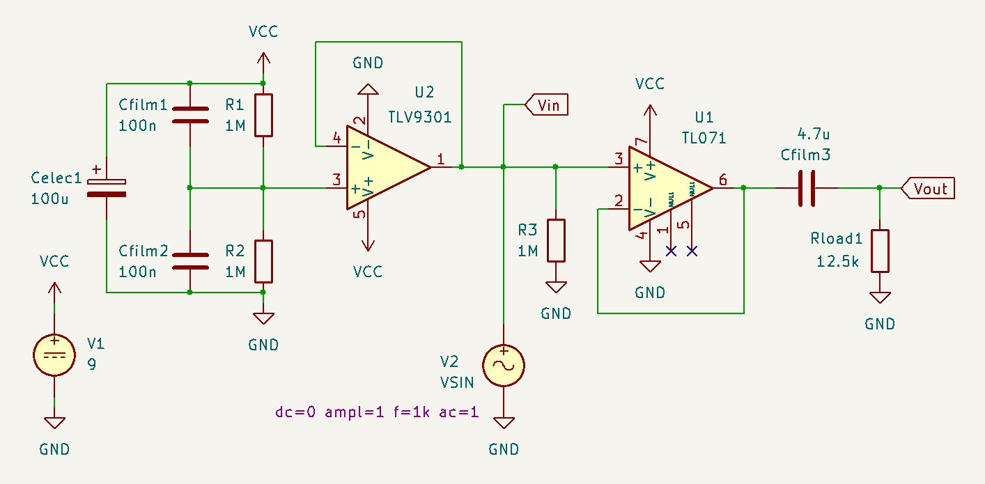

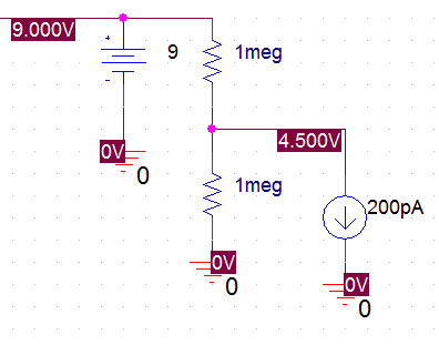

I thought about revisiting this thread. In order to cut down on parts/space/cost I am pondering creating a bias voltage with a simple voltage divider and leaving it unbuffered. The objective is to balance low current draw from the voltage divider, but with enough current to maintain a stable bias voltage for the two non inverting inputs of the TL072BCP op-amp I intend to use. So the focus is on the voltage divider.
I will be using a simple 100u/35V electrolytic for bulk decoupling. For each voltage divider resistor, a film capacitor of 0.1u/50V or, if it offers increased stability, 0.22u/50V since these are the two types of film capacitors I have handy. The op amp will consume about 3.8mA (measured at +-9VDC from a symmetric power supply) and I would like to keep the current draw of the voltage divider as low as possible without compromising bias voltage stability. So the main variable I am investigating for is the value of the two resistors R1, R2.
I have made some modifications to the circuit, mainly introducing a bias voltage injecting resistor of 1M, which also sets the input impedance of the op-amp if I understand correctly. Here's what I have currently:

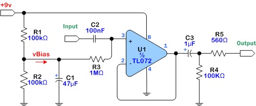

For reference, I have also come across this schematic on another thread. Apparently it is the input buffer stage of a well known guitar pedal:
Here we obviously have a non symmetric electrolytic capacitor to stabilize the bias voltage, and more importantly, 100k voltage divider resistors. But this device is typically powered by an AC/DC adapter whereas I intend to use my buffer onboard an electric bass using two regular 9V alkaline batteries. Using 100k resistors would yield a voltage divider current of about 0.1mA which I feel is significant, about 3% of total current draw. So the question is, how high can I go with R1, R2 while maintaining a stable bias voltage point for this application? I believe this depends on the input bias current of the op amp which according to the datasheet is 65pA typical, 200pA maximum. But I can't make calculations to estimate what resistors would be appropriate. If there's practical ways of checking if I have a stable bias voltage given specific resistor values, I 'd love to hear about them.
Since the buffers will be used with passive electric bass pickups, I thought of giving you an intuitive idea of what the op amp and bias voltage point should have to deal with. That is, low frequencies, but also fast transients and high peaks with certain playing styles. So here is Wojtek Pilichowski for you, to hopefully make this thread a bit more flashy and colorful. 🙂

Re post #32:
Cf_1 injects supply rail noise direct into the signal path - lose it? If you signals are ground referenced then the bias voltage (aka virtual ground) should be coupled only to ground via Cf_2... However due to the rest of the signal path and that 1M resistor this will only affect very low frequencies - in fact its not clear even Cf_2 is doing anything at all.
Frankly I think you can lose Rbias, Cf_1 and Cf_2. The input signal is far lower impedance than the bias.
Is Rsrc1 an attempt to simulate a source impedance of 10k? If so its in the wrong place - it certainly has zero effect on the simulation as its stands as its short-circuited by the voltage source V2.

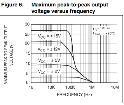

But that's only got 1MHz GBP and 3.5V/us slew rate - not what I'd call adequate for audio. Most audio capable opamps have 2 to 5mA supply current ratings for good reason, they need it...You can also replace TL071 by TL061 and reduce 1.4mA to 200uA supply current.
Considering voltage output full rail swinging from -4 to +4V, the minimum slew rate you need for 20kHz is 0.5V/usec, so 3.5V/usec is enough.
SR = 2*π*f*Vpeak
And considering this is a bass pre-amp, harmonics around 20kHz will be much lower than full rail.
He can build the pre-amp with an 8pin DIP socket to try TL071 and TL061.
Listen to both options and/or measure the results and take the decision.
I think the battery saving for this application is relevant and it's worth the optimization.
The TL061 datasheet shows the maximum voltage swing versus frequency, which confirms 20kHz is ok.

If you move to swing output to +/-7.5V (9-1.5), the minimum slew rate doubles and you'll need at least 0.94V/us at 20kHz, which is still within the op amp capability.
And as we do in power amplifiers, if you want to make sure no high speed signal (not audio) interferes with the op amp slew rate, you can put a low pass filter in the input so as to make sure the bandwidth is limited to 20 or 30kHz.
