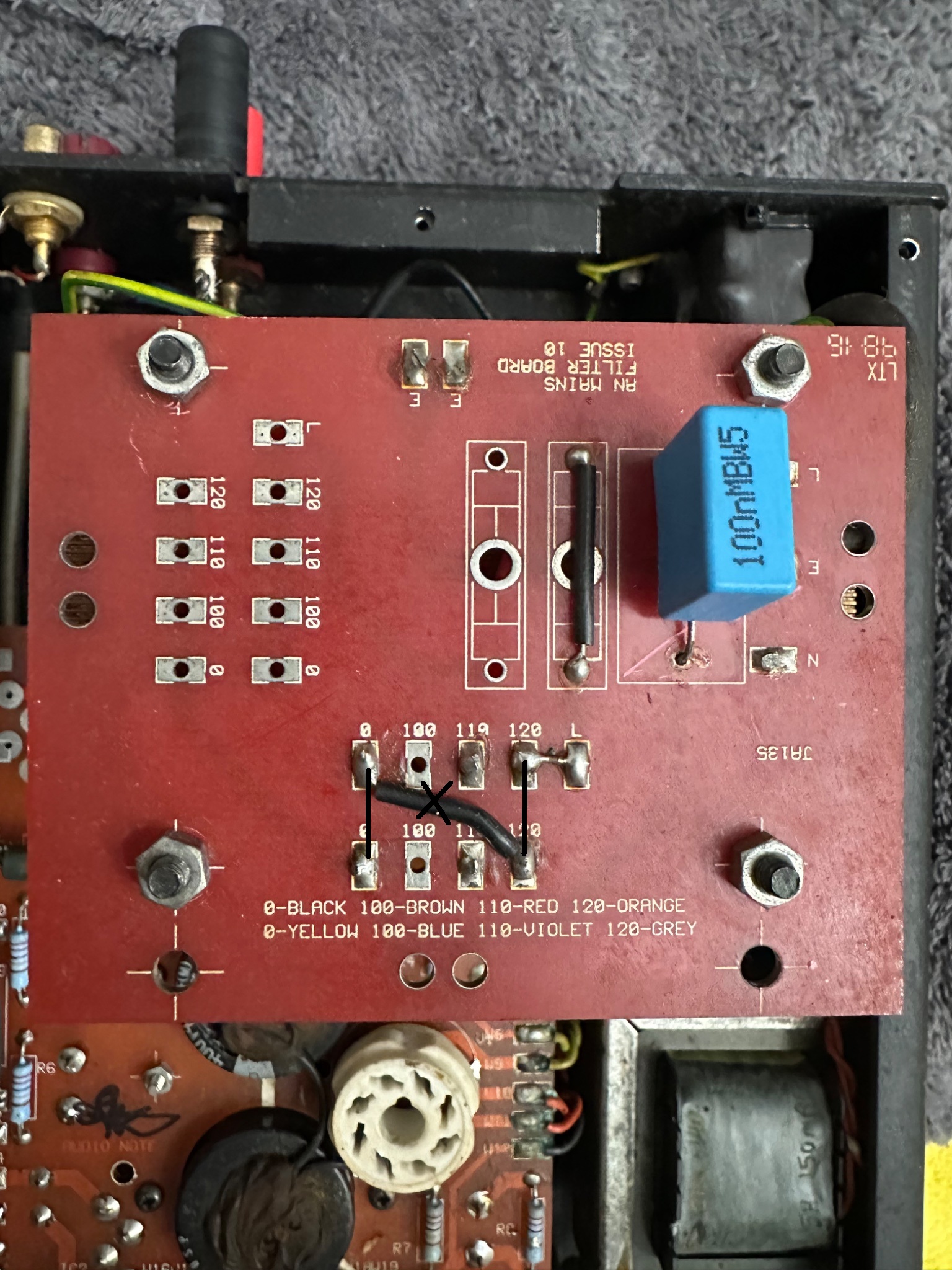

Hi. Bought an audio note quest 300b that’s wired in series for 240v. How do I wire it for 120v. Pic attached and if u need the underside as well I can open and take pics. Thanks.

I think is
0 with 0
and 120 with 120
But if you a a tester you can measure the Rdc from0 70 120 in upper row
and same in bottom row,
must be equal
In the photo the jumeor means that the two primary are in series
Walter
Better ask the manufacturer as it seems confusing. Logic says 0 to 0 and 120 to 120 but it is Audio Note and if it is a DIY kit certainly be careful. Probably you need to use one of the fuse holders for 120V too. The wire instead of a fuse/fuse holder is also a bit worrying. Please note that the fuse value is dependent on mains voltage. Make sure it has a fuse in the mains circuit for your safety.
Tip: add nylon washers to that 4 bolts.
