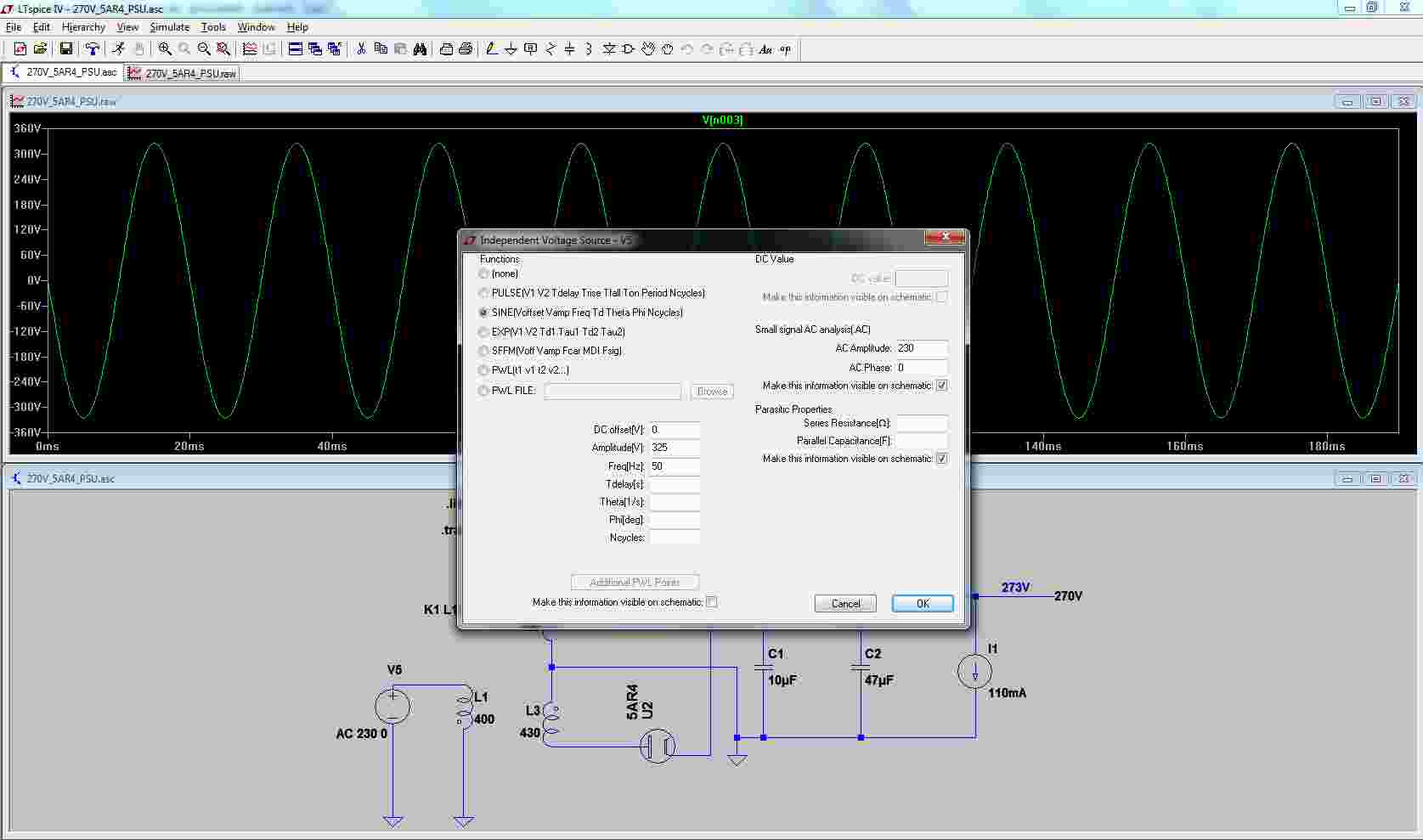

Wouldnt your voltage be 325v?
I thought this was peak voltage input, 230x1.414=325m RMS would be 230?
Yes.
Each voltage source amplitude is peek voltage.
"AC 230 0" is the small signal AC analysis voltage.

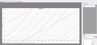

Validate 6072 SPICE Model

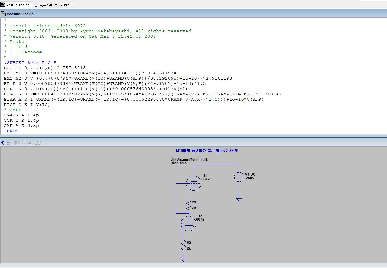

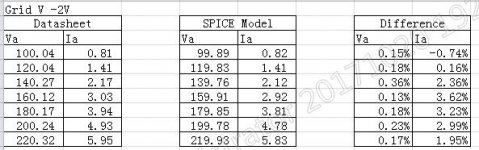

I am trying to use 6072 SPICE model in my circuit. In order to make sure the model is correct, I try to validate the model by the following way.
This is the 6072 SPICE model downloaded from the DiyAudio(it is made by Ayumi Nakabayashi)

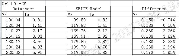

The last step seems unnecessary, you could simply overlay the SPICE generated graph over the data sheet to compare the two.
Good enough, since the manufacturing tolerance and variations among different makes could easily exceed 5%.

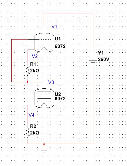

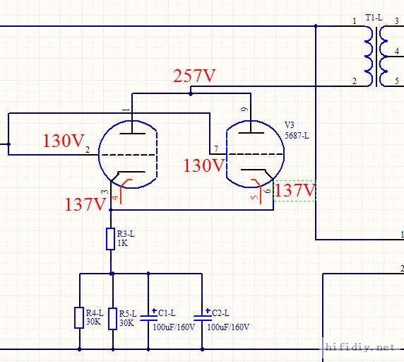

Then I want to use a real circuit to test the model
I used the 6072 in a SRPP circuit

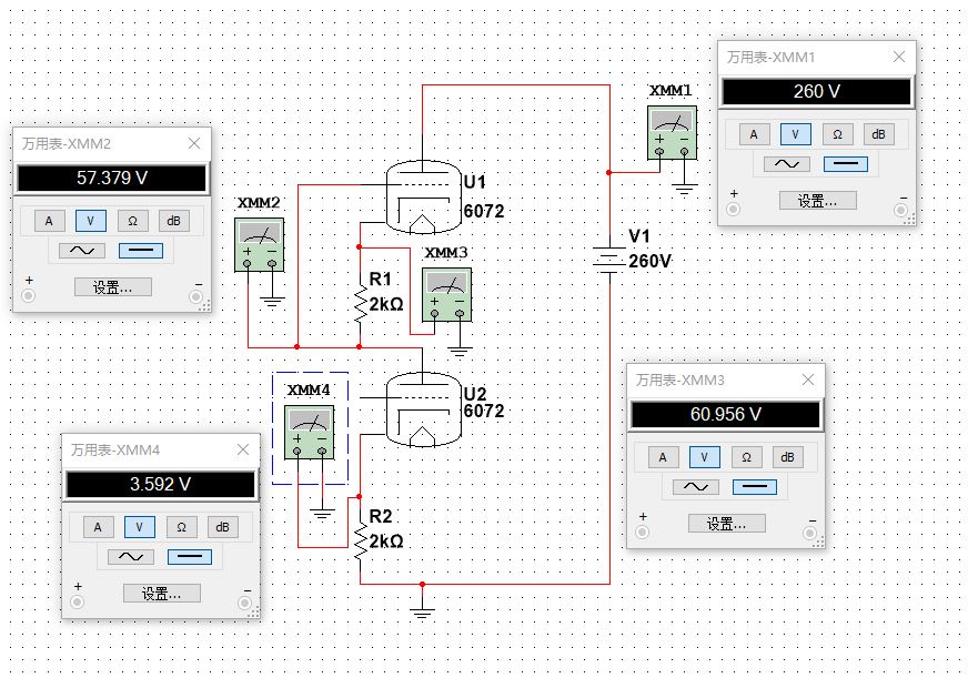

Then I run the simulation of the circuit in Multisim14, and get the voltage(relative to GND) of 4 point
V1=260V,V2=60.956V,V3=57.379V,V4=3.592V

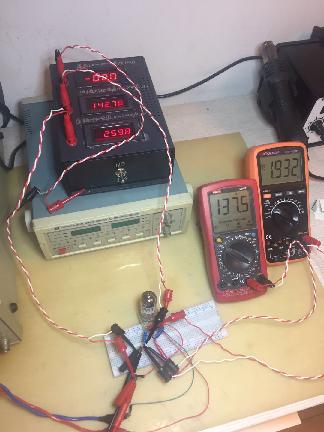

I made a real circuit of it
and get the real voltage of these 4 point
V1=259.8V,V2=142.76V,V3=137.5V,V4=1.932V
the result is quite different from the simulation, especially V2 and V3, the real data is much higher then the simulation one
Is the model correct ?

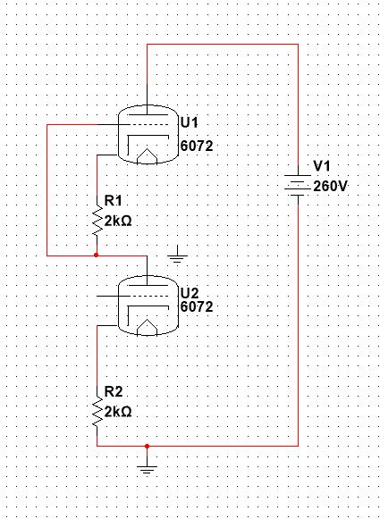

It looks like you're not feeding any signal to the bottom triode's grid.
Also, you'll want to put a grid leak resistor from the bottom triode's grid to ground.
I've never tried to run an LTspice simulation with a circuit set up like that, so I don't know if what you're doing will run. Try the above and see if you can at least get it to run.
Besides, how do you know your tubes meet the specs, did you trace them?
No, I have no equipment to trace tubes. But this is a EH 6072 and I think it's specs should not quite different from GE 6072
This circuit is part of M10, there is no leak resistor. The circuit can run in Multisim14, why can not run in LT-SPICE?

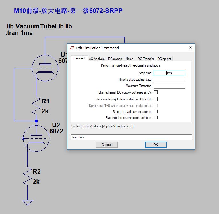

As rongon replied, you need a signal source and a grid leak resistor for the bottom triode; its grid is floating. Also in Ayumi's 6072 model, you need to change all instances of "^" with "**", minus the quotes.I try to silmulate this SRPP circuit in LT-SPICE

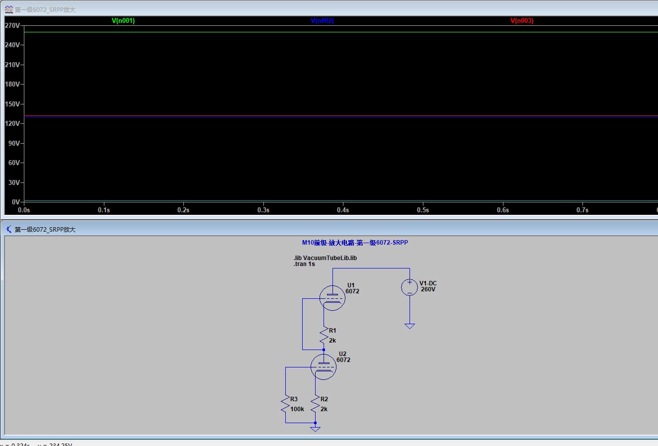

and it is the simulation sets
But it runs too slow after 10 min only finished 0.1%, is tere something wrong with the setting?
It may be that Multisim places a 1G resistor from all nodes to ground.This circuit is part of M10, there is no leak resistor. The circuit can run in Multisim14, why can not run in LT-SPICE?

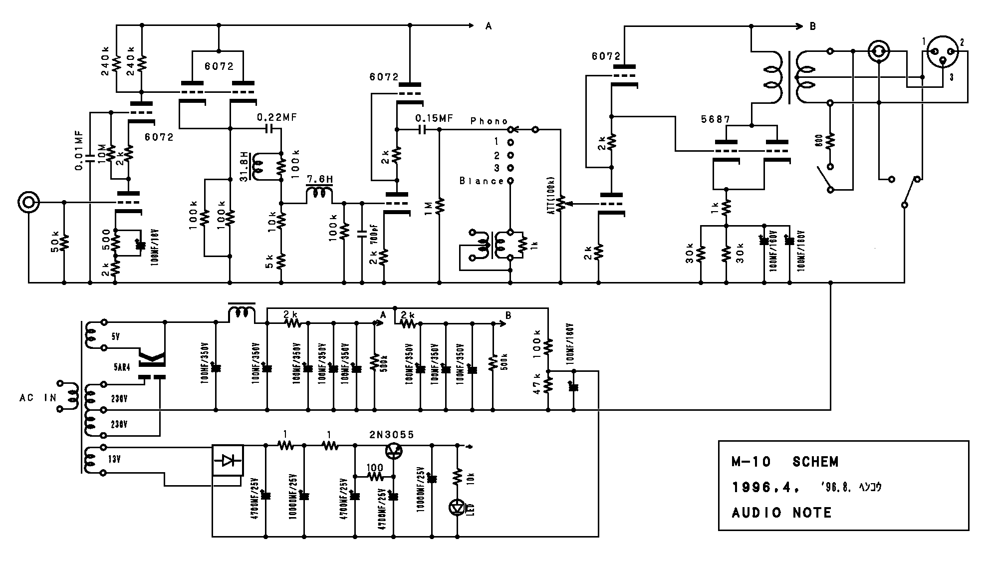

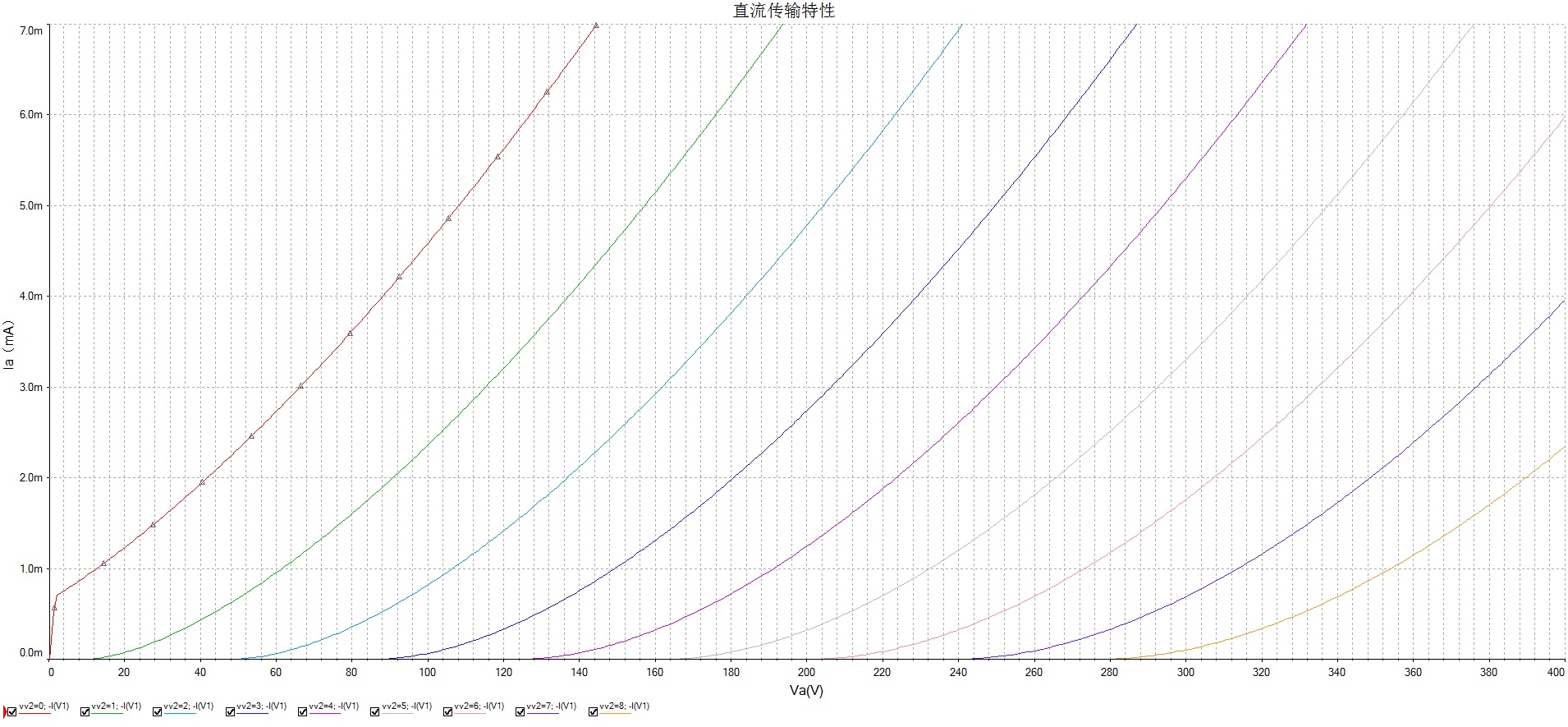

Need help: Building 5687 SPICE Model
I have succeed made the 6072 SPICE model, and thanks for the kind-hearted guys helped me with it🙂
and then I want to make 5687 model, because I want to simulate the M10 Preamp circuit. Now I am trying to building this preamp, then I want to use the model to simulate the whole circuit, it will be convinent to use it to adjust the real circuit.
But now I have some difficult with the model.

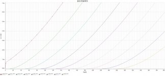

This is the model that I used Paint_Kit to trace the curve of TUNG-SOL 5687 document

this is the LT-SPCE file of this circuit, can some one kindly help me to find out the problem?
View attachment 5687.zip
and I have tested all the 5687 models found from this forum, and the result is the same.
