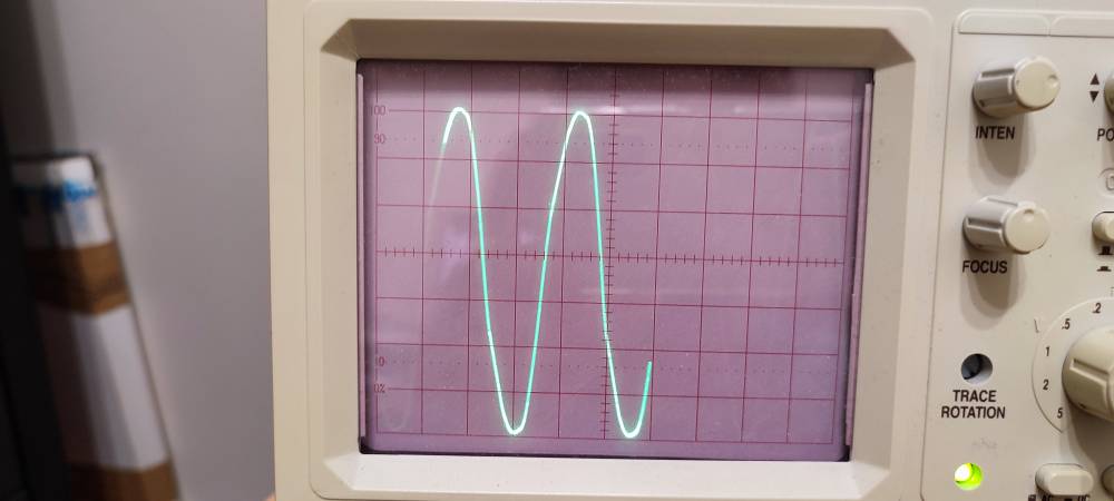

After some break for work I went back to work on this phono, I read from who built this phono that it is silent and you can't hear anything from the speakers, so it's a matter of principle and I would like to be able to locate the problem, I connected the power output to the oscilloscope with a 100x probe, the ground is connected to the frame, and here's what I see, the oscilloscope is so set up, volts / div = 0.1V, time / div = 5mS, it could be useful in the intercept the problem?
