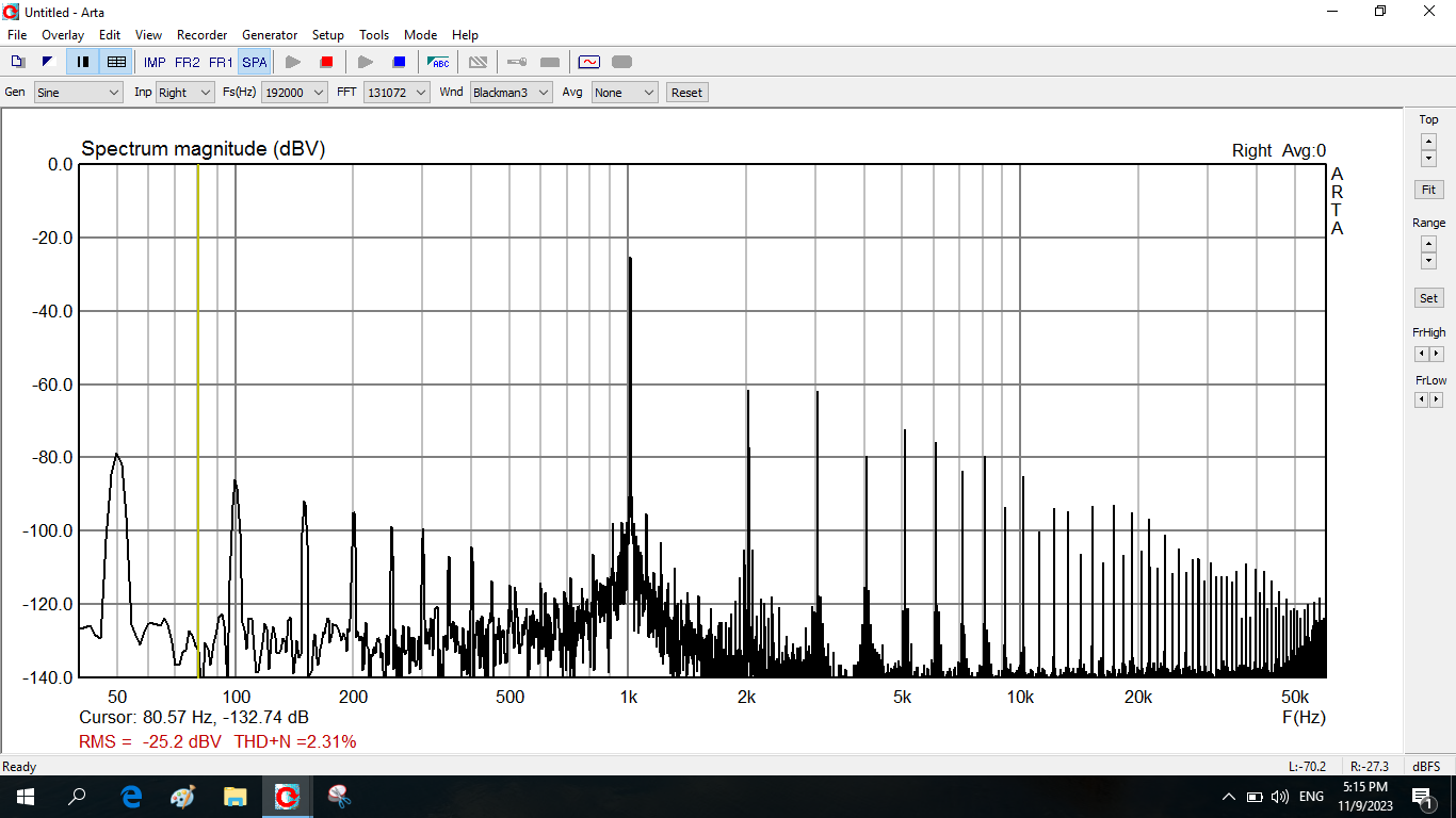

Hi guys, we refurbished an amplifier built by Audio Note kit 1 with 300b end tubes and by measuring the primary/secondary voltage ratio resulted for the 4 ohm output a ratio of 25 and for 8 ohm a ratio of 17.5 both corresponding to a Z=2.5K but THD>5% for 6.5w. Replacing the load resistor with 8 Ohm and 16 Ohm respectively yields Z=5K and THD<3% also at 6.5W. Did Audio Note erroneously show that the outputs are on 4-8 ohm, what do you think?
Look at the 300B loadline in AN Kit1 operating point, 2k5 OPT, 8R load.
No free lunch. Limited power (low Ua), high distortion, but bulletproof.
If you use higher Z output transformer (and higher Ua), the distortion will decreasing.
It's not so simple.
From the secondary to primary transferred impedance will be almost double, but OPT's primary parameters (inductance, capacitances) remains the same, so it will not really the "double impedance" OPT.

We measured the output transformer, here is the data L=16H R=102 ohm Llk=8mH and frequency band 30Hz-56Khz/-1dB and SQW response at 10 Khz so a very powerful OT Next, all measurements of the amplifier were made on a load resistance of 8 ohm at the 4 ohm output of the amplifier so that the impendance reflected in the primary is5K so the static operating point has also changed

Please tell us about the 2 screen shots:
What are the square wave frequencies?
Is that the result of the 300B driving the transformer?
or, is that a signal generator directly driving the transformer?
If it was a signal generator directly driving the transformer, what was the signal generator's output impedance?

Sorry, thease are SQW measurment,first picture only the transformer and the next at the out of the amplifier
I hope the images will be clearer, the frequency is 10 Khz and in the case of OT measurement the signal is introduced secondarily with the help of a 10w SS amplifier whose output impendance is very low, so a 0-20 ohm rheostat is introduced adjusted so that the impendance is 8 Ohm. The primary section is closed with a 5K load resistor on which the oscillogram is read
