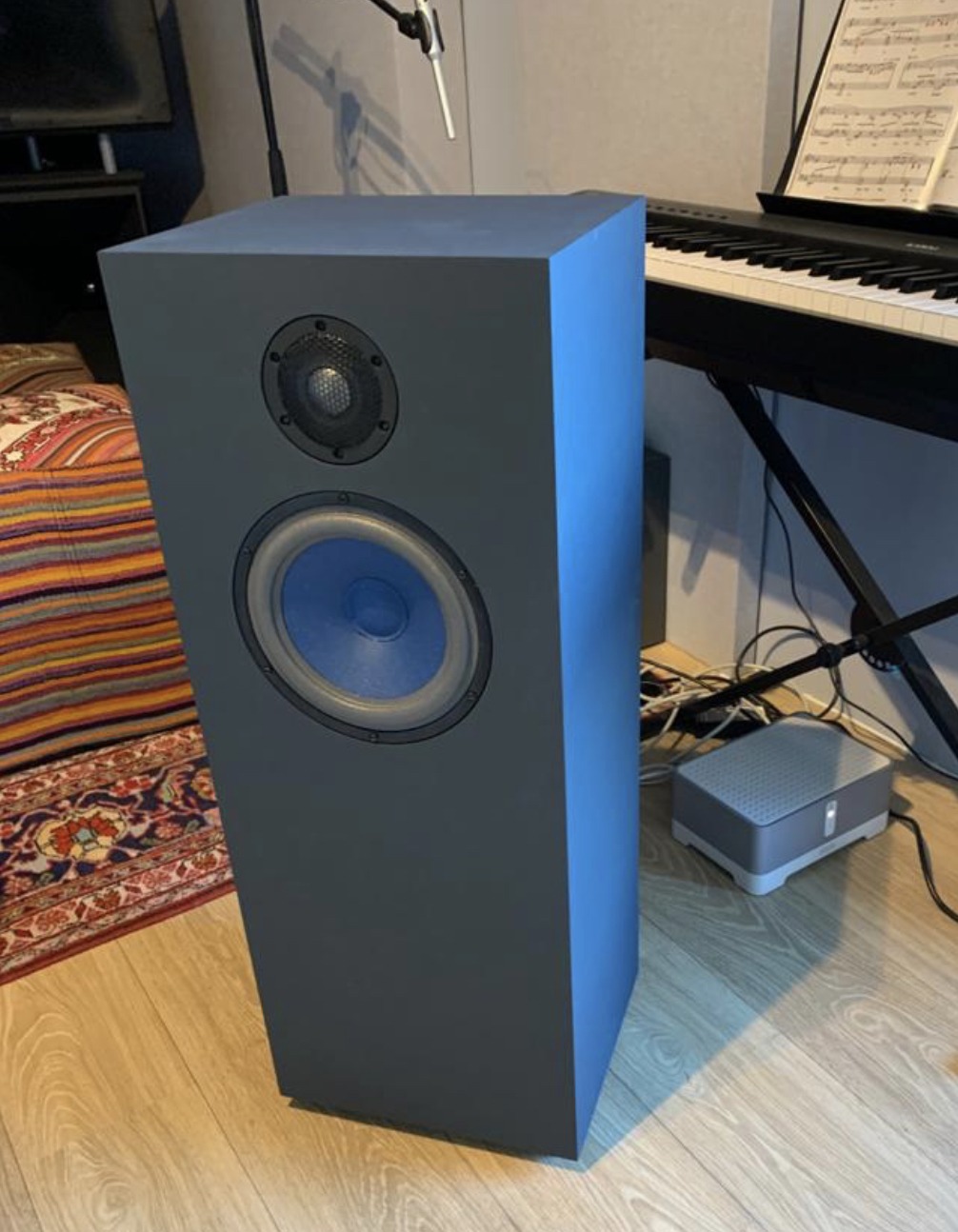

I did it. Next week a pair of Blue woofers are coming.

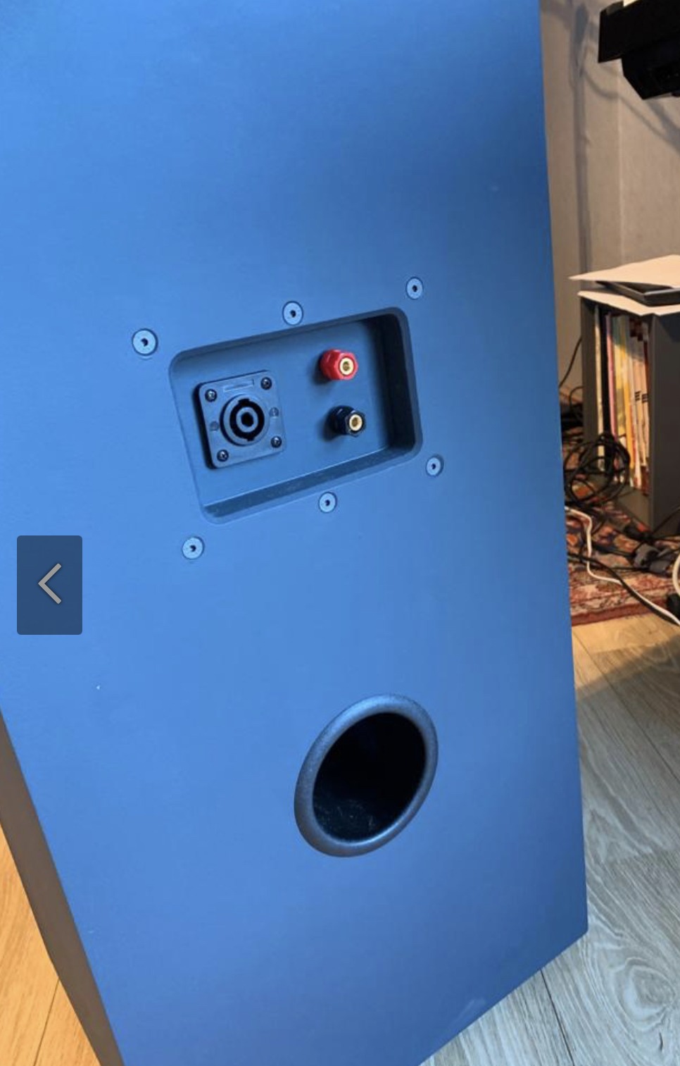

I will have biwiring terminals. Not because i think such things are neccesary (neither cables).
But i will have the option to crossover active and have a «outboard»passive crossover box.
Since i will use Bliesma 34 mm beryllium tweeter the passive crossover have to be made from scratch. This tweeter are capable to cross as low as 1300 Hz. My target is probably 1600-2000 Hz.

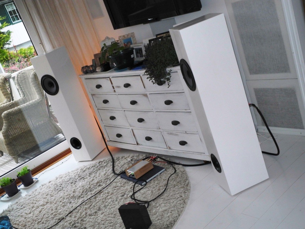

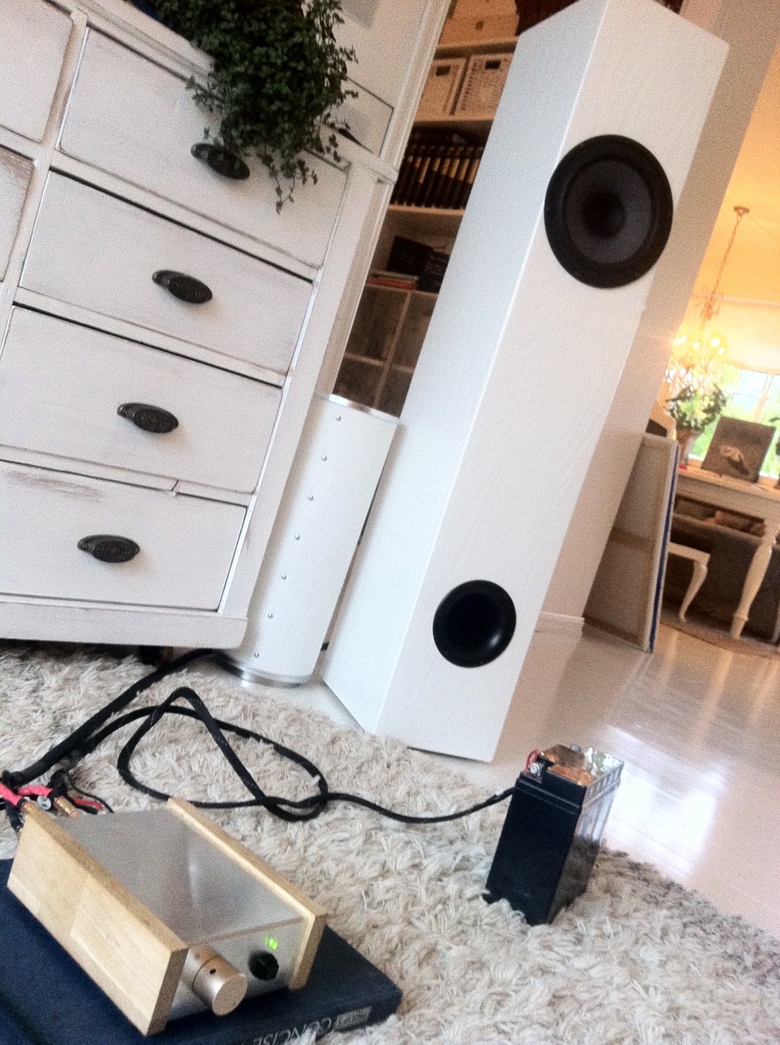

I think FA22 is a better driver. Due to the small voice coil it dosent handle that much power so be a little careful
Yesterday i ordered a new pair of FA22 and will use them in this thinwall cabinets without tweeter
For 10 years ago.
FA22 in MLTL. Bob Brines helped me to simulate.
https://www.hifisentralen.no/forumet/threads/seas-fa22rcz-fulltoner-i-mltl.51998/
I made them a little more narrow with a «party peak bass tuning». It works very well with small T-amps.
