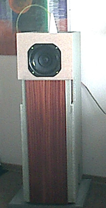

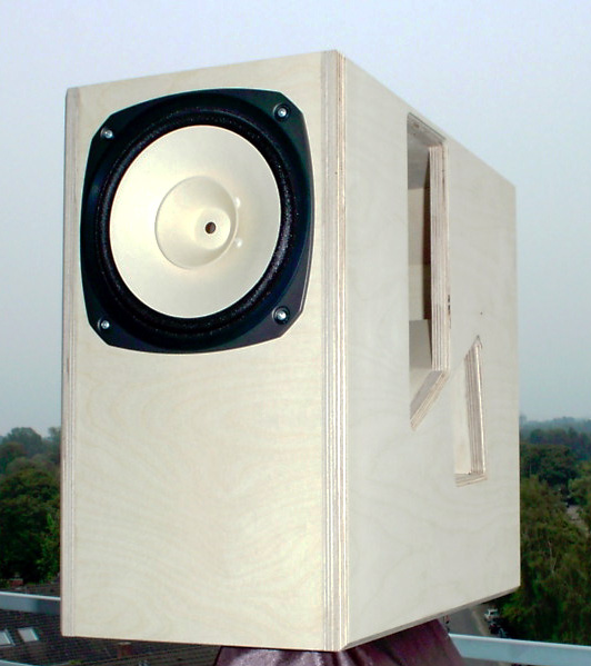

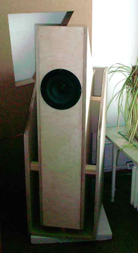

look my double horns:
SAXOPHON
RDH20
or the sats :
SCHALMEI
TRUMPET
HORN
all available for the AN8" family.
