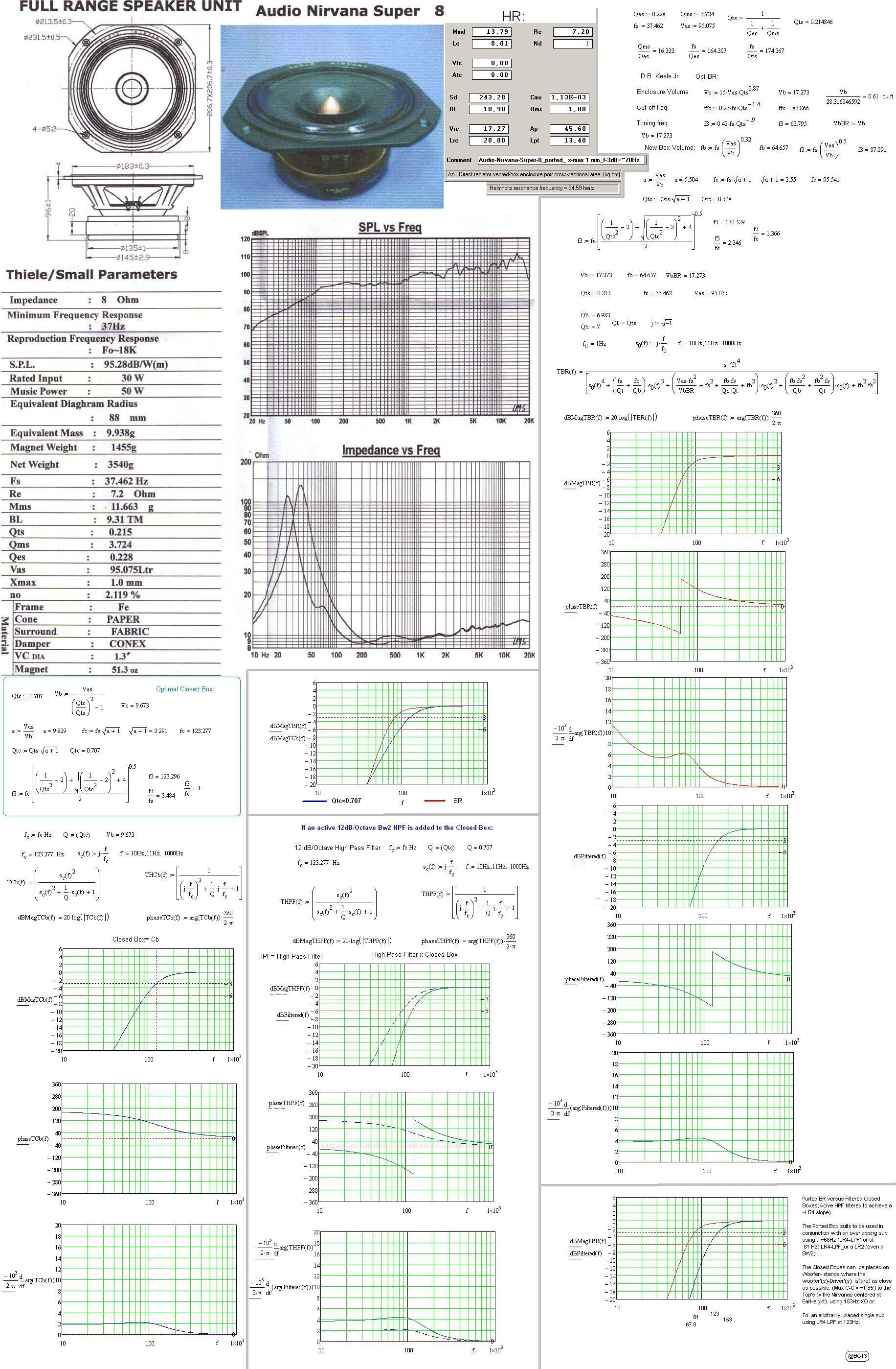

I like to build for my Audio Nirvana Super 8 a vented cab and (the monitor )from common Sense Wyatt Acoustics CommonSense Audio Monitor (pair) shows be a good compromise.
Can someone tell me how are the dimensions of the vent tubes?

For a flat response with those drivers (from memory) they don't go very low, and the box on the audio nirvana website looks really big for such a response. You should get a program like winisd or hornresp etc to find the tuning that you think is acceptable.
