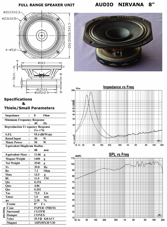

In the Audio Nirvana datasheet is write "Kraft" in the voice coil information.
The audio Nirvana use paper voice coil former as the old speakers ?
See here:
http://www.commonsenseaudio.com/an8stdspecs.jpg

Searching on Google for KSV VC seems it is a usual material in pro audio speaker, so it is not a fragile material as it would looks.

It make sense use oldfashioned Kraft VC, in the Nirvana fullranges, as they are a classic (small Xmax) project.

Paper, yes

The paper is the best material for the voic coil former, but do not support very high temperatures.
