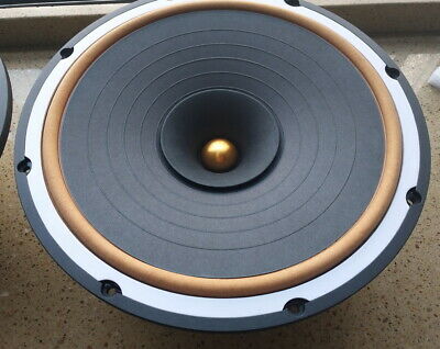

I too was going to buy the 12” Super Ferrite but I won’t pay the Trump tariffs. Instead I recommend looking on eBay for drivers direct from Hong Kong, from DavidLouis, there are some very nice looking drivers there that I think are worth trying.
2 unit DavidLouis P12 hiend 12 inch fullrange full range speaker | eBay
I was going to pick up a pair whilst I was in HK last week but didn’t have time.

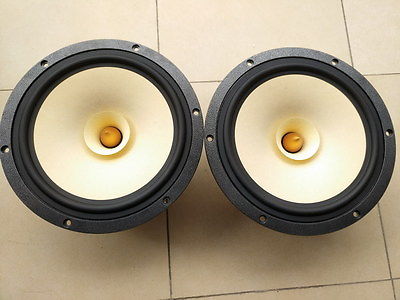

also:
pair 2 unit HiEND 8inch fullrange speaker 97db PK lowther KO fostex | eBay
2unit DavidLouis diatone P10 hiend 10inch fullrange full range speaker pair | eBay
also:
