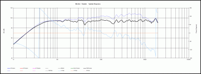

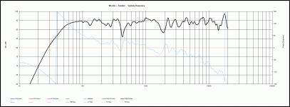

Lastly, a second attempt at the AN10 classic. This uses an additional Parallel filter (so at least not in series with the driver) to preserve the high end. No super tweeter need apply, but I'll not speculate on the treble from a 10" driver until I've heard it for myself. 🙂 This one MIGHT get away without an impedance flattening circuit.
It's hard to say since I don't know how much gain the cabinet is providing; having studied MJK's BLH papers, I know that the gain is very much dependent on the Qts of the driver. If the AN8 truly has a Qts of 0.28 or thereabouts, it probably needs the full amount I gave in my simulations above but if the Qts is higher it might need less. If you actually build that filter and it turns out to be too much, I can easily go back in and adjust the values. It might be as easy as reducing the resistor in the BSC circuit but the contour filter might need additional adjustment as well.

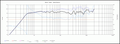

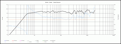

Freddi, thanks for posting a measurement of the super 10. Just to see what would happen I copied your graph and it looks as though a simple 2.2mH/8R BSC circuit would go a long way toward balancing the response. Listening off axis would be enough to compensate for the rising high end, and I wager that ~5db peak at 3k is more annoying, so I tried to filter that out instead. With the filter in place less BSC is needed so the resistor drops to 6R. In total, 2mH/6R BSC, 0.15mH/15uF/12R notch filter, 15uF/15R zobel. PCD7 thinks that 5-10 degrees off axis will balance out the top end.

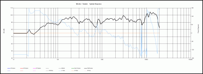

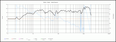

I spent some time playing with the simulation this morning and made a breakthrough: my adding a capacitor to the BSC filter I can do away with the second series filter, making the AN10's filter much simpler and cleaner. Here's the final circuit and frequency response chart. It's easy to tune the response: if you increase the value of the series filter cap, you get more treble in the 6-10k range; if you decrease it, you get less. The simulation is for a 120L box 12in wide tuned to about 50Hz, and I factored in about 3db baffle step. I'm going to go back now and see if I can do something similar for the AN8.

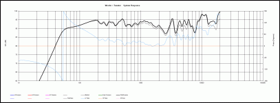

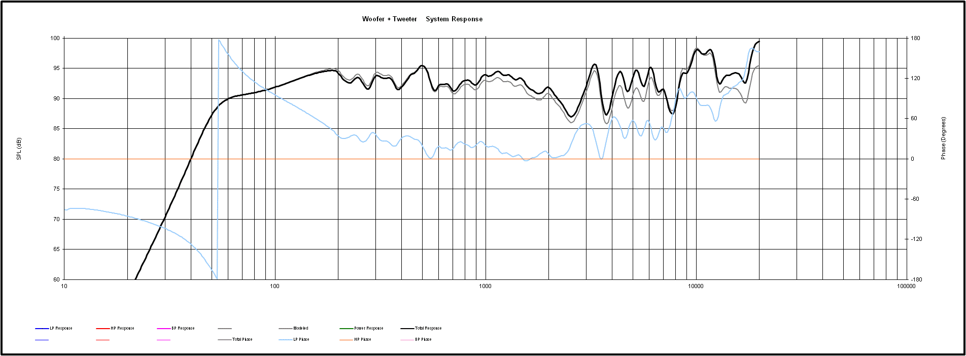

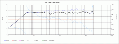

Success! Here's a simpler and more effective circuit for the Classic 8. This one retains even more HF extension than the old one and doesn't require the addition of a zobel at all. the impedance follows a gentle arc from 8 ohms up to 14 and then back down, while the electrical phase remains very smooth so no problems for tube amps. In one picture you'll see a comparison between the old filter and the new filter (old is in gray).
