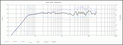

Hi guys, I'm a little late to the party but since this doesn't really deserve a thread of its own, I'm posting it here. I've been rather interested in the "classic" driver series recently and subsequently done some work on filters. I've found the AN10 to be easier to work with than the AN8. Here's what I've got so far. This simulation incorporates full baffle step, which I modeled for a 90L bass reflex cabinet 11 1/2" wide. One element that most purists will reject is a 3-4R series resistor which helps equalize the low end and will result in better bass extension. The driver would still achieve some 95+ db efficiency after accounting for baffle step. Apart from that there are two series filters: a 2.2mH/8R BSC circuit, and a 0.5mH/1.5uF/20R LCR filter for the top end. There's lots of room to fiddle with numbers, but in the pursuit of equalizing the lower treble, some of the energy between 10-20K is lost. I think the AN10 would require a super tweeter to sound its best in this configuration. Will this rob the AN 10 classic of all its "life" and "presence?" No idea, but I hope I get to find out someday. Since the dust has barely had a chance to settle on my new 2-ways, I had better not be finding out for a year or two. 🙂

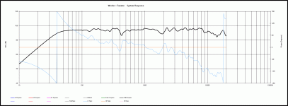

Same thing for the AN8 classic. This simulation is for a 40L box tuned to 50hz IIRC. The higher the actual Qts is with this woofer the more bass you'll get, of course, but I assumed the figures on the commonsense audio page to be accurate. Filters are: 2.5mH/15R BSC circuit; 0.3mH/2.2uF/20R EQ circuit. I forgot to mention that both drivers would require a zobel to tame the rising impedance with these filters. In the case of the AN8 the values are 25uF/11R. The end result is a solid 8 ohm impedance and ~92db efficiency, with bass down to about 55hz. In the graph you can also see the unfiltered response for comparison.
Edit: Added impedance profile with zobel in place. Note that the zobel has to come before the filters, not after.
