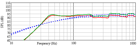

Scott has provided this:
Use at own risk, given AN's questionable specs. This is based entirely on their published figures.
L = 70.5in
St = 6in x 6.25in
Sl = 12in x 12.5in
Zd = 35.25in
Vent = 5in diameter x 0.75in long.
Stock: Green, with high output impedance amp: Red
dave
L = 70.5in
St = 6in x 6.25in
Sl = 12in x 12.5in
Zd = 35.25in
dave

planet10 said:for std 8:
L = 70.5in
St = 6in x 6.25in
Sl = 12in x 12.5in
Zd = 35.25in
Let's enlarge 8% then:
L = 70.5in
St = 6.5in x 6.75in
Sl = 13in x 13.5in
Zd = 35.25in
Vent = 5in diameter x 0.75in long (the box is bigger so this will tune lower (i think)
Thanks Dave and Scott!
