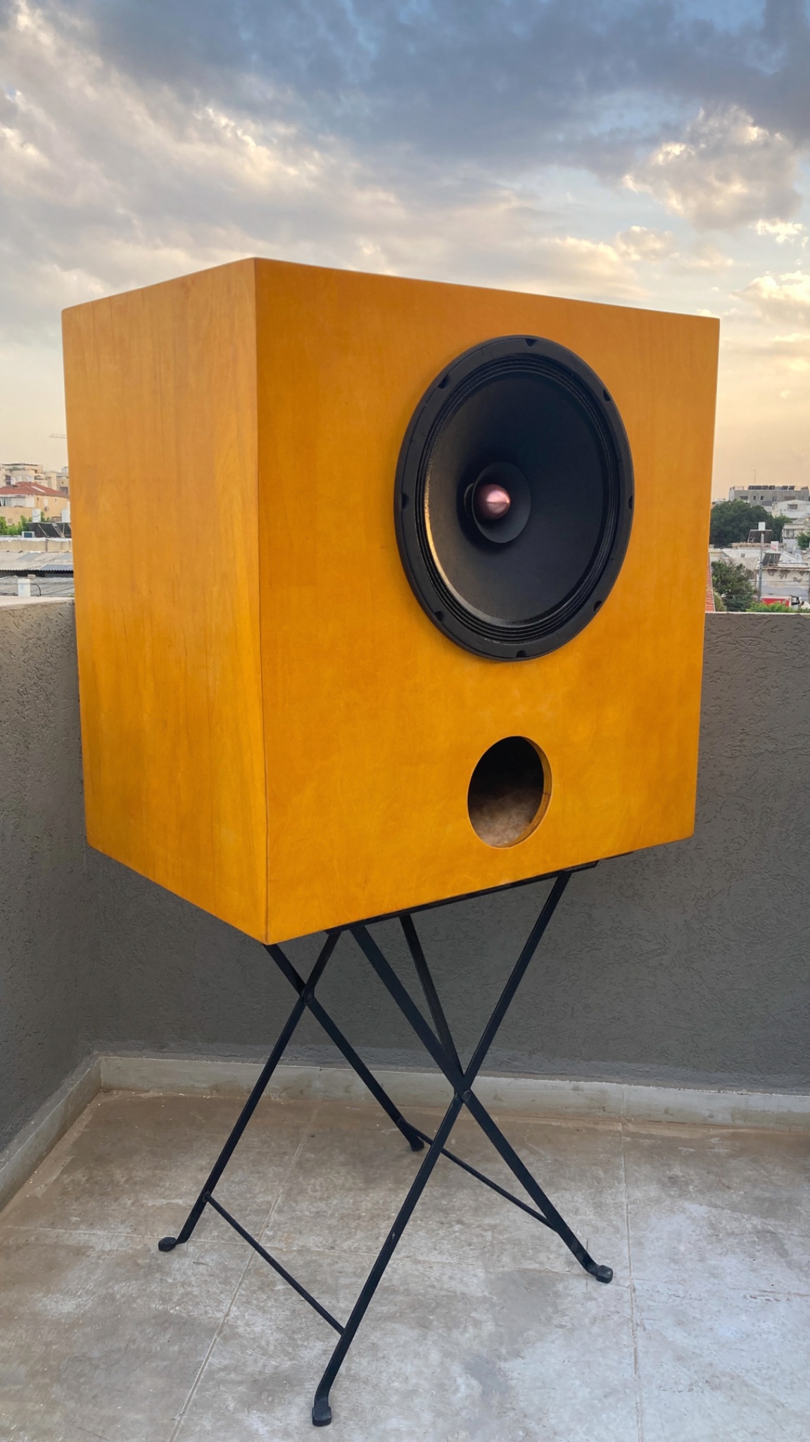

So I decided to build a stereo system using the latest AN ‘15 drivers. It was the biggest cabinet I could make for this project, no esoteric cables, everything was pretty basic as recommended by AN owner David Dicks, but the sound of these drivers in my speakers without any burn-in time was very impressive on my roof. I made these speakers for a public place for use with a €700 receiver and a nice vintage Technics SP-20 direct drive in my custom plinth with vintage Victor UA-7045 long tonearm and a Fidelity-Research MM cartridge and modified Grado phono stage. This is how the system is used now in a Wine Bar.
This is a picture of my DIY speakers with latest AN ‘15 drivers.
First I tested the speakers on my roof with bran new Audio-Technica Sound Burger portable turntable with built-in phono stage, even with its conical AT stylus the sound of AN ‘15 in my cabinets was so pleasant to my ears, I was sitting there with a smile on my face for several hours listening my vintage 45s (Funk, Soul, Disco, R'n'B, Latin from the ‘70s era). There was no need for the super tweeter in the sweet spot, the bass out of my huge ported cabinets was deep enough and sweet. I was happy with the result and I highly recommend these AN ‘15 drivers in 2025. No matter how these drivers are measured, the sound you are getting in a nice cabinet is nice and warm! If someone can work properly on a cabinet design then it can be even better, but as David said the driver is forgiving to a cabinet and can work well even in a much smaller size ported box.
