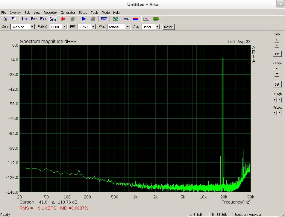

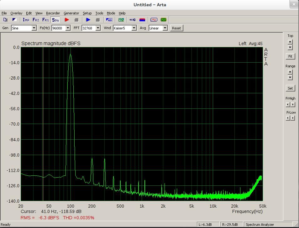

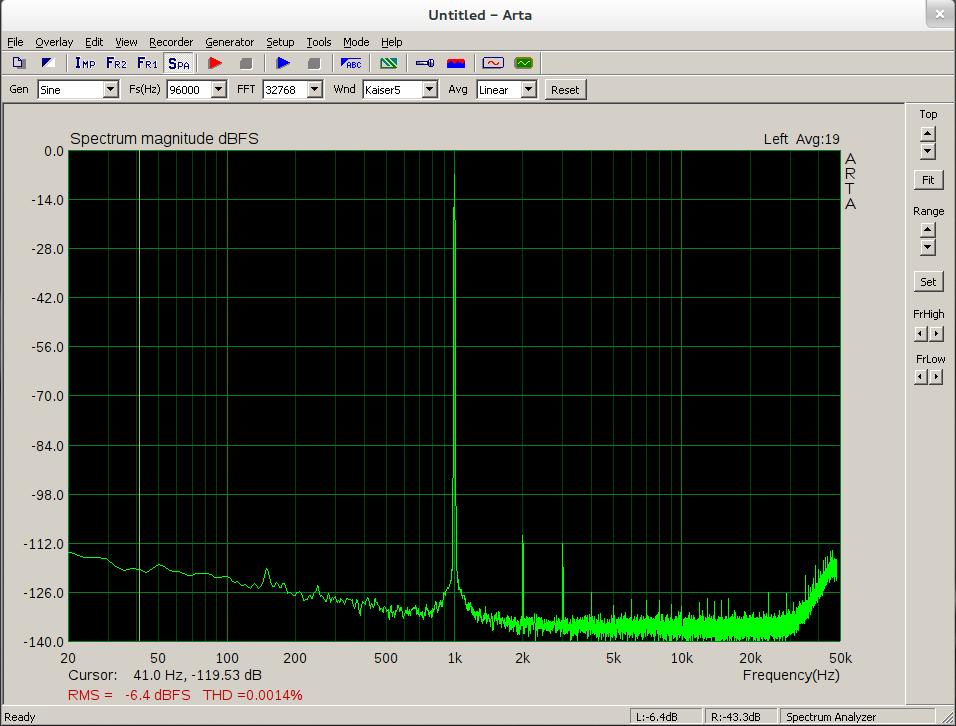

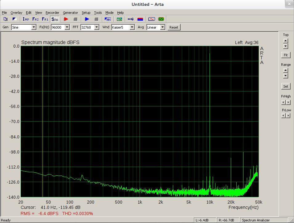

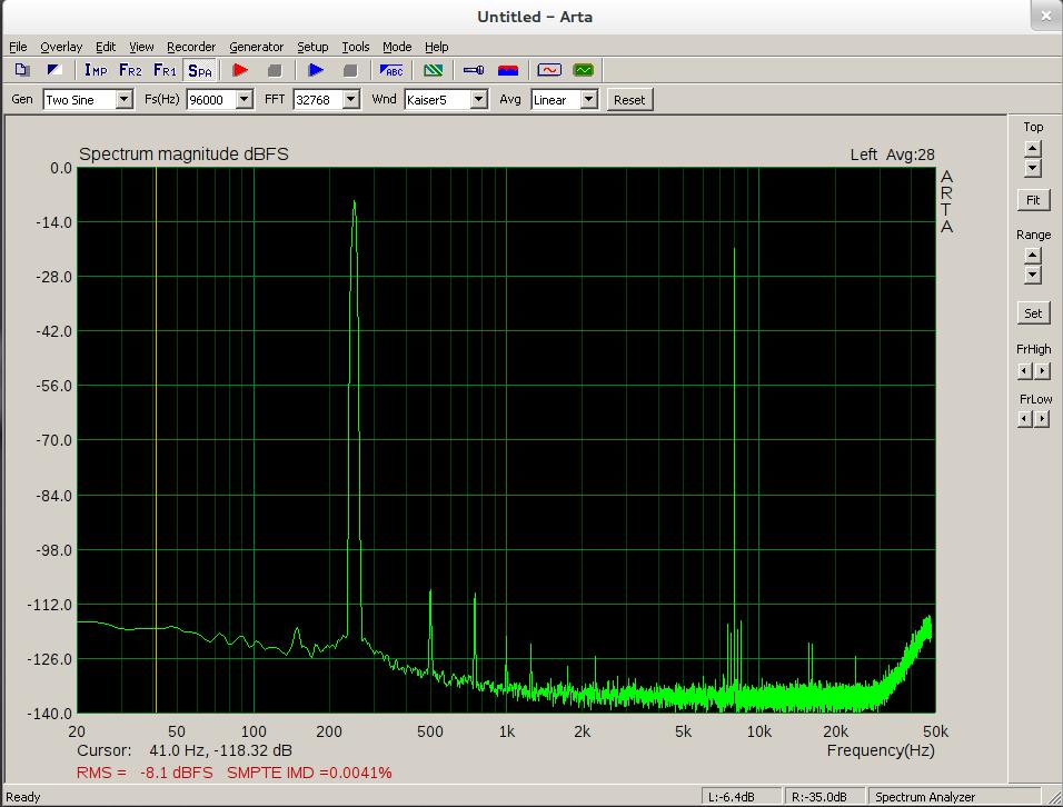

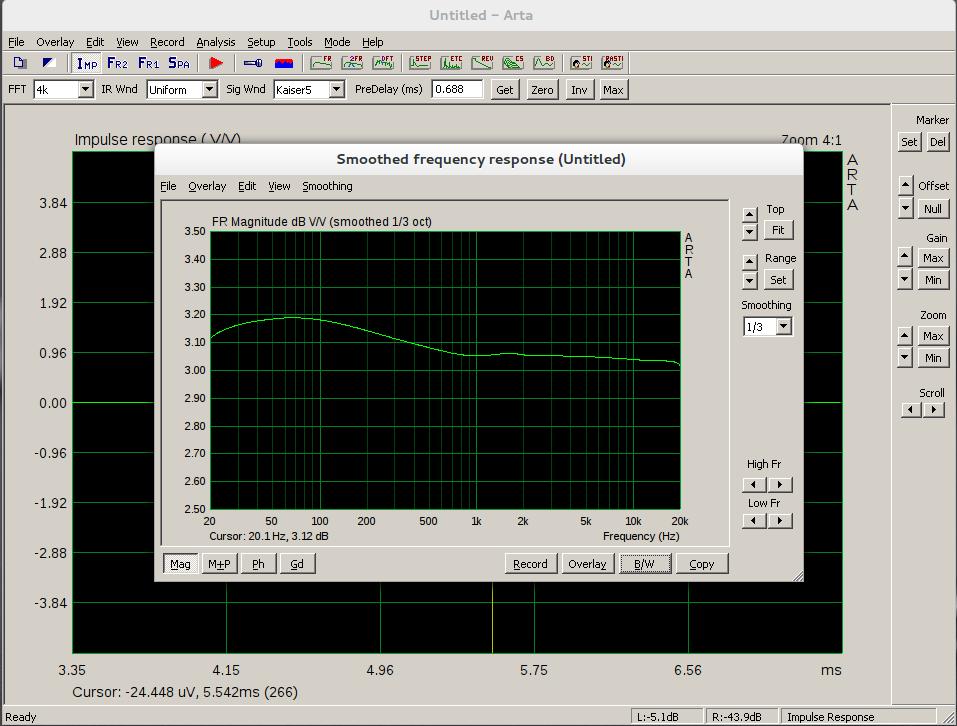

Audio measurement using Arta under Linux
Several THD plots in loopback mode.
