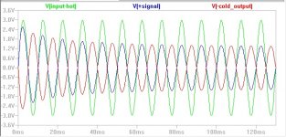

Here my schematic for Pro Audio Amplifier Limiter.
The idea is using P-JFET with biased continuously to perform continues attenuation in the linear area, to perform like class A amplification but in opposite function as attenuation. As it is attenuated then it produce small signal voltage then it is amplified. The result looked like very good, fast and linear.
Comment and suggestion is welcomed.

Simulation, input 3V

I built limiters using much the same circuit back in the 1980s, but your circuit is missing:
1. Full wave rectification. Just replace the diode with another transistor, common base. Add an EF if you want to balance the two phases.
2. Optimize the FET linearity by adding 1/2 the audio voltage to the gate voltage. This is available by splitting the lower resistor in the op-amp feedback.
The attach time can be faster than the first 1/2 cycle of audio but that may not be the desired result.
