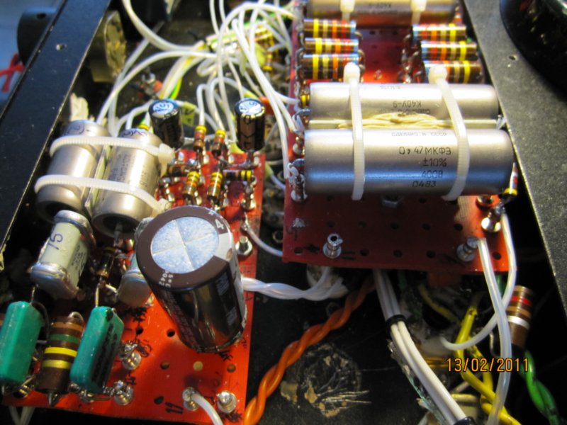

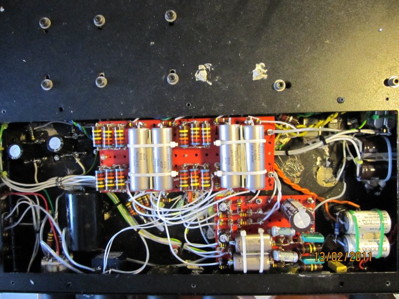

Good God, I remember referring this thread when fixing my friend's AI500
not much to fix 'n tweak though, change the selector to alps, several lytics to cerafine black, 0.22uF green ero input cap to light blue ones.
How does your mod now sounds advr? also what is your recommendation for the 2 220/400V big caps?

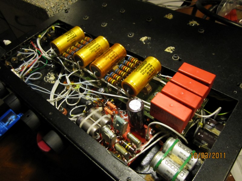

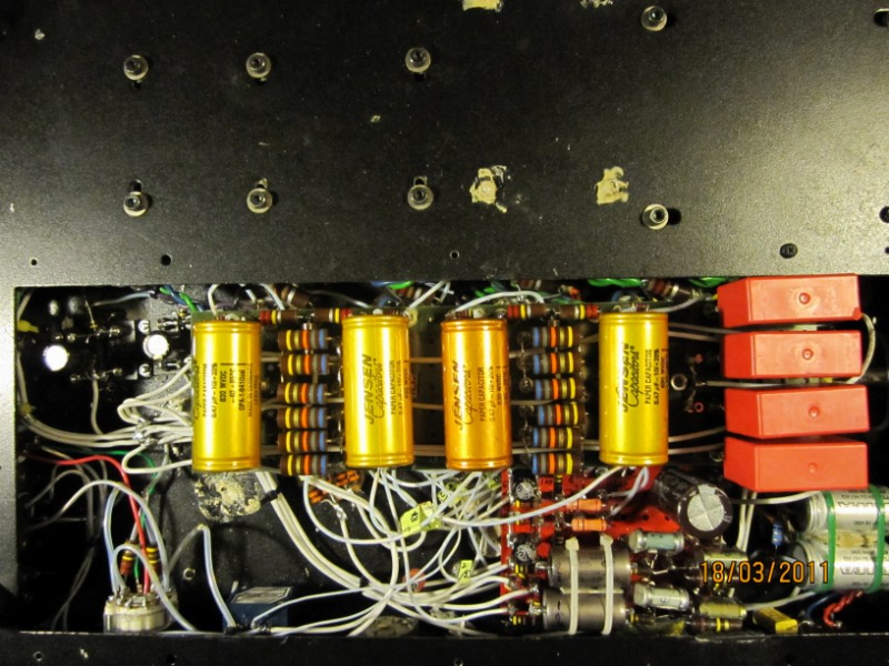

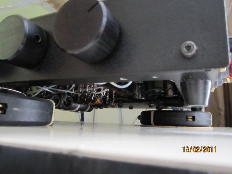

hi,
A month later and my Ai is very different as well....
many caps are now Jensen paper in oil.
which one do you mean?
There is nothing left (only the trafo's) from the original anymore. earth scheme is totally different , all in a star to one point with thick cable. All hardwired.
It's sounds superb. There is much more control, depth, 3D, baas, sweet high. No disturbtion at al. No rumble and noise at 10 cm from my tweeter.
I like it. There is stiil much to do but I like it.

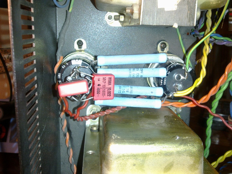

the two lytics after the power transformer, congratulation with your tweak btw
they where changed also with 330uF 450V Nippons also the rectifier changed to real diode network😀
also changed the one Resistor to 4 pieces parallel .
much work.
thanks advr, I still remembered that dusty caps, I think I'll use same diode, tfk sf4007 or similar. With so much of your mods I'll be surprised if the sound stays the same 🙂
hi,
The dusty things where in place from 1987... I have an early AI 500 MKII Ed de Jong told me that once.
Of course the AI sounds different now then a couple of years ago...😀
But then not quite different.
The scheme is still the same but now I have a better earth scheme, all to 1 point. All capacitors are new with somewhat greater value and more voltage headroom. The components have better specs and all is hardwired.
It gives much more control, the easyness of the music (sorry for my english), depth, 3d. Music comes more alive.
Of course I tuned the sound a bit for my own taste and the acoustics of my listening room. But I already did that whith tuberolling😀
But the 8 W (triode) gives now so much more power and less, less distortion at higher sound levels. Also now noise at the Esotec tweeters and only a minimum hum at the woofers. That are the benefit of a good earth sheme!
Even Sjostakovitch, Bartok, Mahler, everything is in place and stays in place how hard it goes...🙂 But Pat Metheny is also playing smoothly in y room... I can almost touch him.
So, yes the sound is somewhat different but not much more then with tuberolling.
