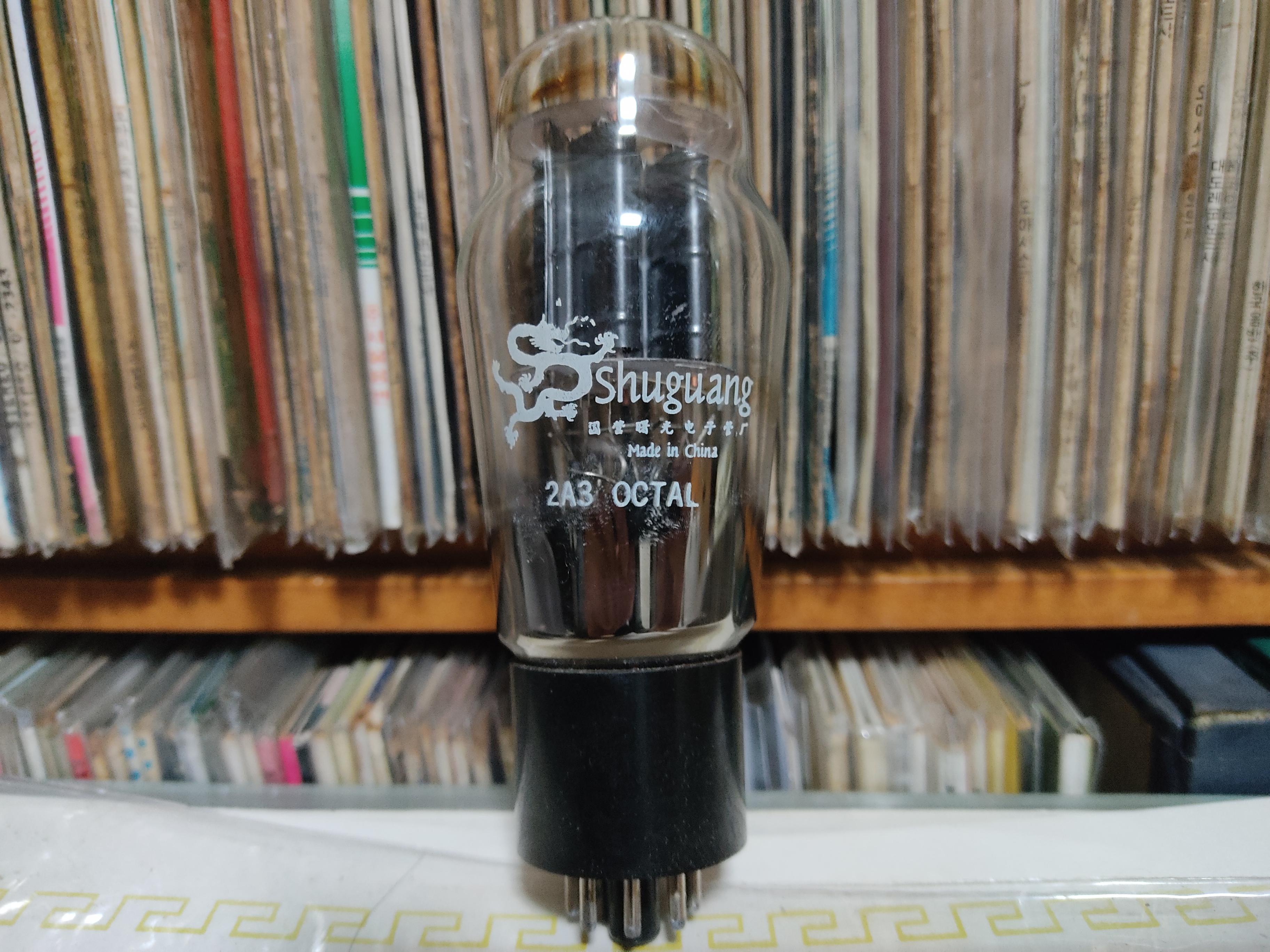

About 30 years ago, I have bought AI Series 1000 Pre-amplifier, and Second Audio 2A3 8-pin version Mono Blocks.
During last 30 years, I enjoyed the sound quality of the system with great satisfaction, but recently the system started to show its age.
Loud hums and noises when powered on, which made me think of the valve replacement. Then I found that 2A3 valves on the mark are 4 pin based.
To bring my system to the repair shop, it might help to replace sockets and valves if I can bring the schematics of AI Series 1000 Pre-amplifier and Second Audio Power Mono Blocks, since Audio Innovations products were not popular in my country, South Korea.
Is there a way to get it?
I hope I could get some help on this.

Power supply electrolytic capacitors that old are always suspect, when hum develops over time.
No ifs, buts, or maybes the 2A3 has never been anything other than UX4 based. The 6B4G is Octal based and, except for the base and filament voltage, electrically equivalent to the 2A3.
