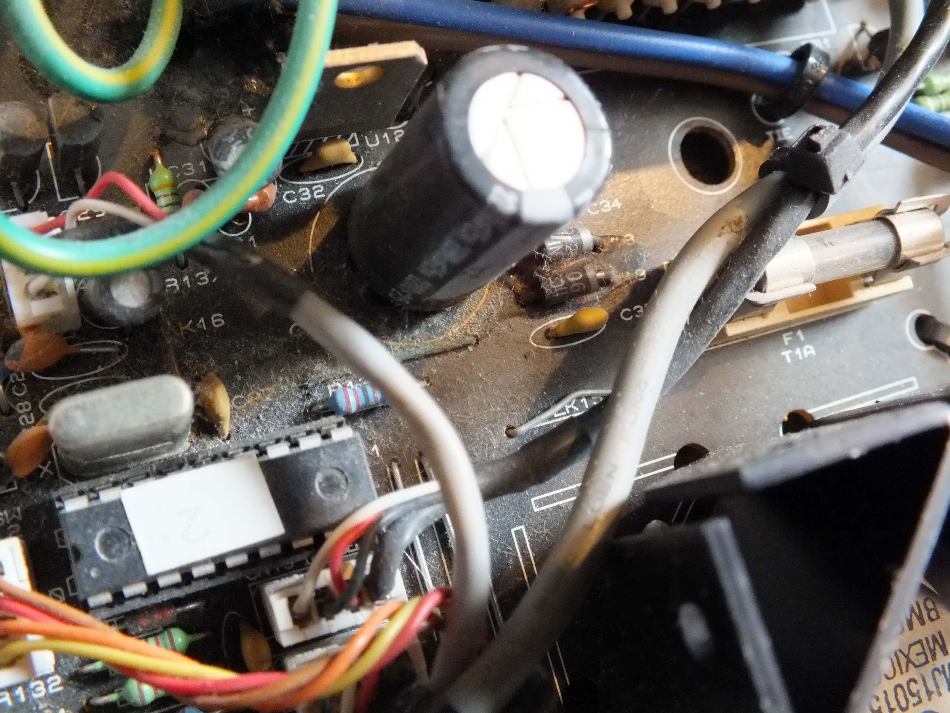

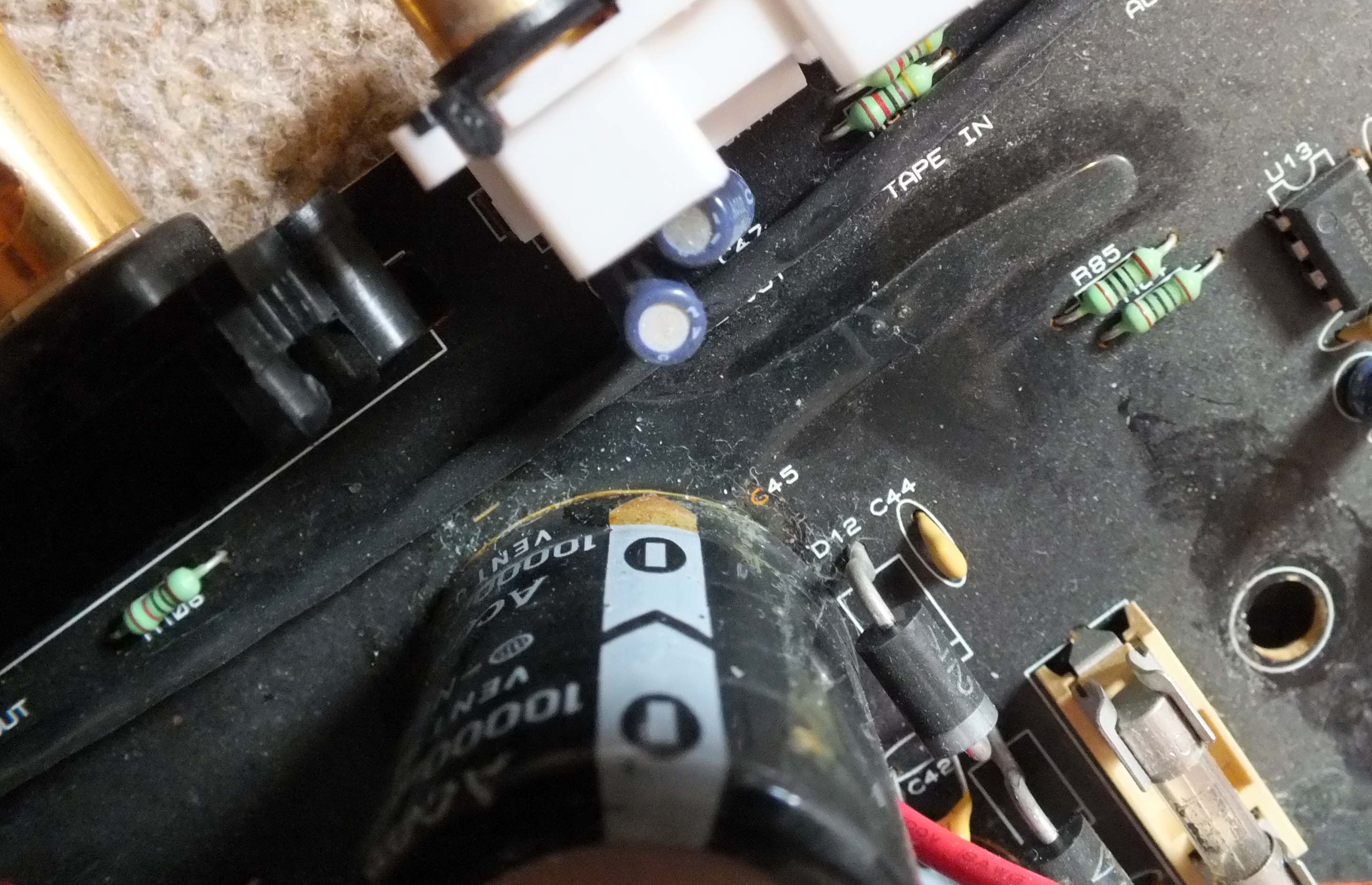

I'm assuming the 'rust' stains around the 2 main filter caps and a smaller cap near the processor chip are signs of leakage.
I might replace these and see how the unit functions before doing anything drastic - the filter cap near the processor might be causing the processor to not work correctly.

Pic of leaking main filter cap, its neighbour is similarly afflicted.
Photo of filter cap by the processor chip.
The speaker relay is adjacent to the speaker terminals and operates every time the source switch is moved.
There is a second relay adjacent to mains in. I would guess the yellow transformer powers the processor and the relay supplies power to the main toroid once the processor is up and running. Possibly also standby & on functionality through the remote but I don't have an AI remote I cannot verify this.
The NJU7311 input select chip can be seen adjacent to the inputs followed by a pair of +/- regulators & op amp buffer. The signal must then go to the front of the board for volume & balance before hitting the power amp.

Cap replaced near 5V regulator (pic 3). Though TBH I don't know if that is leakage or just icky glue.
All chips have 5V on Vcc pins.

Have you cleaned all that gunk Off form around the processor?
Could well be messing with the oscillator.

The black cable feeding NJU7311 is serial Data one of those wires is chip enable to pin 13 and should be 5V.
