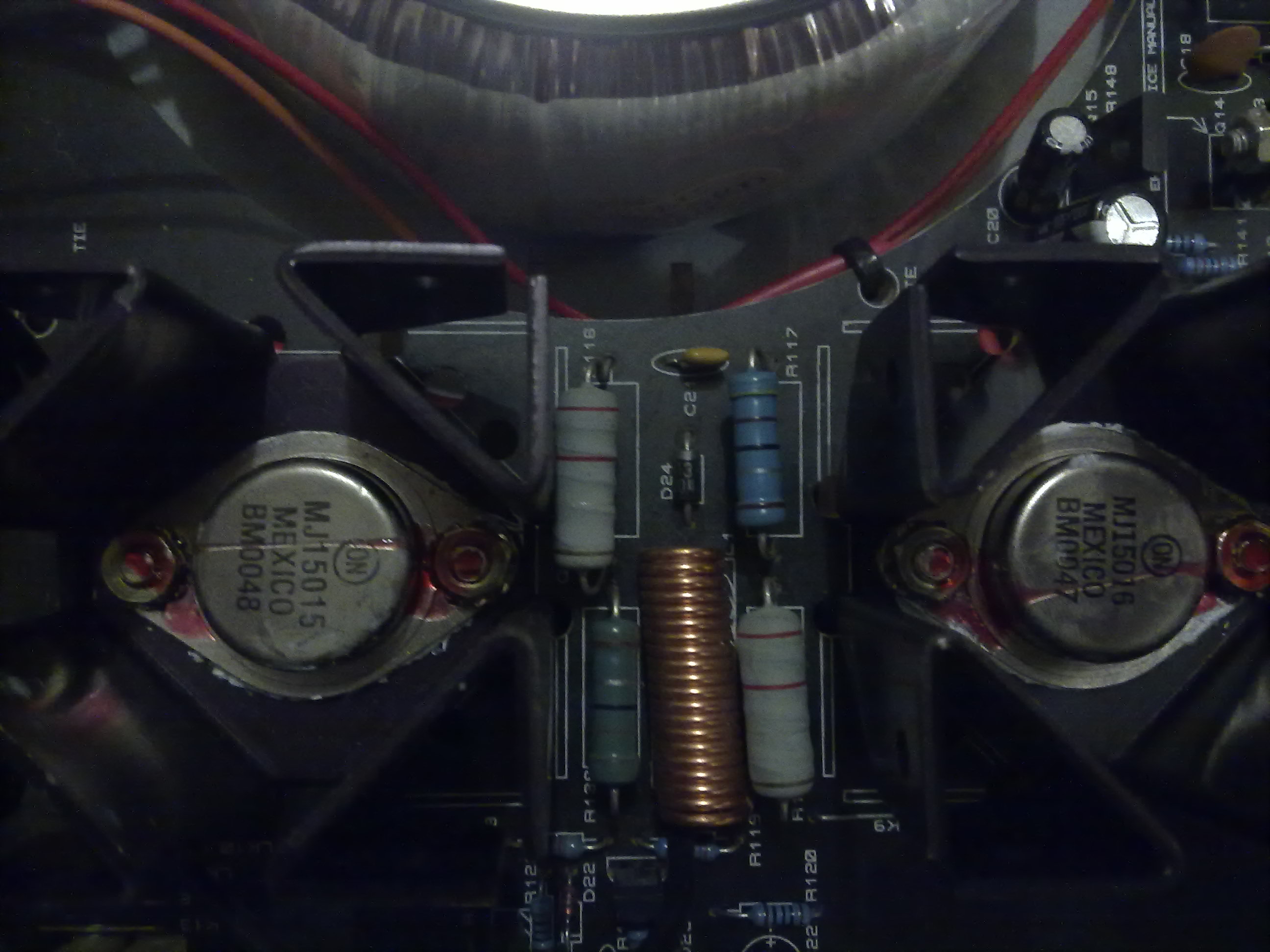

I bought one not working and on inspection found previous repair bodging that had damaged a number of pcb tracks and very bad soldering where new transistors had been installed + some wrong equivalents. Anyway cut a long story short - fixed all that re-wiring tracks as necessary, replaced all the caps etc and got it running and sounding OK.

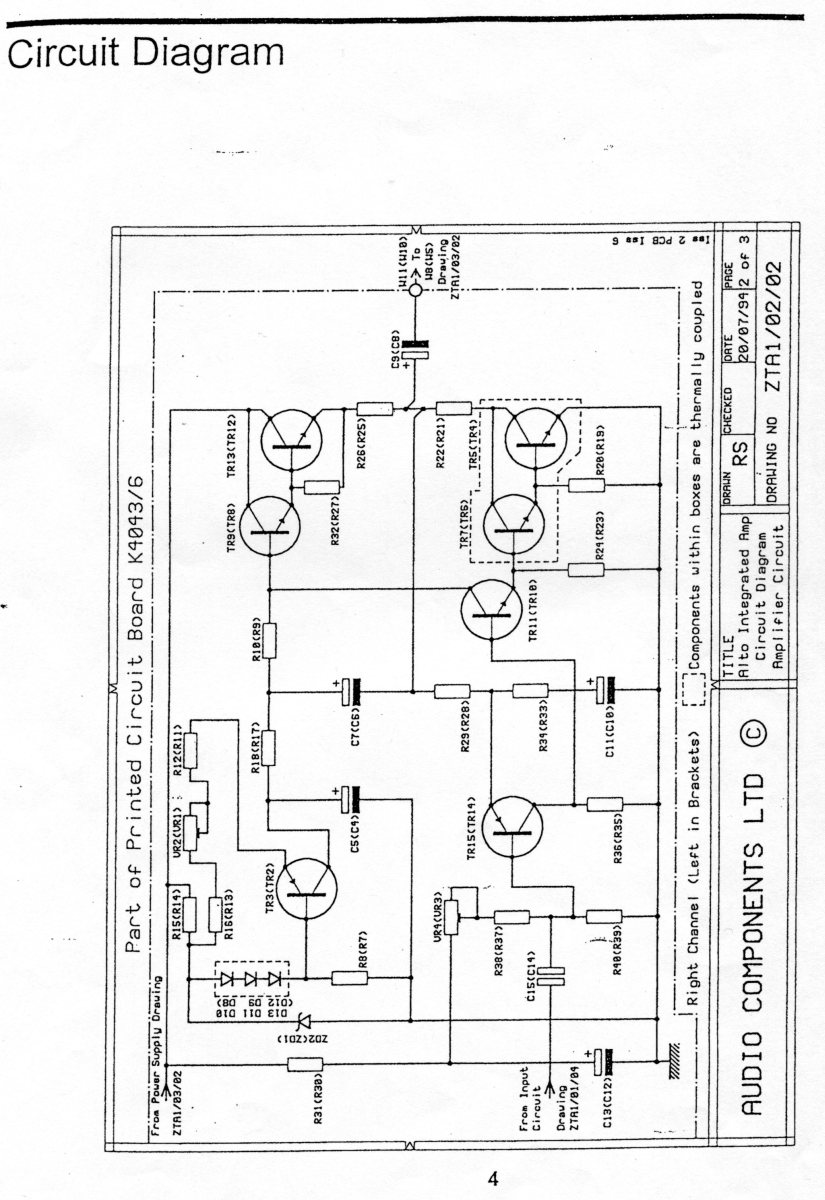

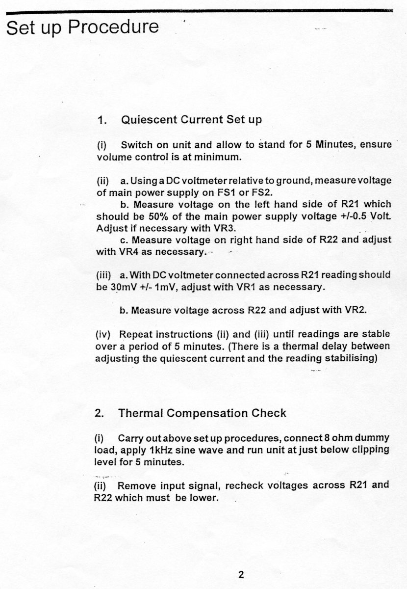

Problem is I can find no information about setting the bias and normal procedures for what I presume is a fairly standard class B design don't seem to be working. There are two trimmers per channel and I would normally expect one to control DC offset and one bias current. The amp runs ok and doesn't get too warm if I leave them as found but that gives output offsets of 200 and 500mv ish. Adjusting the trimmers will get that down to near zero but then the output transistors get very hot, very quickly and Collector current is climbing indicating runaway.
Only unusual design feature I've noticed is 3 (i think) signal diodes arranged in a sandwich between pcb and output transistor heatsink. N.B. Each transistor has separate board mounted sink with bias transistors attached. What's that about?

THIS is actually a small nice amplifier .. normally a few milliamps will do ....something like 50 ma only problem is that you will need a scope to tune i properly ...if memory serves properly one trimmer is for symmetry while he other is for the bias
still for an amp like that i would change the capacitors to anything bigger may fit in the case ...4700 for that total power supply is barely enough and inside a snap 10.000 mfd could be easily placed while in the output 4700 instead of 2.200 or even more
beyond the damage one way ore another some of these amps had soldering issues and you need to be careful
since also heatsink is small be careful with the bias ...when finished you will see that beyond low power the little crap actually sounds very decent

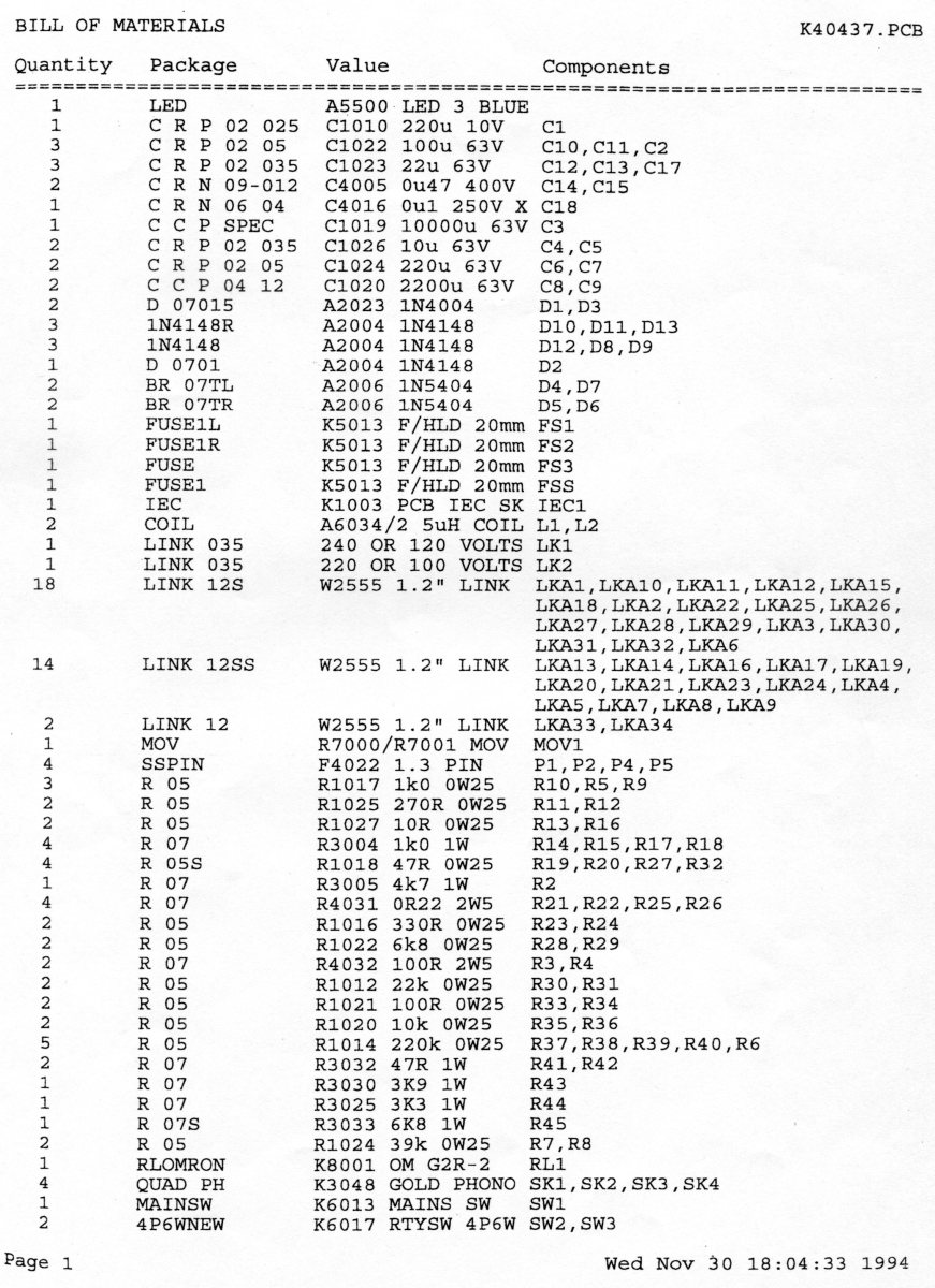

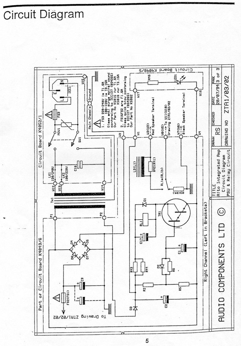

Thank you for the diagram. Strangely, my circuit-board is a bit older (labeled KA043/9, not KA043/7). Purchased around 1995... And the procedure does not seem to be the same. Would you have this newer service information, please?

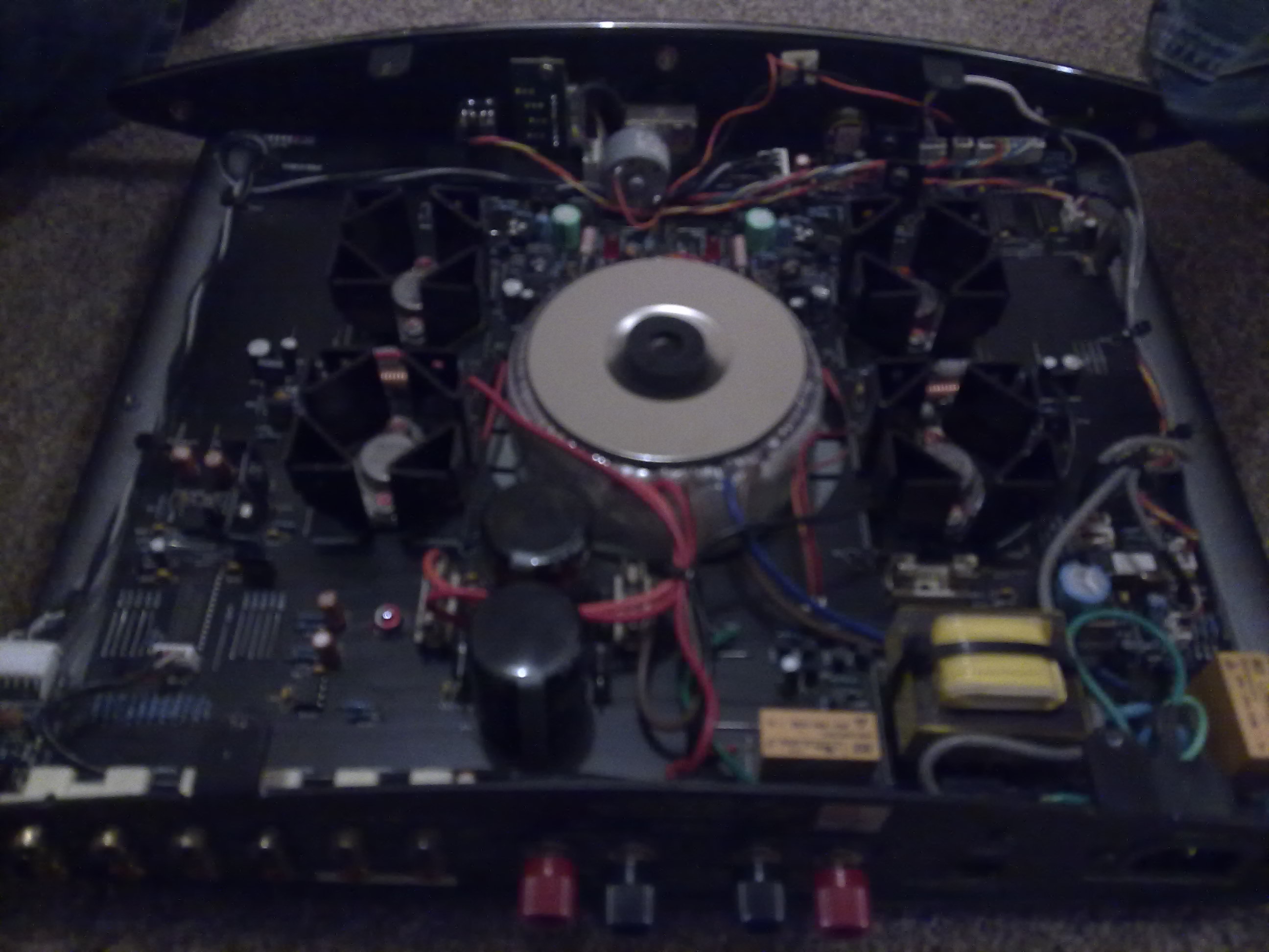

Going through the schematics, I do have 60V on the fuses FS1 and FS2.
I do measure 30V at R21-R22-R25-R26. (Alto4picture).

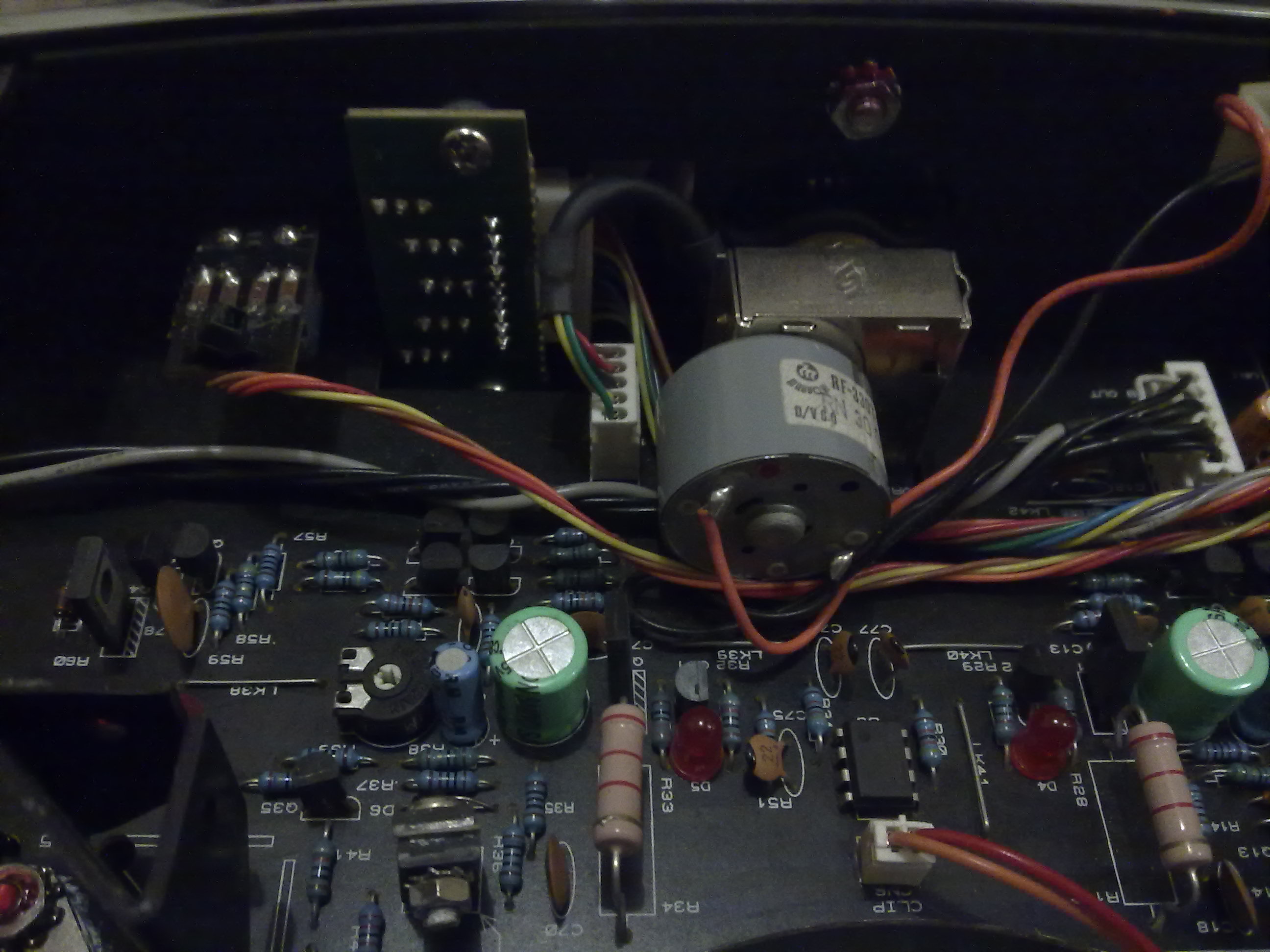

Then the part that confuses me, at both W11 and W18 (or W8 and W5 at Alto5picture) I do not measure anything, that is after the 2 capacitors C8 and C9. Is there supposed to be a DC voltage there (so close to the speaker connections)? Also no DC voltage at R3 - R4.
It all leads to the little delay switch RL1a-RL1b an Omron G2R-2 24VDC that does not do anything... or would the capacitors C8 and C9 still be suspicious? (both both at the same time is weird).

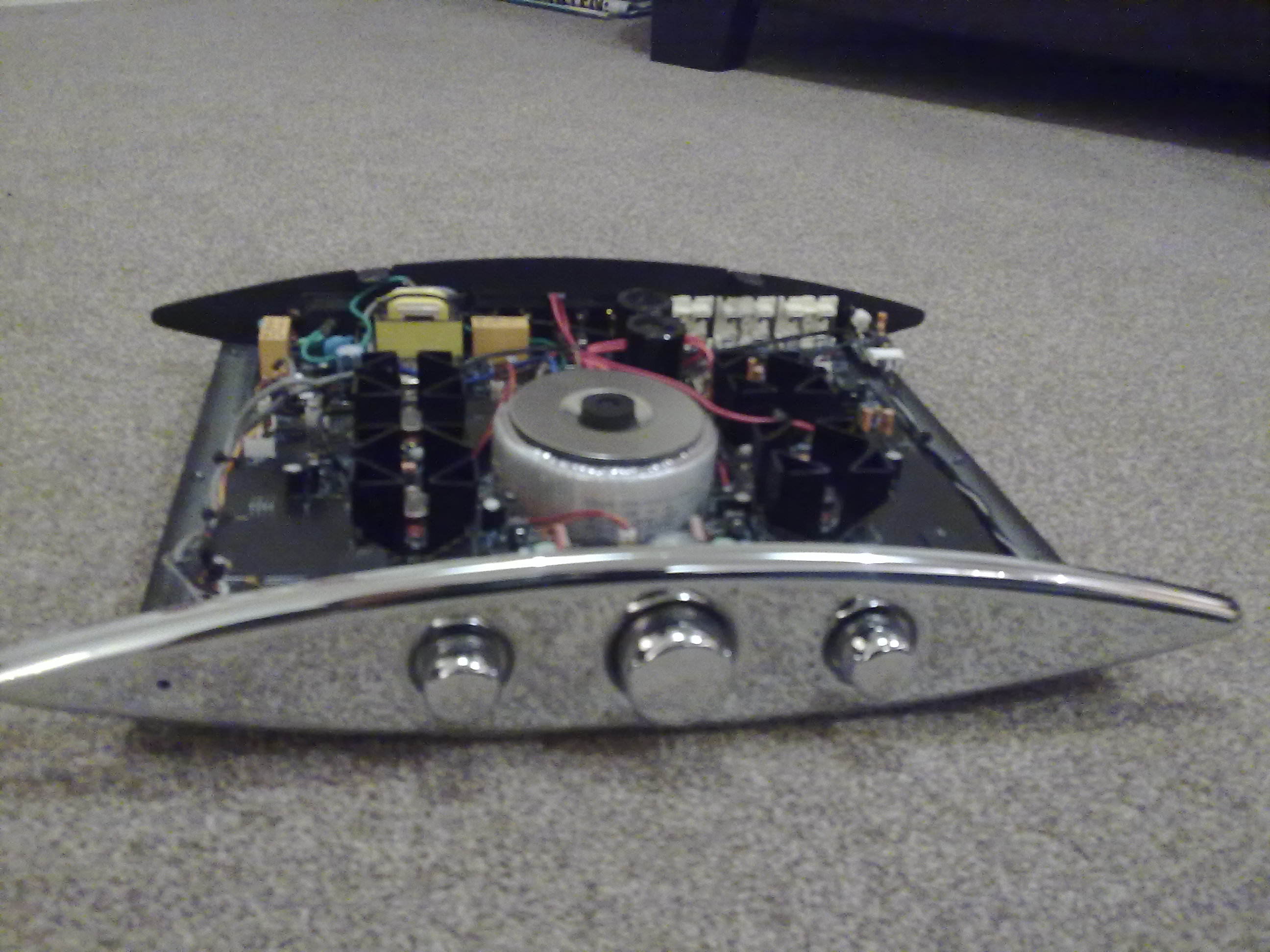

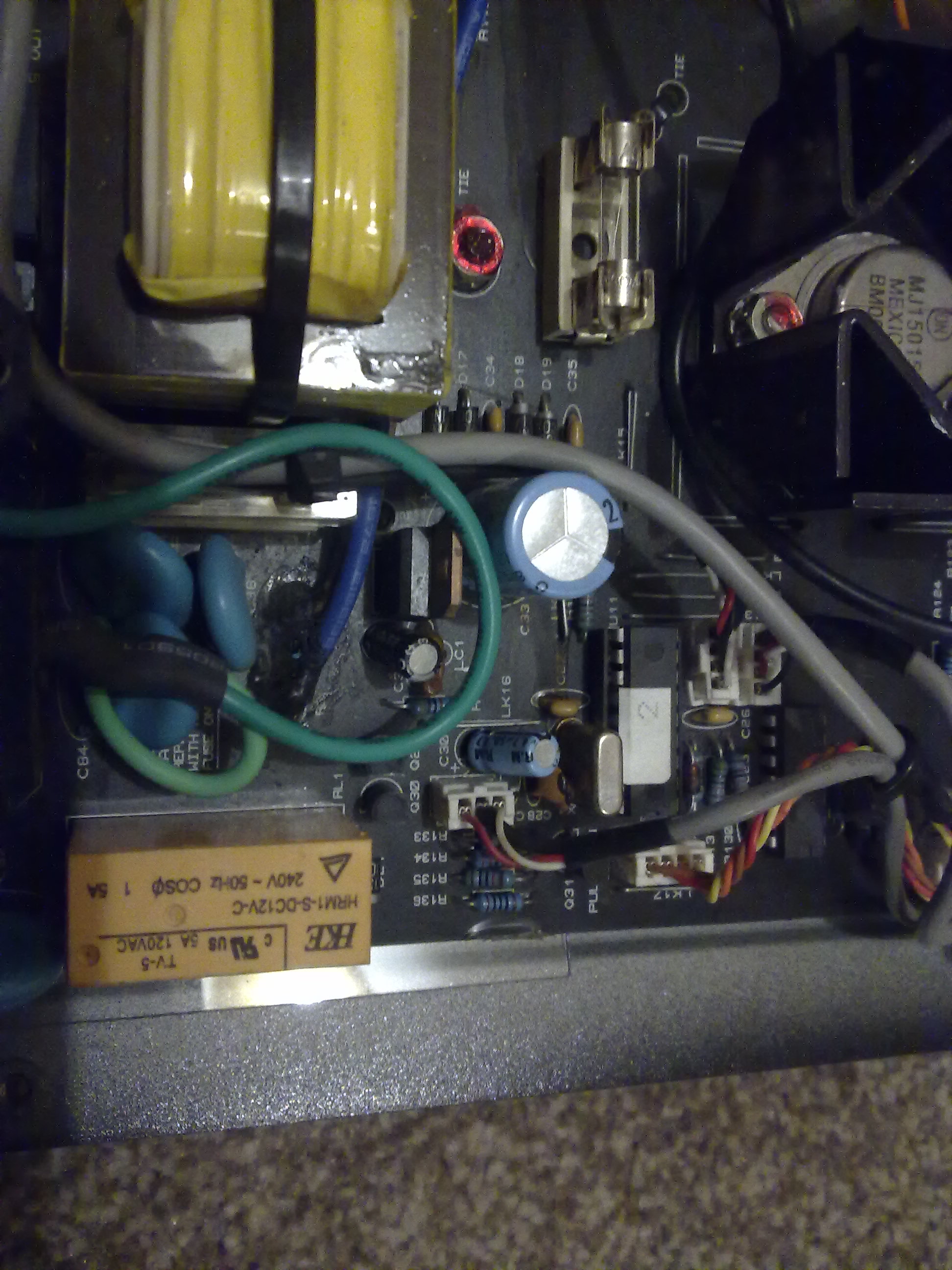

A little info that may help Alto owners.. I found an Alto and matching cd/ tuner at a local garage sale. it is the chrome version . I assume it is the later version . After removing the cover to do an inspection before powering up i noticed This amp to be totally diffrent to the one that is spoken about in this thread.. It has a sub out connection and the amplifier is a complimentary dual rail design with no output capacitor . it also uses 15000uF per rail. I was disapointed at first as i really wanted to have a listen to a single ended version. The sound of this little wonder as far as my ears can tell matches the original write ups apart from the bass is not lacking in this version.. Will remove cover and take some piccys if anyone is intrested..
regards Mark
Ps this version is also remote control and uses logic to switch inputs and motorised pot for volume control.Did find some info on the web stating it was simler to denon a500 topology but that is a quasi complimentary amplifier

thanks ultraprime .. I agree with the tuner not being too bad at all.. Im still not conviced about the amplifier being simler to the cambridge a500 the amplifier uses dual rail psu but is quasi complimentary . the later alto is fully complimentary... As for the ealier version being class A i dont think so it was based on a lynsley hood class a design but it is biased A/B .. The heatsinks are very small so deff not class A.. Now got pictures of unternals of the amplifier .. Will have to get a data cable as the bluetooth on my phone is duff
A few piccys of the AM1.

The specs i have found say it does 50W Rms 8 Ohms.. I guess if pushed it would also get a little on the warm side.. I would like to compare aswell.Im glad the only thing i needed to do to this amplifier was to re dress and solder a three core ribbon cable to the led that reside in the volume control knob. any repairs to the amplifier would require totall srip down to gain acces to underside of the PCB. The cd/tuner i aquired along with the amplifier just needed the laser cleaning and a new belt for the draw.. All in all not a bad find
