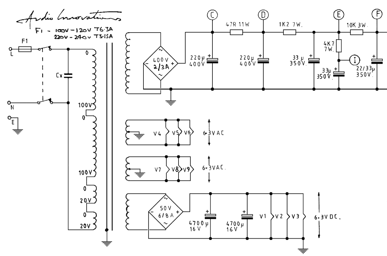

Hi, Anyone has the power supply diagram with main trans connection (showing the wire color) connected to where?
Bought an unit and the main trans connection mixed up so I am trying to get it right to the original connection.
Appreciate anyone help.
Thank you.
I found my old drawings from 1989, when we built them;
The colour codes will be near it but not a problem with a decent meter to check the resistances of the windings. They are not phase sensitive.
