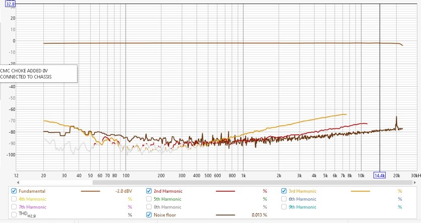

Audio Grade SMPS
Screenshot of KSA50 output into 7.5r at10v (through 20db attenuator)
Only the spike at 20Khz is unusual otherwise noise overall inc power supply shows nothing of note.

Wel if it measures good, it must be good. The new generation hifi people i guess :sad:
It has much more chances to be good. And in majority of cases it is true.
