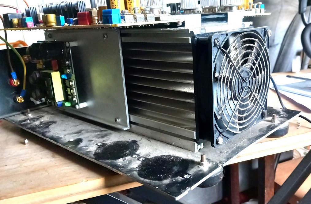

I have so far installed one for the right channel into my Krell KSA50 clone and am very happy with the results.
The auxilliary + - 12v output supplies the speaker protector and 4" 3 speed fan.
At +- 36v @ 2amps per rail, the SMPS mosfets are slighly warm - 50C

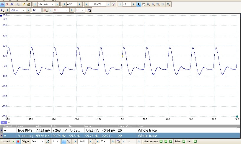

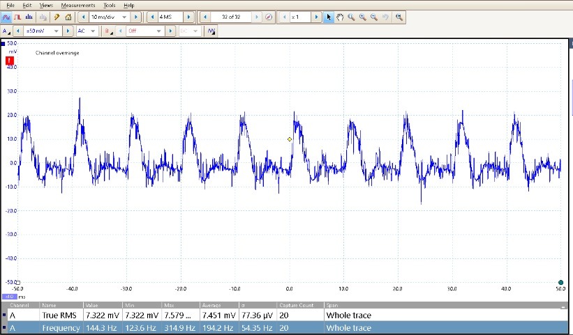

I'll post REW screenshots later but the noise spectrum of the amp does not show anything unwaanted.
