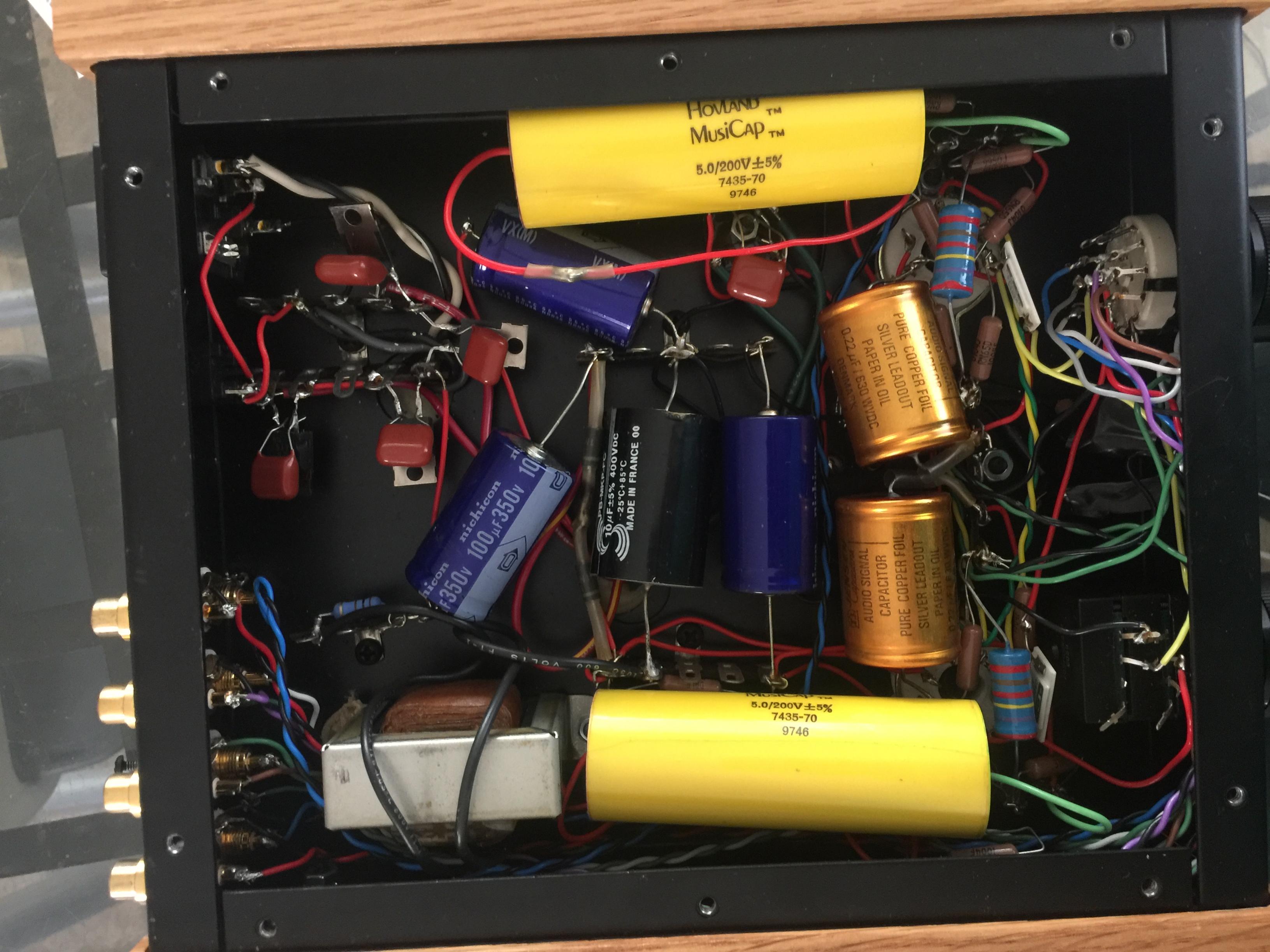

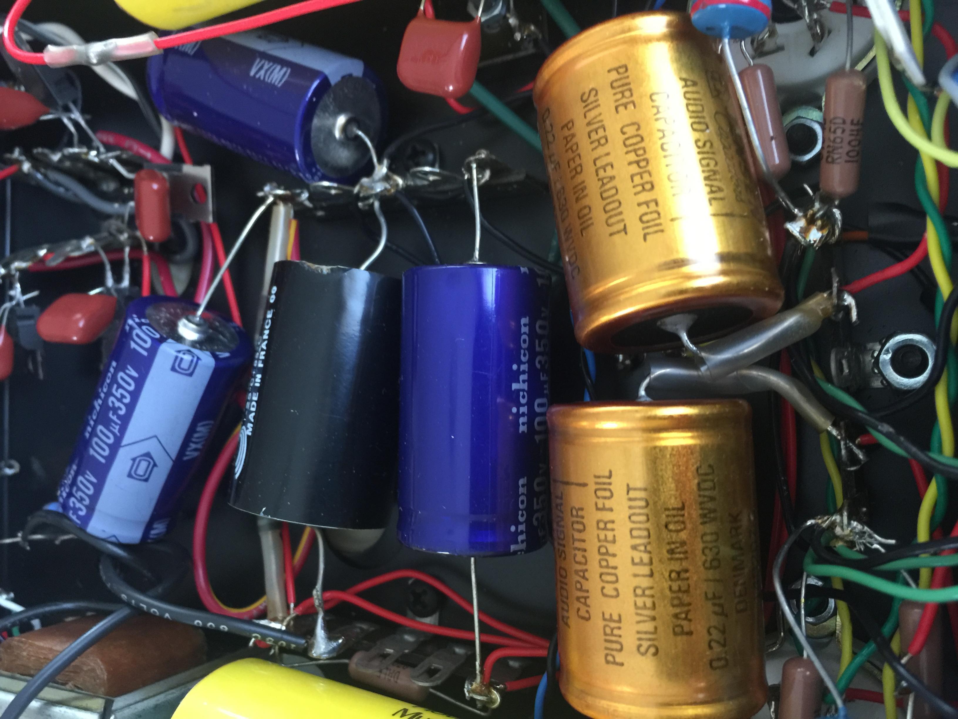

I took some time to open up the preamp again and take two more pictures. One of the things I see right off the bat is that coupling caps are 5uF, which is obviously much larger than the 1uF on the schematic. Besides a possible improvement on lowend performance, are there any downsides to having this cap in there?
I also took my fluke DMM to measure AC on the output and ended up with 1.3-1.4mV of hum. I would love to get this down to a much lower level, would .1 -.5mV. From reading the recommendations on here it sounds like I should start with replacing the power supply caps. While I am replacing them, I would think it would be worthwhile increasing their size as well, as I am using SS rectification. Are there any potential downsides to me upgrading the caps from 100uF/350V to 150uF or possible 200uF, outside of having room to fit them?
I measured about 1mV of AC on the filaments. Looking at the schematic, would it be worthwhile for me to add another RC to the filter? Would I see an improvement with another regulator in there or is that reaching a point of very diminishing returns here?

The power supply without the Zeners sims as 2mV-3mV ripple to the buffer stage, much less to the gain stage. If you have 1.3mV on the output, then the supply ripple must be much greater than the design implies.
I'd replace the main caps. They are maybe "only middle-aged", but some of us get wobbly about that time. The stock values should be ample; I predict the old ones give much less uFd than they did when new.
I agree, replace the filter caps. They tend to be a weak point even in the higher priced Cary gear.
You can also make an improvement in sound quality by removing the 0.22ufd caps and the grid resistor on the cathode follower and direct couple the cathode follower to the first tube. You could also reduce some noise by moving the cathode follower's power feed to after the resistor that feeds the input tube.
One more thing, the 5ufd cap is probably too large.
ok I am about to order some new caps. I didn't quite find what I wanted from Nichicon so I am going to try Jenson (I was also considering F&T). I still have to double check the dimensions but I think they should fit in the same place as the old caps.
While I am at it, is the 5uF cap really that big of an issue? Wouldn't such a large cap just lower the f3 of the response curve, or could the circuit be negatively affected in some other way? I am happy with the sound of the preamp at this point so I would really only want to change them if I had to.

Looking at the build layout, I'm thinking you have induced hum problems. The filter choke is right next to the input wiring, there is a signal lead from a cap right on top of the rectifiers, and that's only a quick look. Are any of the signal wires shielded?
No the cables aren't shielded and they do run close to the choke. The idea did cross my mind that replacing those wires may be of value. I guess what I am looking for is if there might be some deficiency design wise and it sounds like there isn't. Maybe everything is down to layout and the limits of what is possible here.
