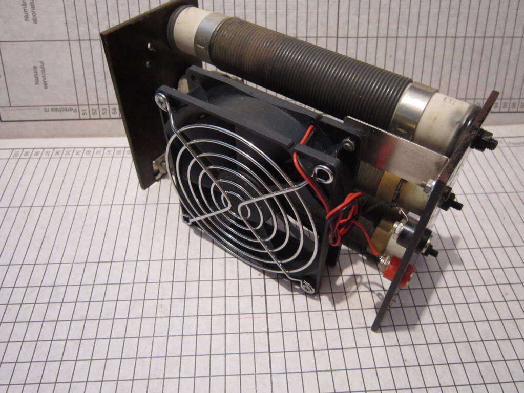

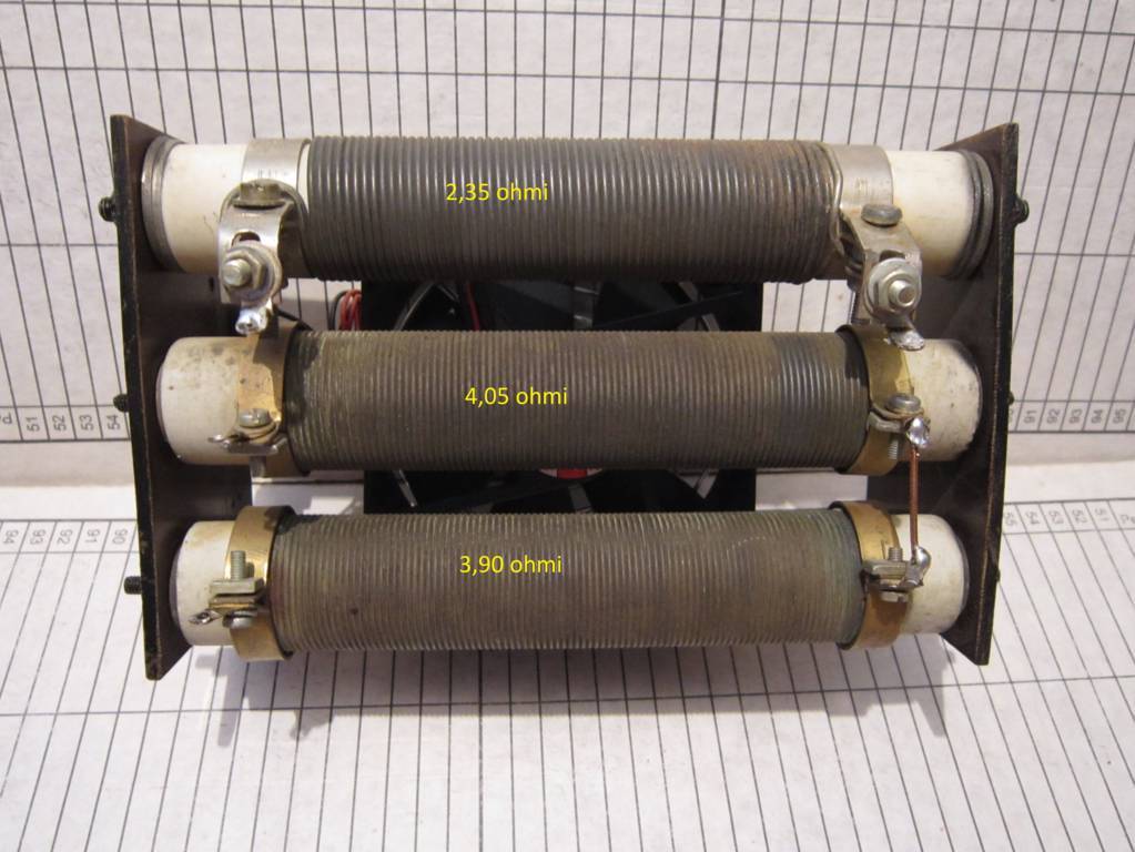

Greetings to all!
I use these resistors for audio tests:
All the best!

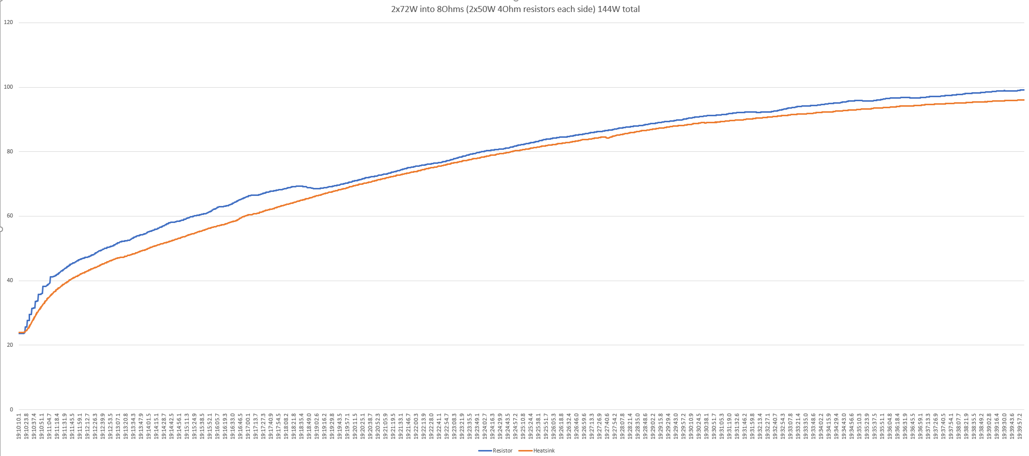

Finished it, gets a bit hot if 144W put through it tho. I will when I get time drill a 50mm hole both sides, metal grid one side and fan the other, albeit they only seem to go upto 70C... Seem to be more choices of 40mm fans... any fan recommendations....
Getting inside a bit cooler would help, my cable is only rated at 80C, and the PETG facia plate starts going soft at 85C....
You can see this is at 100C after 30 minutes
On the good part, I'll never be using it at those wattages....
But as you can see it is just getting hotter. I'll see what blowing air over it does as well,

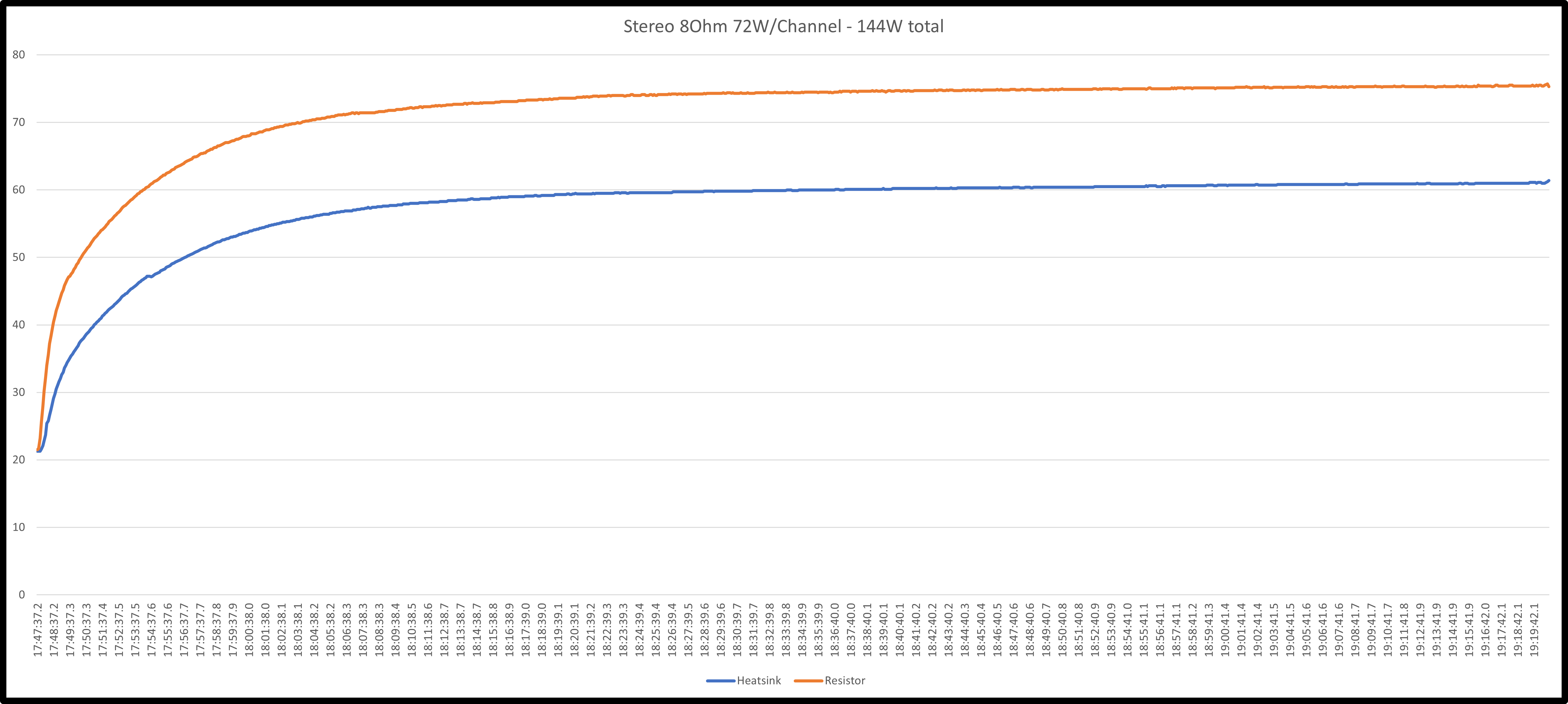

Well it looks like the 40mmx40mm fans are the way to go, many more on the market. ARX seem to make high temperature ones with ceramic spindles and bearings. They seem to be tested up to 80C for 500 hours. They also do one that is tested at 120C for 500 hours. (ball bearting)
Just having a fan blowing over the heatsink seems to make a massive difference.

Blow some air over it...🙂

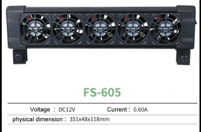

There are aquarium fans that would be suitable, 5 fans in a row that would look neat...
I just used a Solder fume extractor for testing.
