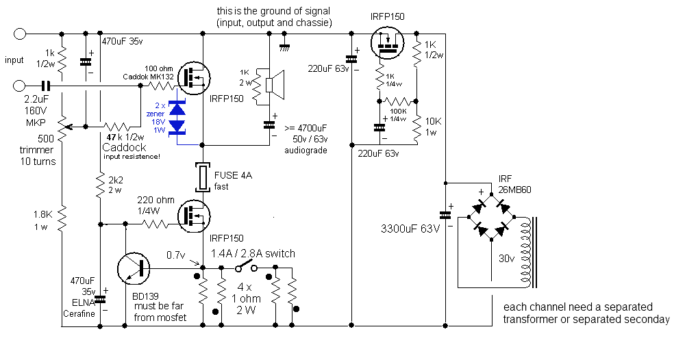

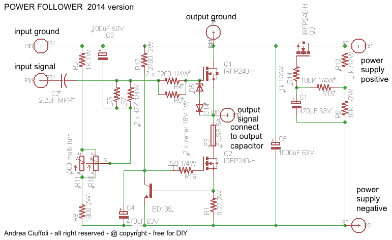

I have some questions about the Andrea Ciuffoli 2014 Power Follower.
The new 2014 schematic and 2014 board do not include the output cap.
Is the output section built the same way as the older schematic?
I assume the positive speaker connection, if built like the '99 version, connects to the positive side of the output cap. This correct?
Is the 1k resistor needed across the speaker on the 2014 version
The 2014 schematic shows R10 and R11. Are both needed?

Is the output section built the same way as the older schematic? Yes, but no provision to alter bias.
I assume the positive speaker connection, if built like the '99 version, connects to the positive side of the output cap. This correct? Depends on what you want. I think there should be no problem to connect Negative polarity of speaker to positive leg of output cap if you prefer negative H2 phase.
Is the 1k resistor needed across the speaker on the 2014 version. Yes, to avoid unwanted dc potential build up on output terminal due to output capacitor.

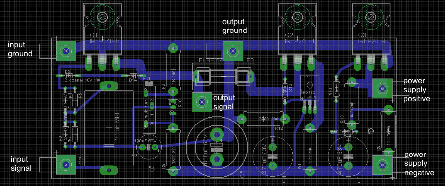

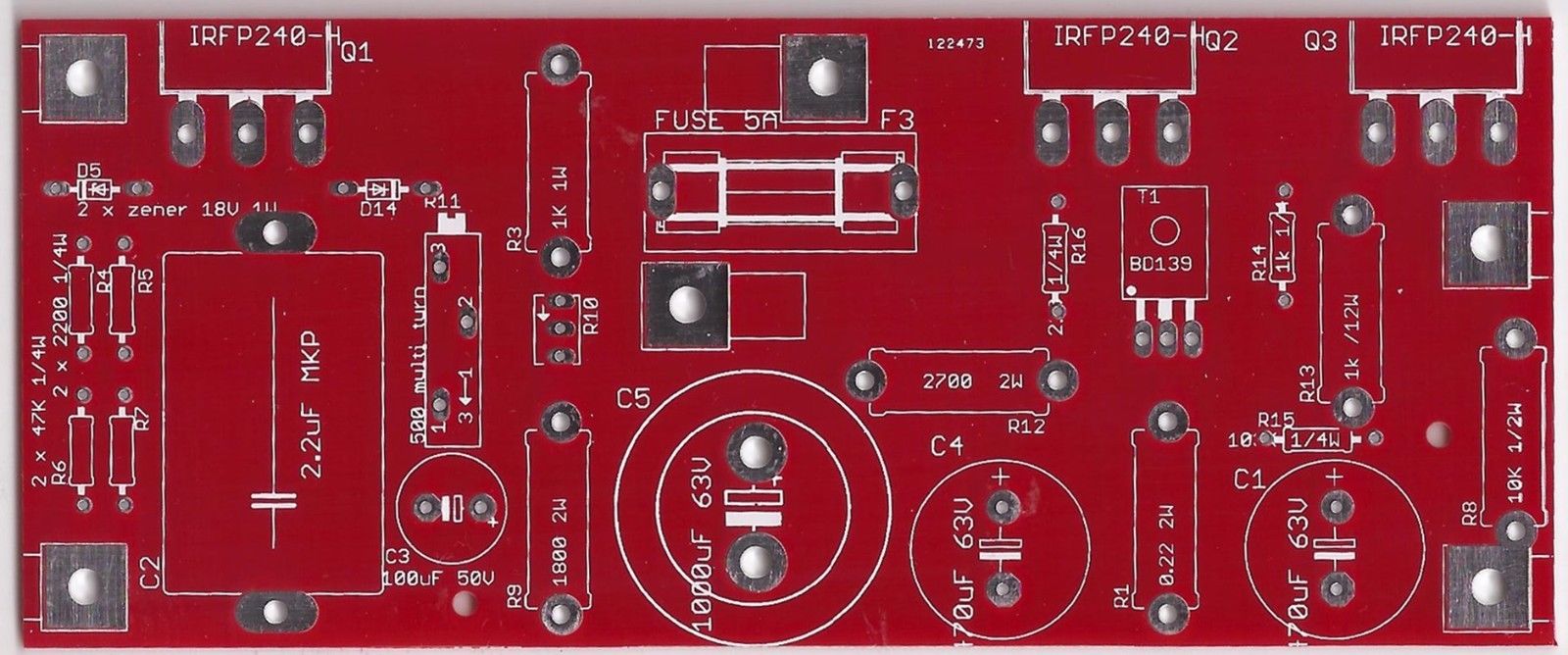

The 2014 schematic shows R10 and R11. Are both needed? No, choose one.
too much
two trimpots on schematic - just provison to mount two different physical styles - see pcb - mount one you prefer to fiddle with
resistor across speaker is bleeder - to drain outout cap and prevent plop! when connecting speaker
output node is at negative potential , ref. to gnd , so output cap must have negative pole at output node , positive to speaker

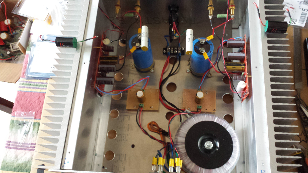

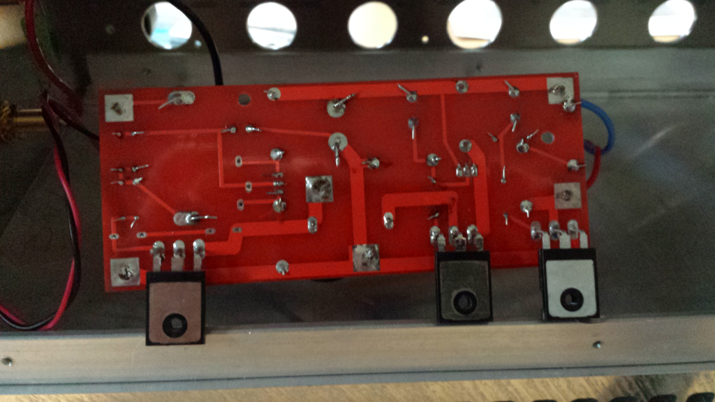

I had a chassis and 30v 8A transformer from my failed attempt at a 25w Schade feedback amp. The PF 2014 amp can run from the same voltage, so I built it and after some troubleshooting with the designer Andrea Ciuffoli (found a bad BD139 bjt) its up and running.
I built it just to hear it, to try something different in the power follower vein.
Its as fine amp in it's own right. It's very quiet and dynamic as well.
Think I will keep this amp for a while.
