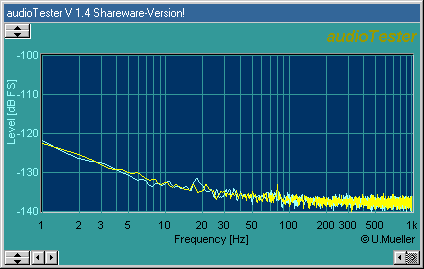

Attached the noise performance of the AD part of my audio card at no input for both channels (8 kHz sample rate). You will clearly see 1/f noise. This is something you cannot avoid due to the properties of semiconductors. The PM1704 is not different.
