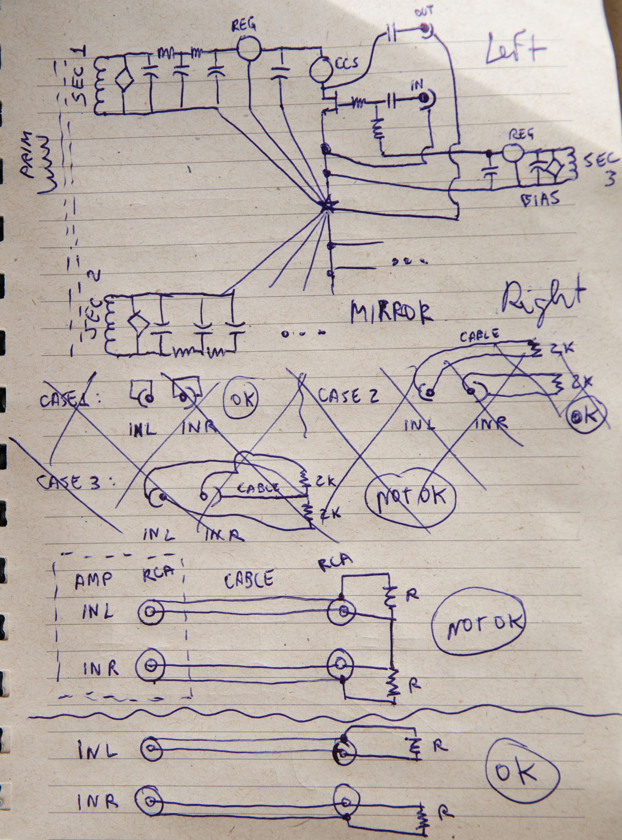

Help with hum
My SE amp (L' Amp - http://www.diyaudio.com/forums/diyaudio-com-articles/200460-l-amp-simple-sit-amp-part-1-a.html) was done with star-grounding. Transformer has 2 secondaries, so I've built 2 PSU (1 for left and 1 for right). Their ground go to star. RCA shield from each channel input and its bias ground go to local references (source of FET).
- With inputs shorted, the amp is super silent (mute).
- With open inputs, almost mute.
- With RCA cable + open ends, almost mute.
- With RCA cable + 2k resistor in each end, mute.
- If the resistors at RCA end (left and right) share the same "ground", audible hum is generated. This occurs with any source connected to the amp (CD player, DAC, etc) because their RCA shields are connected to ground.
Where is my error?
Obs.: I tried loop breaker to star point, earth to star, no earth, all without success.
