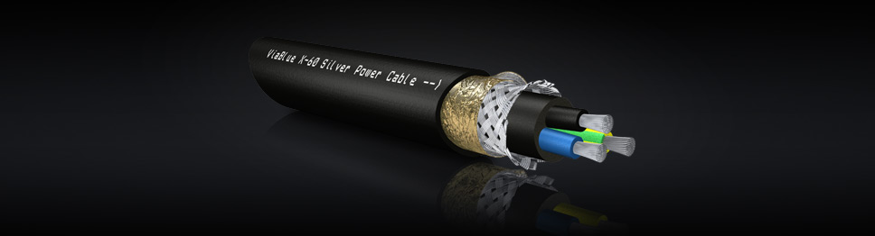

an outer conductive layer that is unconnected does nothing except increase the cost of the cable....anyway, if a long lead IS insulated from EMI/RFI does it always need to be earthed/grounded?
For example: My mains cables have 2 insulators, a braid that is earthed to the plug terminal, either at one end or both, but it also has a kind of copper foil running the full length of the cable which IS NOT earthed at either end (manufactured product, not created by me).
For a screen/shield to be effective it needs to be connected to the enclosure or to a low impedance reference point.
The interference has to be given an alternative route rather than imposing itself on the signal conductor.
Stray inductance and parasitic inductance are the same thing. Mu-metal is only used when a magnetic-field-sensitive component (e.g. input transformer) has to be shielded from magnetic fields. It is not very effective when put around the source of those fields as mu-metal saturates at quite low field strengths.thedoc735 said:Please pardon me but you were talking about stray capacitance, but now you say stray inductance, not parasitic inductance in relation to the use of mu-metal? Confused now? Sorry!
Insulation does not prevent EMI/RFI. However, you may have been using 'insulated' in the more general meaning of 'isolated' or 'protected'; earthing/grounding may be part of the method of protecting it, or it may not - depends on type of cable and context...anyway, if a long lead IS insulated from EMI/RFI does it always need to be earthed/grounded?
Mains cables do not need shielding. It is not possible to answer technical questions based on false premises.For example: My mains cables have 2 insulators, a braid that is earthed to the plug terminal, either at one end or both, but it also has a kind of copper foil running the full length of the cable which IS NOT earthed at either end (manufactured product, not created by me).

"Insulation does not prevent EMI/RFI". However, there are dozens of people selling copper EMI/RFI shielding tape on ebay! (stating that it does).
"Mains cables do not need shielding". However there are many double shielded mains cables for sale just like the viablue x-25?
BTW: even a text book is secondhand knowledge which I have been force fed and 'groomed' by the author (brainwashed) into his way of thinking! In as much as; I have not learned, realised, experienced, experimented, discovered (myself) firsthand, but replied upon the experience of the author which we presume to be correct and accurate! Having said that, in my life time I HAVE found errors in textbooks! I used to highlight them and put them back on the shelf in the library! Not all text books therefore are the last word and testament on any given subject! Do you concur? 😎
No, I used two phrases which mean the same thing. You used a phrase which means nothing. Can you understand the difference between a synonym and meaninglessness?thedoc735 said:you see what I mean exact wording doesn't matter: "Stray inductance and parasitic inductance are the same thing."
Copper is not an insulator!! Do you understand the meaning of any of the words you use?"Insulation does not prevent EMI/RFI". However, there are dozens of people selling copper EMI/RFI shielding tape on ebay! (stating that it does).
And doubtless there are lots of ignorant people to buy such useless items. At best they simply do what any mains cable does: get power safely to the equipment. At worst they either increase RFI (some have an ungrounded 'shield') or introduce electrical safety hazards."Mains cables do not need shielding". However there are many double shielded mains cables for sale just like the viablue x-25?
