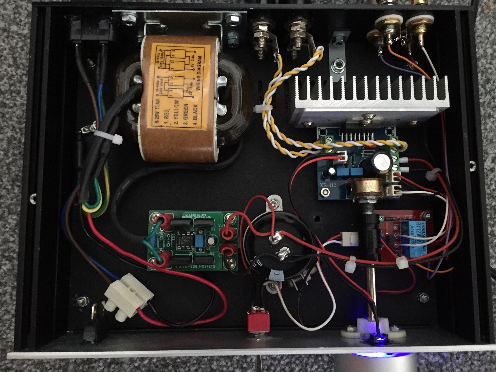

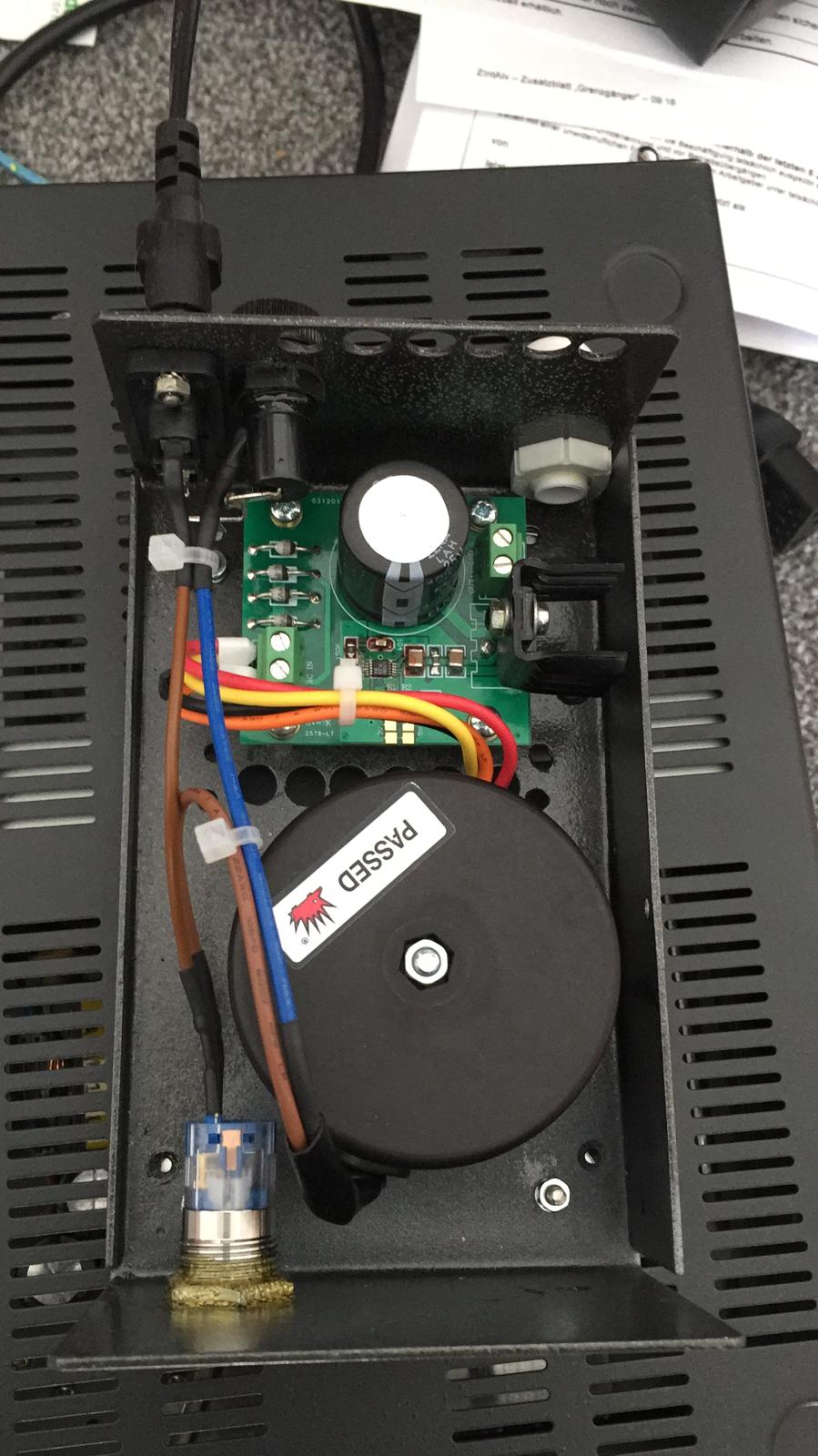

"Working" from home since March, I finally populated the Leach Amp boards I bought over a year ago...
These boards will replace the Marantz 1200 boards that I've soldered and desoldered 10,000 x's.

mkane77g,
Congratulations on your successful build! 🙂
That is a different take on the chassis with the the sinks acting as the "top". Was this driven by aesthetic reasons or it's an effort to lower the height so that it will fit in a particular spot?
What height did you end up with?
mkane77g,
Just wanted to use a box I had on hand. heatsinks sort of fit so I used it.
Height is 4 -1/2". Heatsinks hover right around 53° C.
